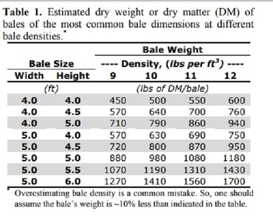

I have a co-worker shopping for a used hydro 4X4 tractor loader in the 40 to 50 hp range. His major concern is that it be able to handle 1000 lb +/- bales of hay for feeding his livestock. I am not aware of dry hay, either round or square exceeding the 1 k limit, with most that I have scaled being roughly 900. Your experiences may differ. He is not leaning towards anything specific, red, orange, green, or blue, but I, of course, lean red,blue (CIH). Have seen a couple of TC 40/45s, DX40/45s available and am wondering if those members with experience with those models might weigh-in on bale handling capacity. Thanks from both of us for the input and replies.

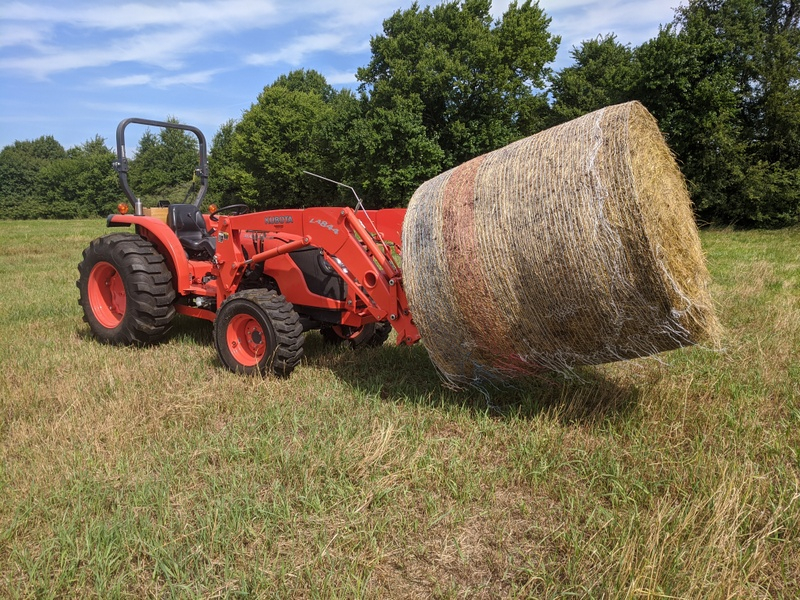

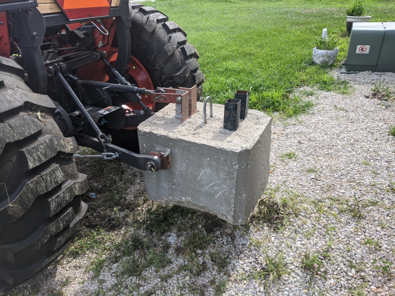

I can easily pick up a 5x6 with a proper ballast. My need is very occasional. I pick bale up with a 2 in 1 pallet fork that has bale spear that I can take off and put back on very easily. Like others say I do it nice and slow and during transport I keep the bale as low as I can. On road I can go a bit faster but on farm ground have to go slow to my liking. I think for everyday use my setup is not the most optimal. My land is relatively flat. My rig is a Kubota MX-4700 and with a ballast and pallet fork weighs under 5000.

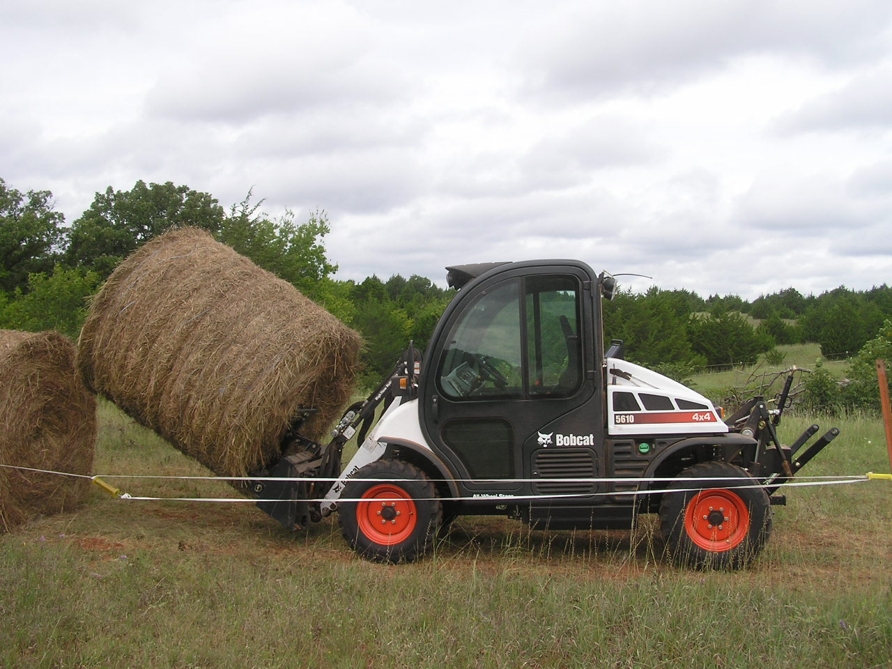

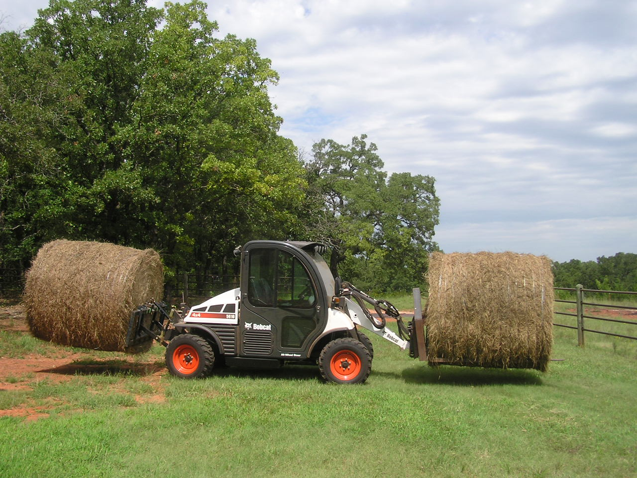

The Toolcat with one 1100 pound bale, no counterweight:
Or two:
