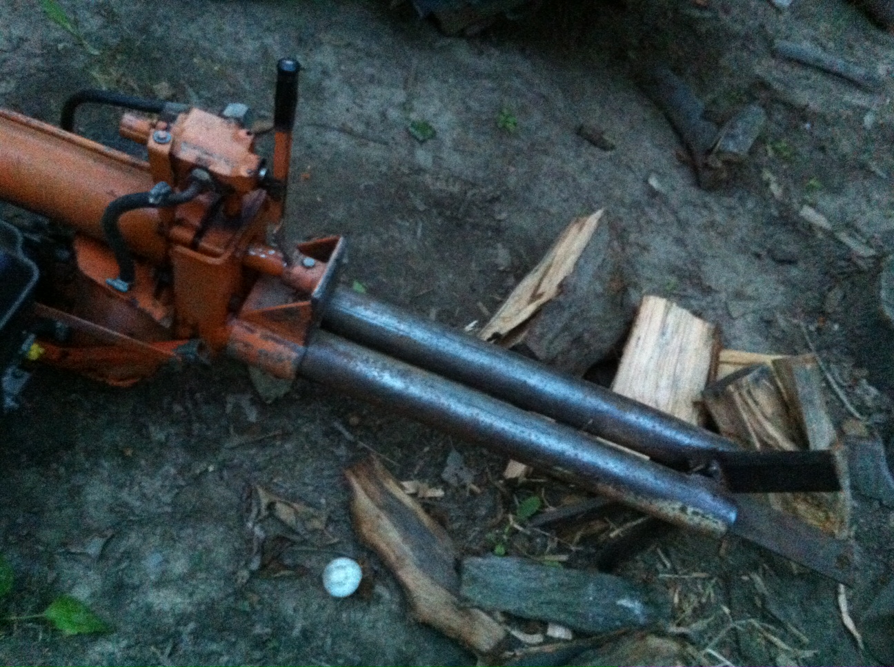

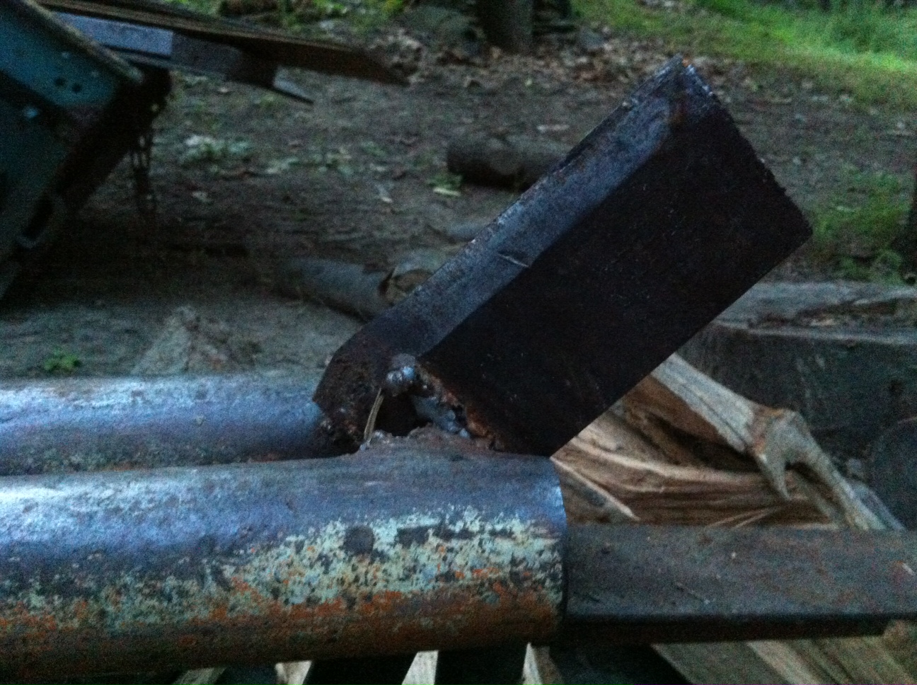

This is my pathetic little log splitter. The wedge which was poorly welded to the tubes broke free. I know there's no good way to weld it there, so I'm looking for suggestions on fixing it. Thanks!

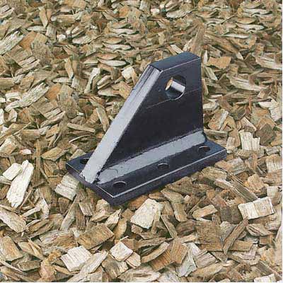

Northern tools sells a bolt on anchor block that can be welded. Not too expensive but you would need to modify your splitter a little to get it to fit. This will help support the wedge and transfer energy over a larger area. I would think that you may even be able to bot it on the flat bar below the tubes.
If you weld the existing one it will fail again- without a backing plate or extension on the back, it will put all the force on the small welded area
/ Please help me repair this #3
I would try to weld another 1/2-3/4" thick piece of plate or flat bar to the bottom of the wedge so it extends down below the two pipes and brace it on the bottom. The "extension" should be ground down to a deep "v" notch and welded to the wedge with a good many passes taking care not to overheat the wedge and make it loose the hard edge. Also weld between pipes just like the original and then lay a couple of 1/4-3/8 plates flat on the pipe and bump up against the wedge and weld on for some top strength . I would clean all the metal well with a wire wheel and use 7018 electrode for maximum strength.

Mount the wedge to the flat side of a piece of C-channel that fits over the sides of the tubes. Weld as much area as you can across and down the channel. Bevel the leading edge of the channel so it doesn't catch stuff.

Doesn't look like there was enough weld penetration between the wedge and tubes. If the tubes are up to the total force, then proper welding and placement of the wedge will work.

that could be reinforced with an angle piece going down from the(back of) wedge to another piece of flat steel reinforcment welded under the pipes. You may have to lengthin your tongue some. It's hard to explain, over a keyboard but that is, IMO, a fairly easy fix. I also agree with Hosspuller, just figured why not add some reinforcment while working on it.

you really just need gusset behind the wedge. I would also take that wedge out and weld it to a plate real good and then stick it up between tubes and weld plate to tubes on bottom. THEN you can reweld the wedge back to the tubes after removing the old welds. Add a gusset in back of wedge and call it good.

Just grind away the old welds and put the wedge back on with some reinforcement like a plate welded perpendicular across the bottom before sliding it back up into place and welding it there.
