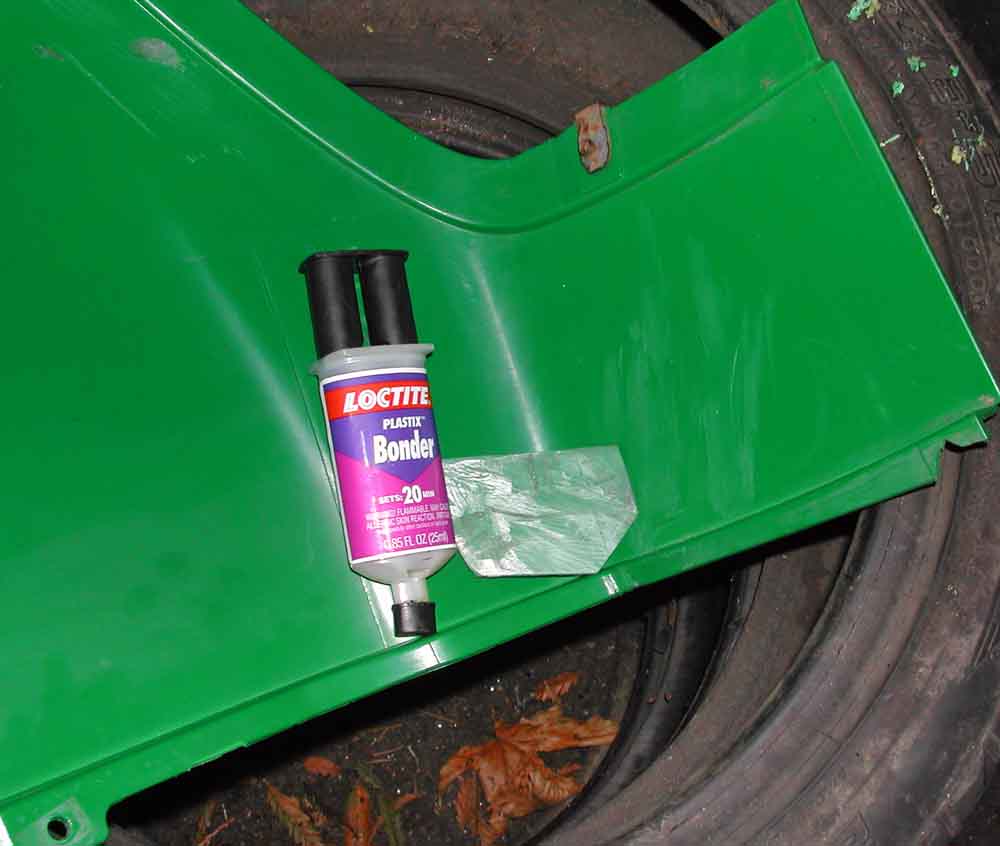

/ Plastic Fender repair #16
I have a right front fender on my JD Gator that need repairing.
This is not a weld, but it seems to work for the JD green resin. I wonder
if NH uses a similar chemistry for their plastic?
/ Plastic Fender repair #17
I may try that product and then weld on the backside. I think that should workout fine. Thanks, Ken Sweet
