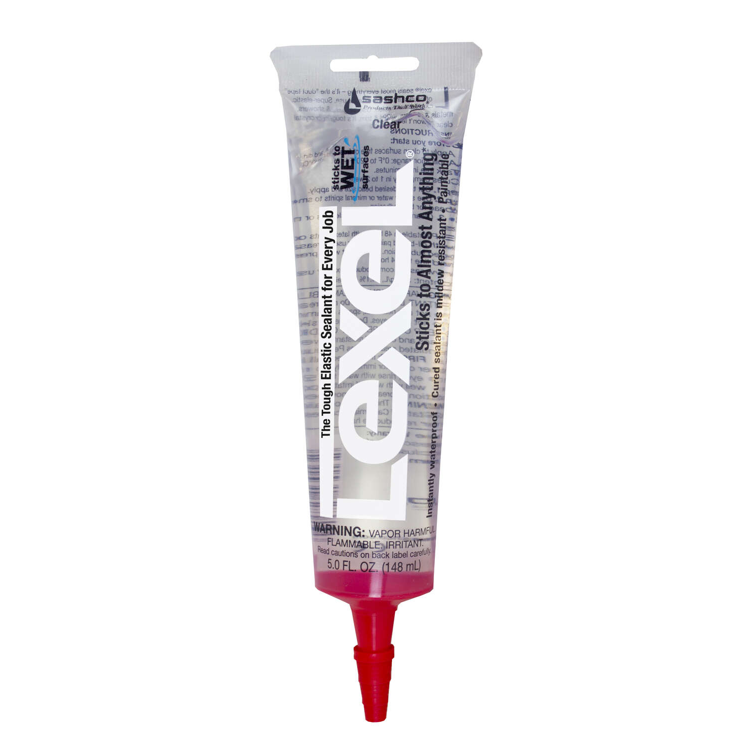

/ Rubbermaid Stock Tank Repair #9
Guess it depends on the crack. I have repaired many things (not a stock tank)with this stuff. It holds up pretty darn well !
