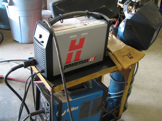

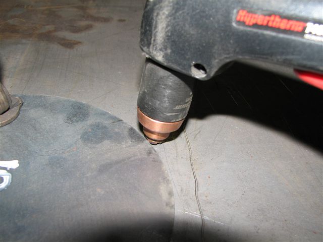

My Hypertherm Powermax45 operates on inlet air pressure of between 90 and 135 psi.....at 6 scfm. It is a good idea to drain your compressor tank daily....get rid of the water and also have some type of filter system to further reduce moisture and particulate. I can cut for days on one set of consumables......and can drag cut all the way to over 1".....as the Hypertherm has a shielded front end design that does not allow the nozzle (some call it a tip) to touch the workpiece.
Jim

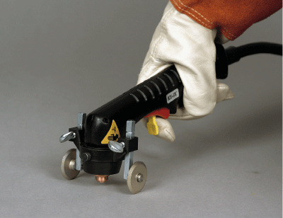

Those slats on the plasma cutting table are expendable. Just put new slats in when they get all cut up.
Do not cut directly on cement, as the heat of the plasma will cause the concrete to expand rapidly, popping out little chunks of concrete. Three to four in should be good enough.
There are many accessories for plasma cutters to cut circles, notch pipe, and cut off pipe. They have stand off tool to maintain a set distance above the cut. A drag tip does the same thing.
