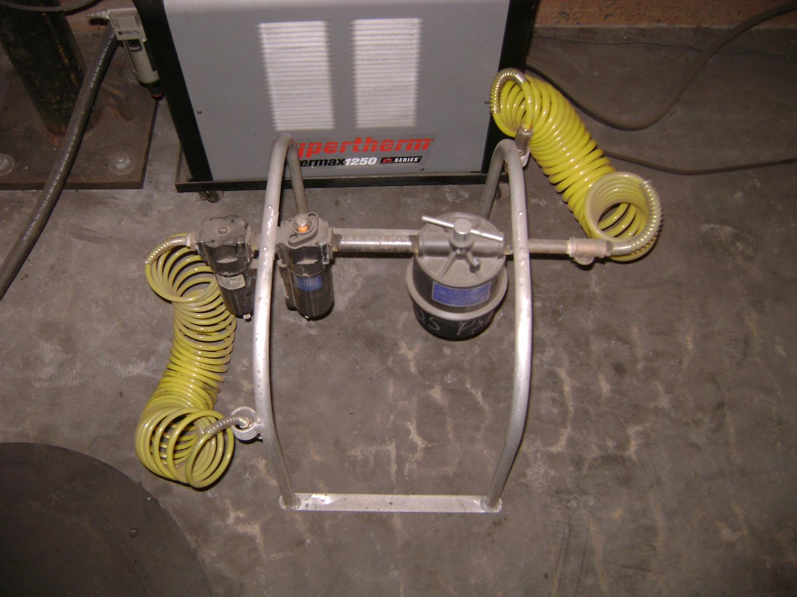

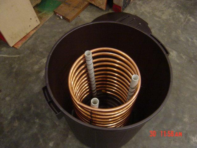

Congrats. I think you made a good decision with your brand choice. I have a 15+ y.o Hypertherm and I'm thinking about getting the new (updated) torch that is available for it. How do you put a price on being able to get part's 10-15 year old welders, or in my case, plas. cutter. I just did not want to turn your thread into another "Ford vs. Chevy" argument in my earlier post here. Use good dry air like they say! I have an inline dessicant thingy that's ok. SA has a nice homebrew air dryer and I'm sure he'd be happy to show you his IIRC "trashcan full of ice":thumbsup:

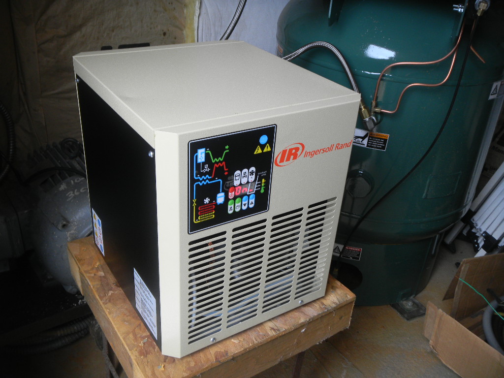

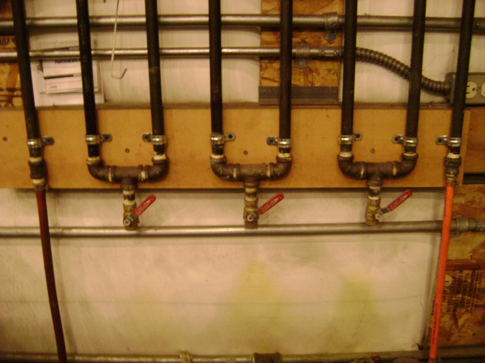

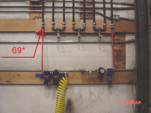

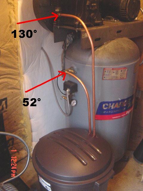

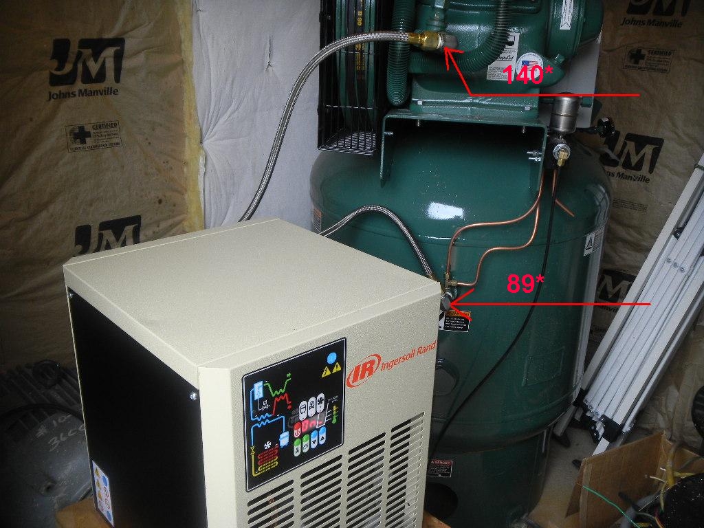

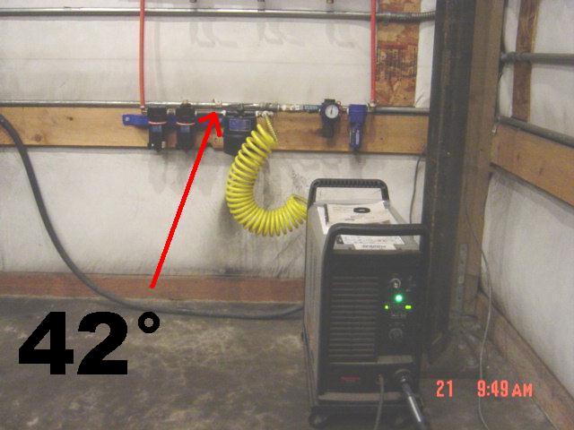

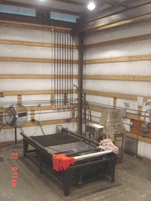

Here are some pictures of the air dryer I built. Couple years ago I upgraded to a refrigerated unit, and a new compressor. Believe it or not, the garbage can full of water drops the temperature of the air more so than the refrigerated unit! :rolleyes:

S.A, on your garbage can full of water you just come out of the comp. tank through the coil to the plas? Is room temp (say 80*) OK? You posted this for me a while ago and I was out of "roundtuit's":laughing: That's so dang simple I have no excuses not to put one together, especially if you don't need to worry about fresh cold water. (or do you).

SA, when you had the garbage can cooler, it looks like you just ran the cooled air into the receiver tank and let the moisture drain from there. Or, did I miss a drain from the copper coil in the garbage can?
I was wondering the same thing. I like cheap and simple vs expensive and complicated.:)

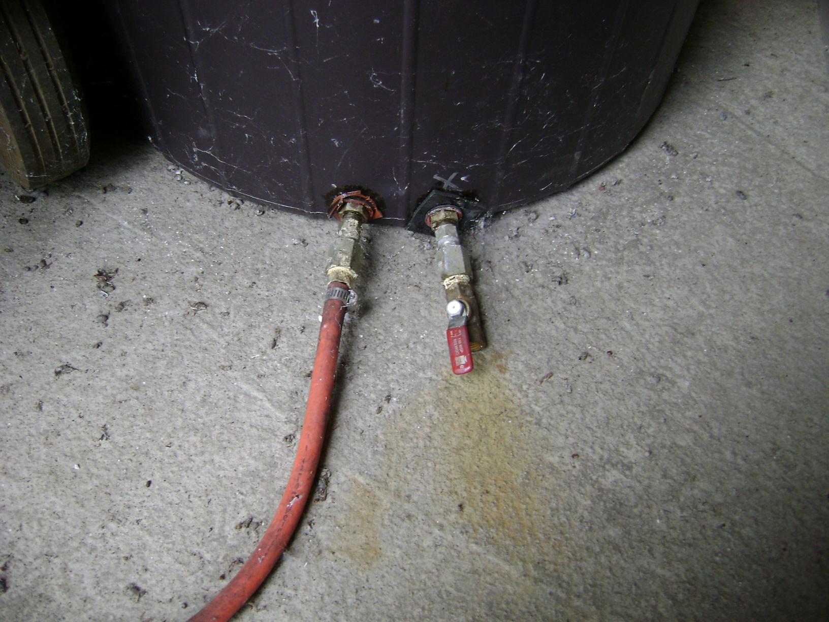

/ Plasma Questions #60
The air comes out of the compressor pump, through the copper coils. Back into the compressor's tank. Inside the shop, and through the black pipe after cooler hanging on the wall.
Yes there is a drain in the bottom on the copper coils, Bulk head fitting through the wall of the plastic garbage can. When I'm done for the day that drain is the first one opened. Then the compressor tank, then all the ball valves at the bottom of the after cooler.
Here in the North West just water works fine. Other regions you may have to drop a bag of ice in the garbage can. I also put some of that chemical they use in water beds in the water.
