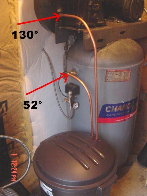

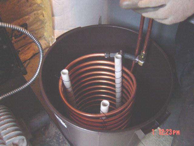

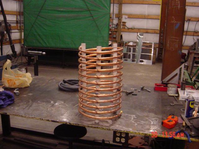

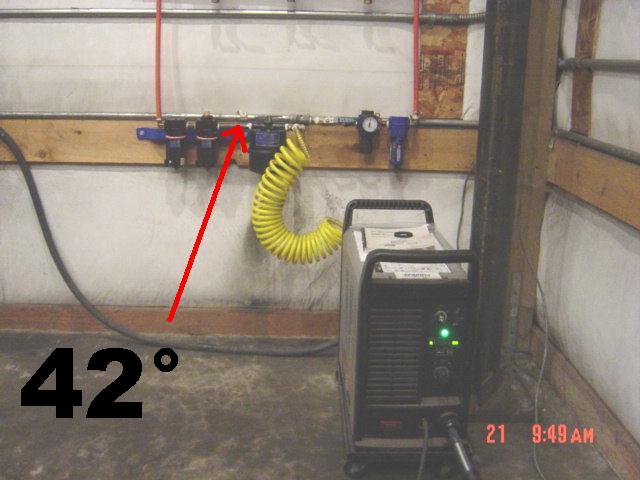

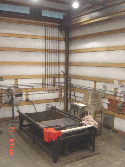

Shield Arc would you explain your dryer, that's my style (homemade)
It's very simple, you have to drop the temperature of the air. An engineer helped me with mine. Here in the North West just a garbage can full of water is good enough. Somewhere like Arizona you would need to add ice to the water. I've never got less that 250-feet of cutting (computer monitors the length of cuts) before seeing any change in the cut quality after building this dryer.

Shield Arc would you explain your dryer, that's my style (homemade). I just bought an in-line water filter by hyper therm, I think, and have not tried it yet, but not using dry air, consumables is an under statement. I thought that with an 80 gal tank & very little use, that is no painting & very little air tool use, I'd be ok with just tank draining. I avoid using the 'plas and grab the o/a torch for this high consumption of consumables.:laughing:
