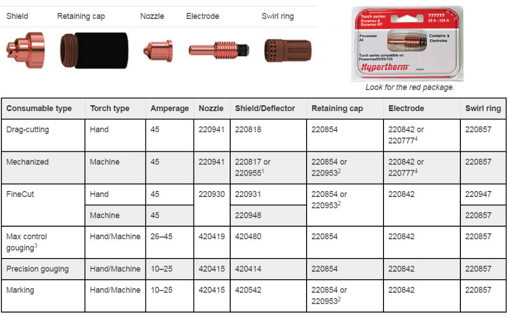

This is one of the consumable charts for HT air plasma. powermax45xp_consumables.jpeg

With Hypertherm and Miller you need the drag shield for drag cutting and that's all fine. Just an extra $12 part you need. With Thermal Dynamics/Victor you can drag cut with the actual tip or nozzle without a shield up to and including 60 amps. After that you need a drag shield too. If you try to drag a TD torch over 60 amps it automatically rolls back to 60 amps to protect the tip. Another reason to consider a plasma with a USA torch. Hypertherm made Miller torches for a long time ( ICE Torch ) That allowed Hypertherm to use Millers patented plug into any voltage or phase technology. Miller, Hyp or TD will give you a home grown designed and developed torch and machine. After all the Torch is the weak link to any plasma cutter. I think the best deal out there that has USA torch roots is the Thermal Dynamics/Victor Cut Master 42. 115/230 will cut 1/2". With a 4 year warranty. Takes 2 different torches. One only uses 2.6 cfm of air called Vent to Shield technology. You can get one new for around $900 and if you have a blown up plasma they will give you $10 per amp on trade in. ( No I don't work there ) anymore. One thing I used to call out Hypertherm on was I had a 3 yr and 3 month old Hyp 45 that blew up. They wouldn't stand behind it so I always told them that if I had bought a TD it would still have 9 months warranty left and fixed for free. I still vote Hypertherm if it can get into the budget but TD/Victor and Miller are right in there too.

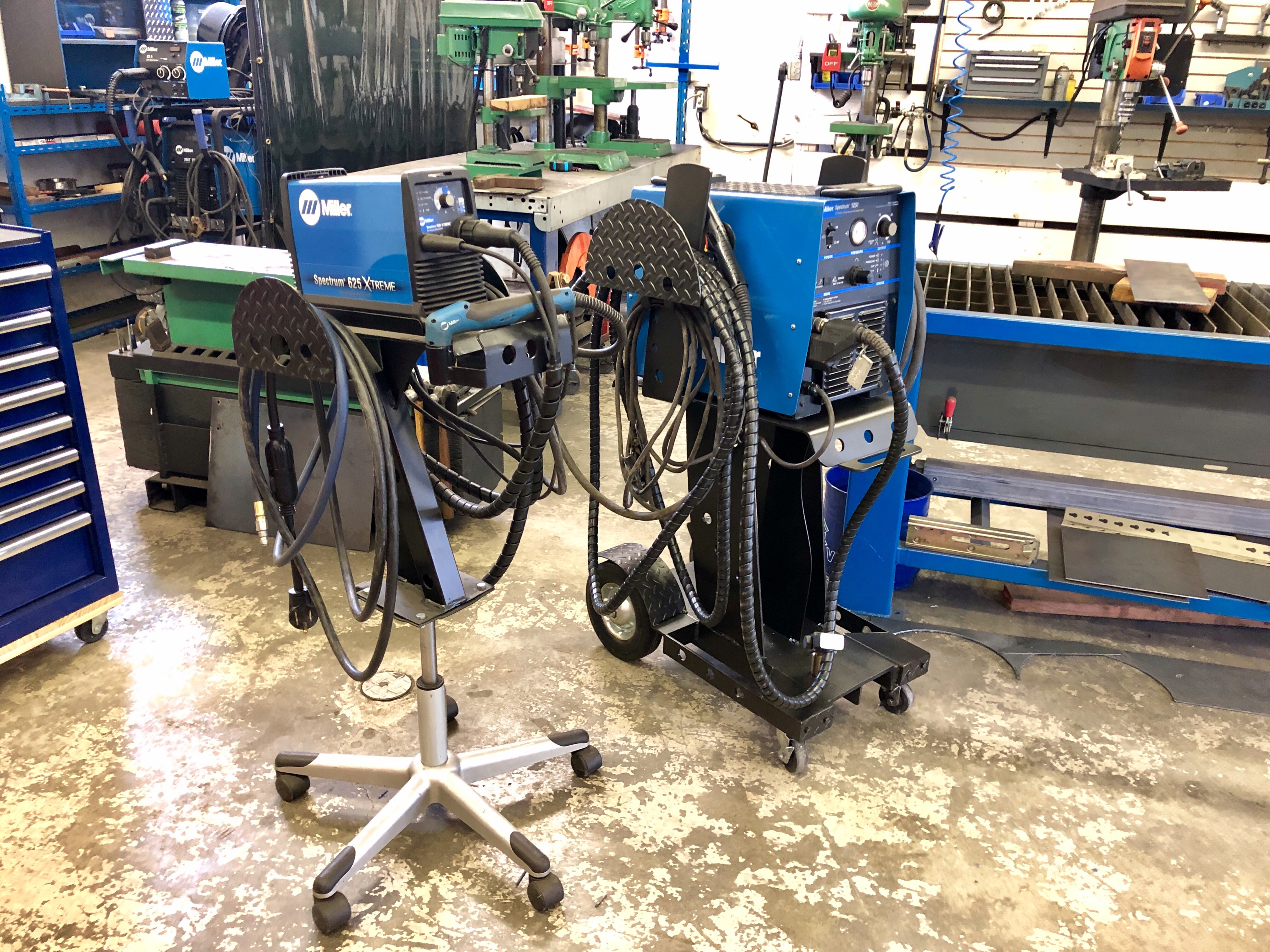

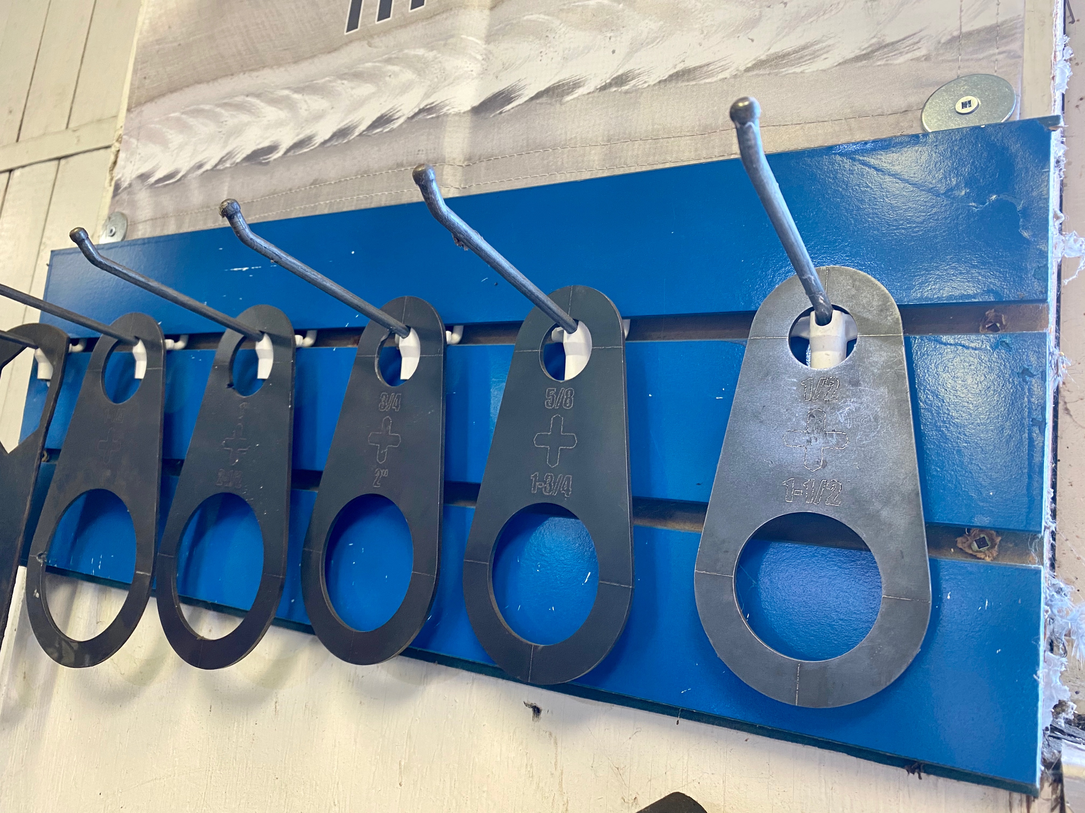

It didn’t too long for the Hypertherm 45 to pay for itself on my small farm shop. Got an extra coalescing filter cause in the south you have very wet air.
911motorsports. com templates save lots of time and give plasma table like performance. Their cutting table is great too and keep me and shop much cleaner.

Thanks for the tip on templates. Correction though, website is .net not .com Welcome to 911 Motorsports - .

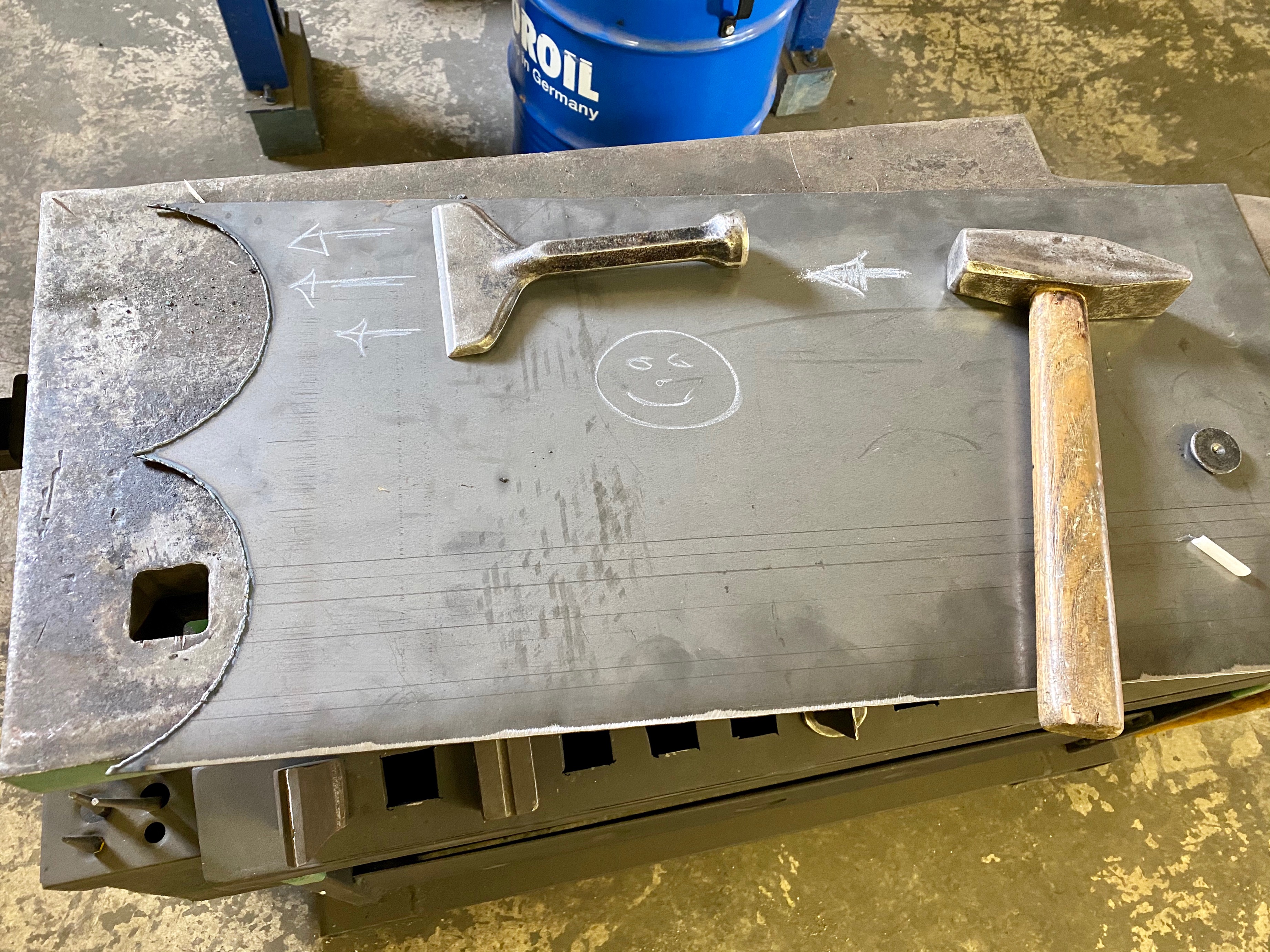

The difference between a drag shield plasma torch and a stand off torch is night and day. Surprised they still offer that old tech style anymore. I would not buy a plasma cutter without a drag shield especially for template work. Rarely cut freehand without a straight edge, speed square, template or circle guide. 1/2” and bigger holes are cut much quicker, easier and cheaper than drilling.
I can layout complex lines and make precision cut in seconds.
Everlast and Hypertherm are more than different than just price.
I find the dross hammer the perfect plasma cutter clean up tool.

What is that? Something you purchased??
This is what I use......
/ Plasma Cutter recommendations. #57
Chips the dross right off, one hand and little if any marks. Never saw one till the flea market from an old welder. Thought it might have been homemade but no. They are rare and still made. How much and how tight the dross is tells you how you met the cutting parameters, cutters settings, consumable condition and speed. If everything is right the dross easily comes off.
