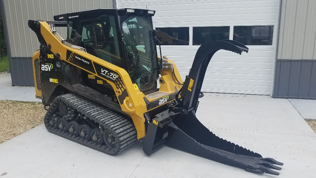

Good to know that the burn solution works. We have had dozens of dead Ash trees from the dreaded Ash Borer in WI. I realize you don't always have the luxury of tipping a tree due to space surrounding it but I have loosened the roots on many dead/dying trees with this bad boy then pushed the tree over "before" cutting. The weight of the tree pulls the stump out with it. After it tips, I cut it in half and have the whole thing on pile in about 30 minutes. 20" to 24" dia. trees no problem and NO leftover stumps!
