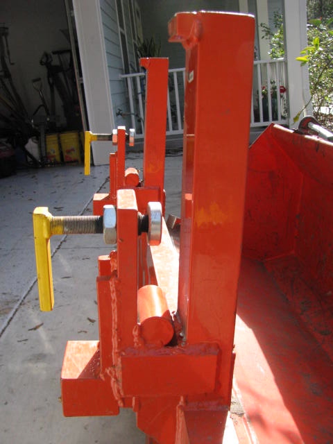

Just another point on a backhoe, most of the time to remove and reinstall is the alignment process, and many here make a frame with something like furniture dollies and wood or metal with casters. This makes the process much easier, also rolls away for storage - of course this only works well if you have concrete or a hard surface area where store your equipment.

I use a backhoe attachment on my 5240 to plant trees and it works very well. To remove or install takes about 10 minutes, if that long. The subframe stays permanently attached on a Kubota, so you have two pins and the hydraulics to remove/install.

I have looked at the videos and instructions on the BH removal and install - its really pretty basic and easy maybe 5-10 minutes most.
Removing and Storing Backhoe
John Deere Front Loader and Backhoe Attachment Demonstration - YouTube
This seems very simple and easy - pretty much the same for the Kubota machines - I wouldnt be concerned. I wonder why the mechanic said it was tough?
Carl
You're right, Carl. That looks pretty easy, and quick. Thanks so much for showing me this video and the instructions. Their field guy seemed to be under the impression you had to remove the subframe to attach the deck mower. But the deck mower was on that tractor plain as day. He works on a lot of different equipment so maybe he was thinking of some of the bigger models. If it's as easy as it looks here, I'm thinking I need to order me up one of them backhoes this spring. Removing and reinstalling the front loader couldn't be easier, and switching around attachments to the three-point hitch is really easy. The mower deck is the most cantankerous but it works well most of the time.
