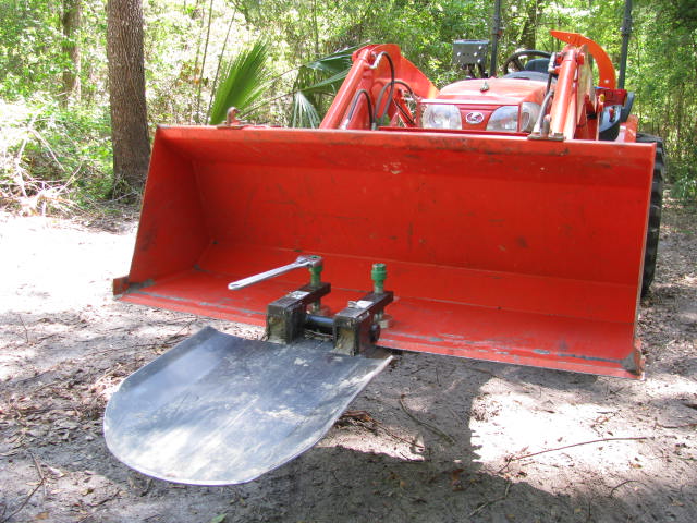

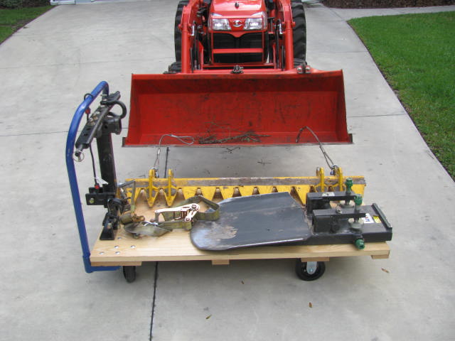

They sold me 24 five gallon fruit trees for $300.
Is a 12" auger a good idea for planting them or would they do better if I loosened out a bigger hole? We have pretty good top soil and Fredrick Clay.
A <$400 clamp-on Bucket Spade works really well for planting trees.
LINK:
Tractor and Skidsteer bucket spade shovel

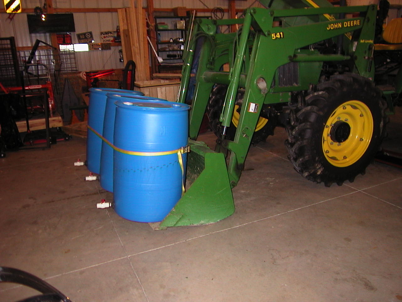

Yeah, well my wife would argue the point. Try the idea below for transporting water without a spaghetti mess of hoses. Get a plastic barrel, drill a hole at the bottom and insert a plastic valve with a water hose adaptor. Get a 12 ft length of hose and that's 11 five gallon buckets. More buckets for big tractors, one for small tractors.
Lift loader to get the last of the water out, don't turn the tractor with the bucket up with bucket in air or you could flip and no kids or dogs nearby. Works like a champ. Oh, you need long arms and a pair of pliers to get the spigot in. A 5' 10" to 6' thin woman with thin arms works best. Tie a string to the pliers.
