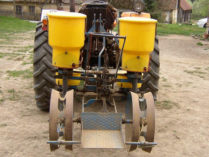

HAHAHAHA,
that planter looks just like mine, a thousands of miles far from you. And it is made in Croatia!!!
My planter is from 1977, bought new. Still working, still good, just with some modifications made a years ago (lowering fertilizer tanks).

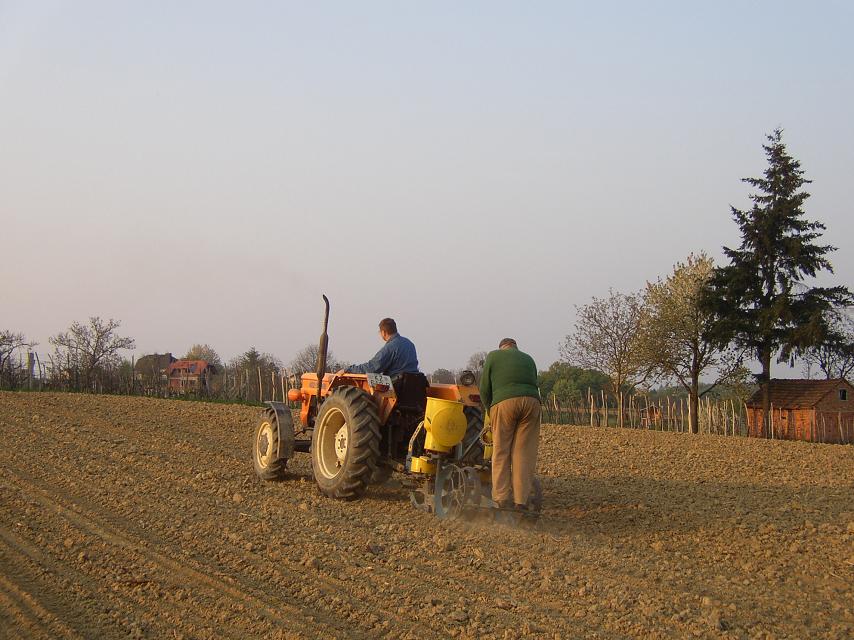

And that's a way how we add necessary additional weight - my father /forums/images/graemlins/grin.gif /forums/images/graemlins/grin.gif /forums/images/graemlins/grin.gif
BTW I'm driver

/ Planter question....(Indydirtfarmer?) #13
Wow.. the fertilizer containers seem pretty large compared to the seed containers.(Compared to an old JD 2-row planter) Why is extra weight needed.. the weight of the planter itself should be good for 2-inch depth.. the ground you are planting.. looks worked up good. Though I know rocks will make the planter jump up some. Are you planting corn?

A little confusion on my part...???? When I'm refering to weight needed, that's in no-till situations. It's hard to keep a rolling disc opener at a constant depth without adiquate weight. It's not just a matter of getting the disc opener to penetrate the soil, it's KEEPING it at that depth through hard spots.
The photos showing the planter on worked soil aren't mine. Although.... When I use my #71 planters, it's USUALLY in tilled soil. Then the issue is keeping the disc openers from running TOO DEEP. (I use "depth bands" on the disc openers to maintain that depth.)

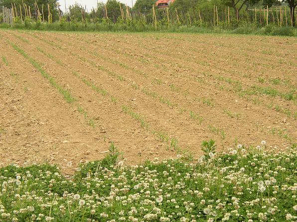

As you can see from attached 3rd pic, we don't have any rocks. Originally planter had seed containers double size then it has now. Containers can accept seed up to 2 acres. That works for us, as we don't have bigger pieces of soil. We lowered it approx 8" due to slopes, and easier fertilizer filling. Each box can accept about 30 kg (65 lbs) of fertilizer.
Add weight is usuall necessary to close planted rows, and not allways.
Yes, we use that planter only for corn, and on pic is corn planting. Distance between rows is 70cm (28in). This is common distance here, and all picker and corn heads are set up for it.
Here nobody do NO TILL planting, so I don't know what equippment is necessary for that procedure.
We plow in autumn, up to now disk in spring and till.
This year we start to using tiller instead of disk, and will se results. Seems that tiller better cover residues, and not cause planter clodging.

You seem to be doin' alright, a full corn crib, plenty of bean poles, a fine crop of dandelions and a relative willin' to work for his dinner. /forums/images/graemlins/grin.gif

Looks very nice!
"Seems that tiller better cover residues, and not cause planter clodging."
I found that true too.. but sometimes it's easier to till.. if the field's been run over once w/ the disc.
I use a 2-row corn planter too.. but this year we've experimented and also planted beans, pumkins, and winter squash w/ the same planter.. same spacing. We did plant the Lima beans by hand.. seeds are too fat.
