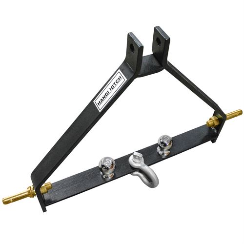

It is hazardous to drag tree trunks flat on the ground. It the dragged trunk encounters an obstruction the tractor can go vertical in one second. Ask me how I know.
Use a cross-drawbar, preferably in the form of a triangle, to elevate trunk butts six inches or so. Much safer and reduces friction of log against the ground by 50%.
LINKS(2): HANDI HITCH

Just to be clear. That drawbar arrangement can be dangerous as it can raise your pulling point and pull the tractor over backwards. It must only be used (in logging) to elevate the trunks AT the drawbar. Like a skidding winch would. I have used such a thing decades ago to pull a 3 spindle bush hog and have height adjustment, but never used it to pull something via cable or chain.

Will drag ( with a low lift point as stated by Industrial toys) to the area I plan to push it into.
