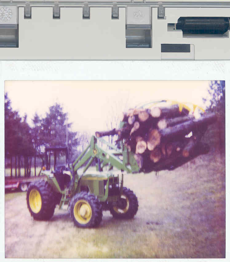

Consider enough tractor weight and FEL lift capacity so you can carry, rather than drag, your payload. You need tractor weight and wide wheel stance for tractor stability. Also required, Three Point Hitch counterbalance.

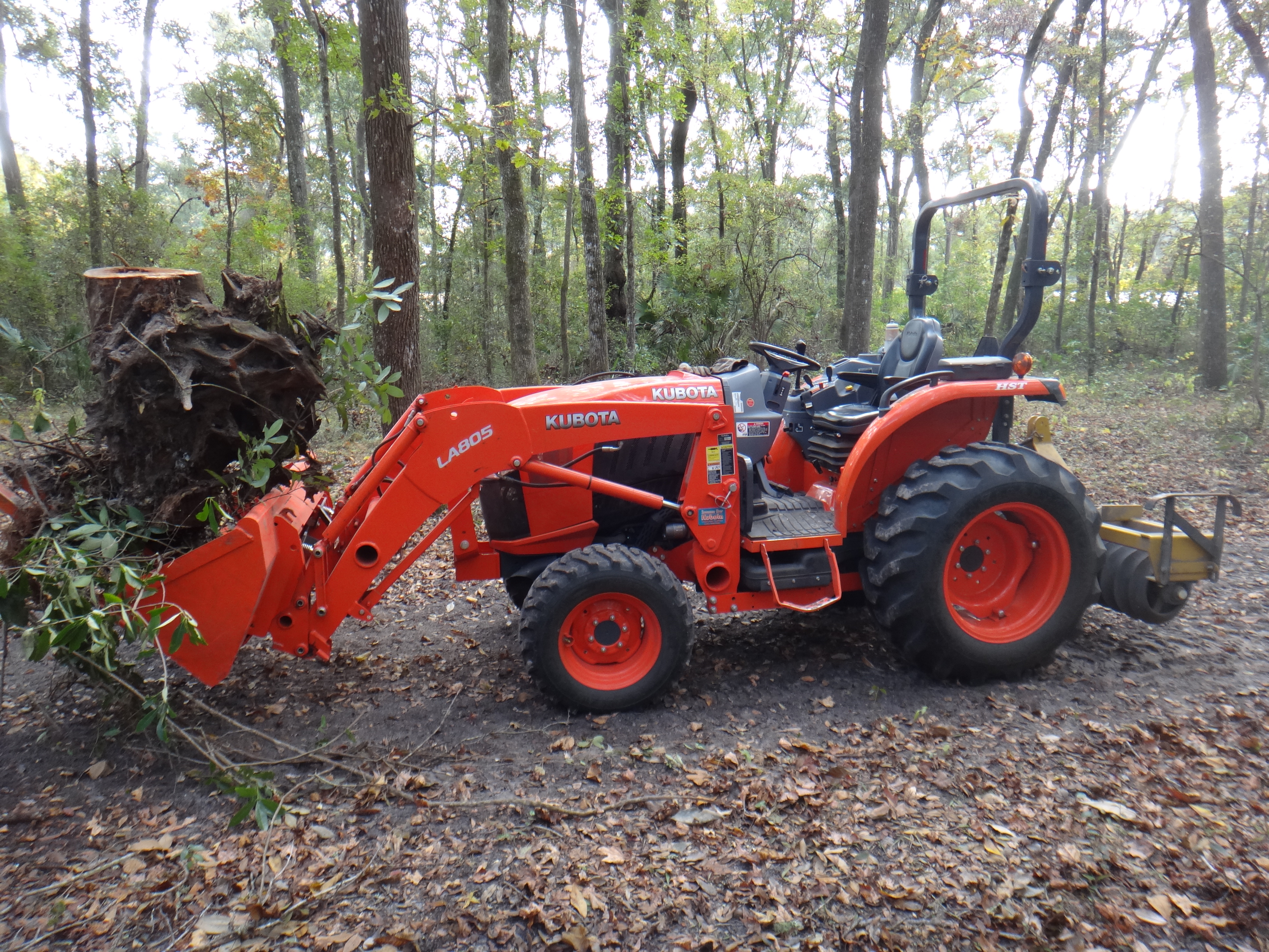

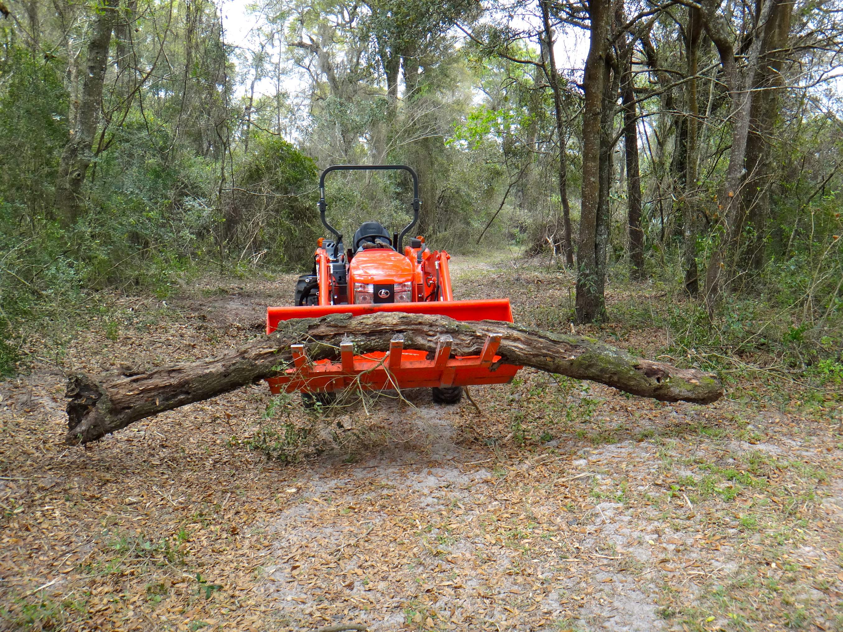

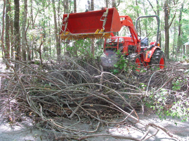

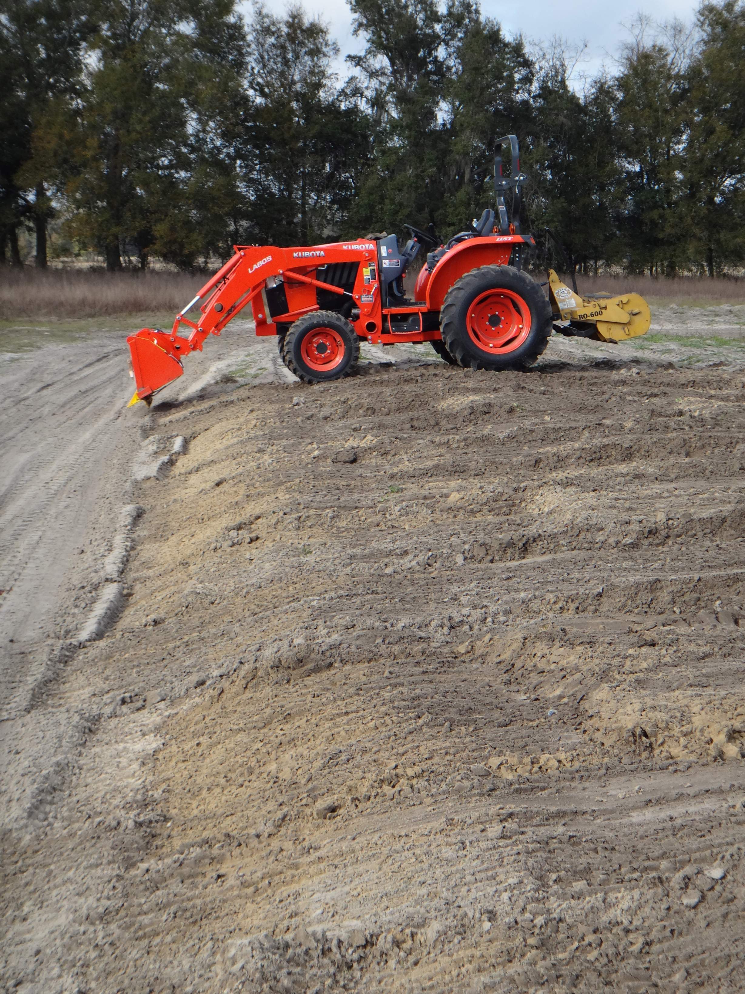

Photo #1 Kubota B3300SU, 2,200 pounds.
Photo #2, #3, #4 Kubota L3560, 5,400 pounds operating weight, FEL lift 1,800 (+/-) pounds.

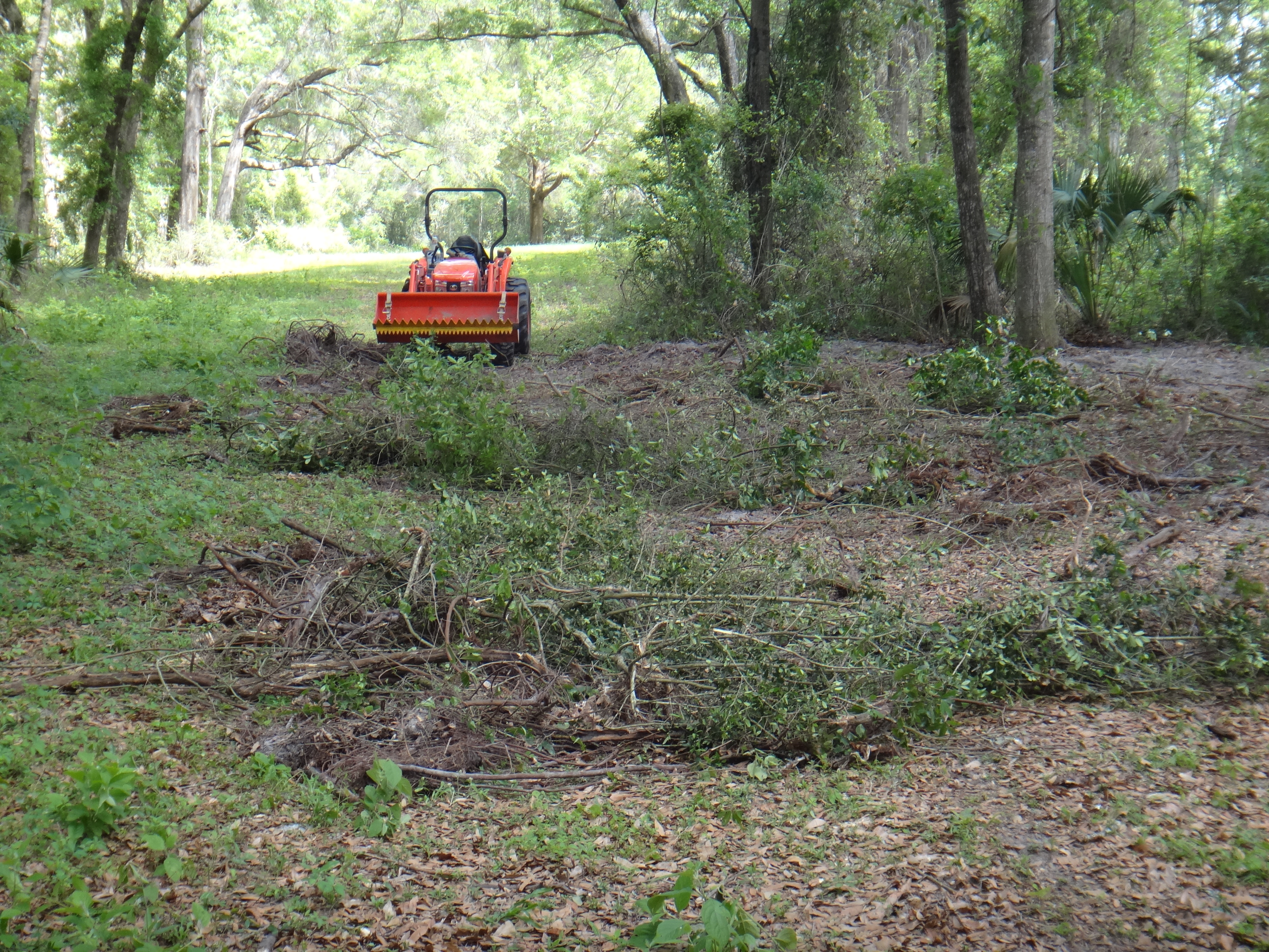

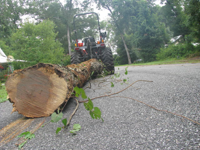

I will be using it to assist in moving trees that fall, a grapple bucket to gather limbs and stuff. I will be moving the trees and limbs all the way to the back of my land and pushing them into a gully.
Once I have the property fairly cleaned up. I will be maintaining the area. Bush hog and tree clean up will be the majority of the jobs done with it. I want good lift and push abilities. I might get a 3 point finish mower at some point to maintain some of the back in the photos below but won't be maintaining the entire property with a finish. Rough cut will be fine for the top of the hill and further back.
I feel the L4400 did a good job. I had no issues pushing much of the trees and stuff like that that I was moving. ( note pile of trees in one of the above photos I attached.) I cut down 4 trees. I was able to drag them and push them into a pile.

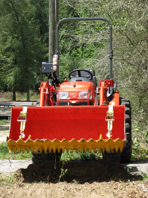

If you intend to push tree debris into piles plan on purchasing a Ratchet Rake bucket attachment. Good for multiple woods tasks.
100% something I have considered!
Just not sure if I will need it if I get a grapple bucket.... but an awesome product till I can get the grapple.
