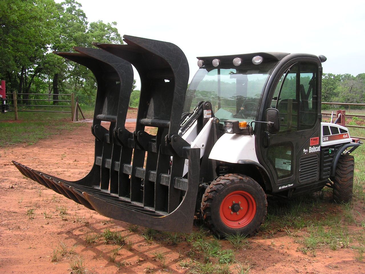

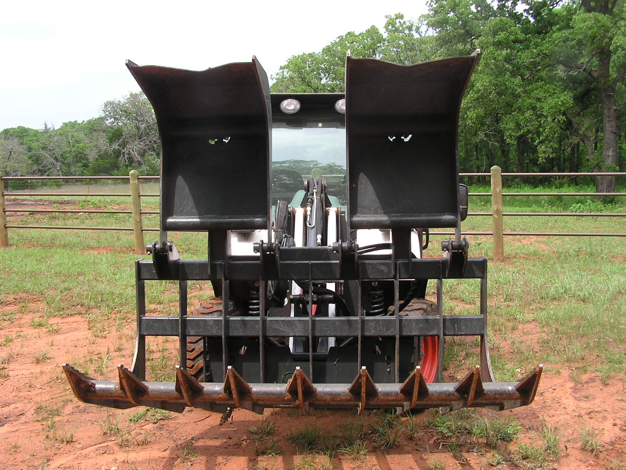

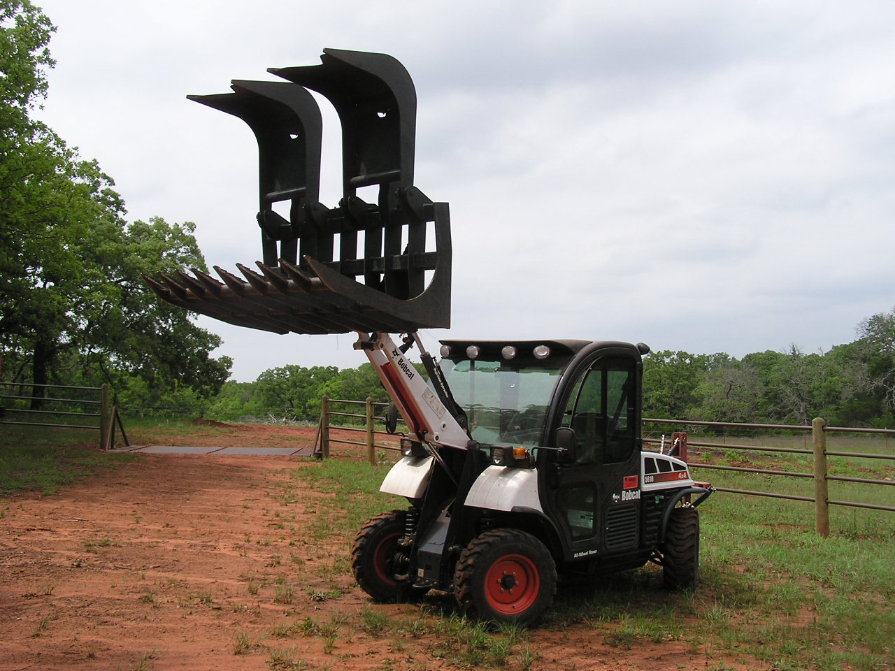

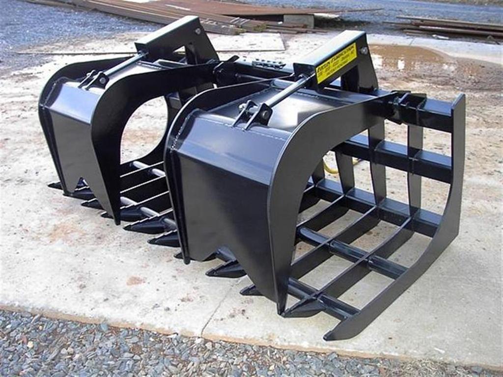

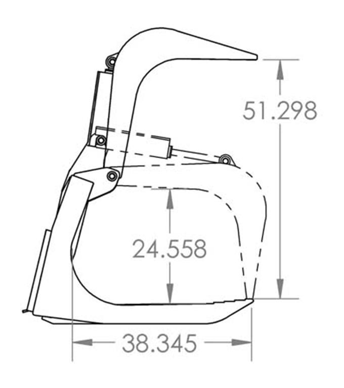

Here is a good design that you can get some ideas from.
Notice the high pivot point for the lids, this is why it has a 51" opening, great for picking up brush.
The tines are 1/2" thick.
/ planning stages for a grapple #6

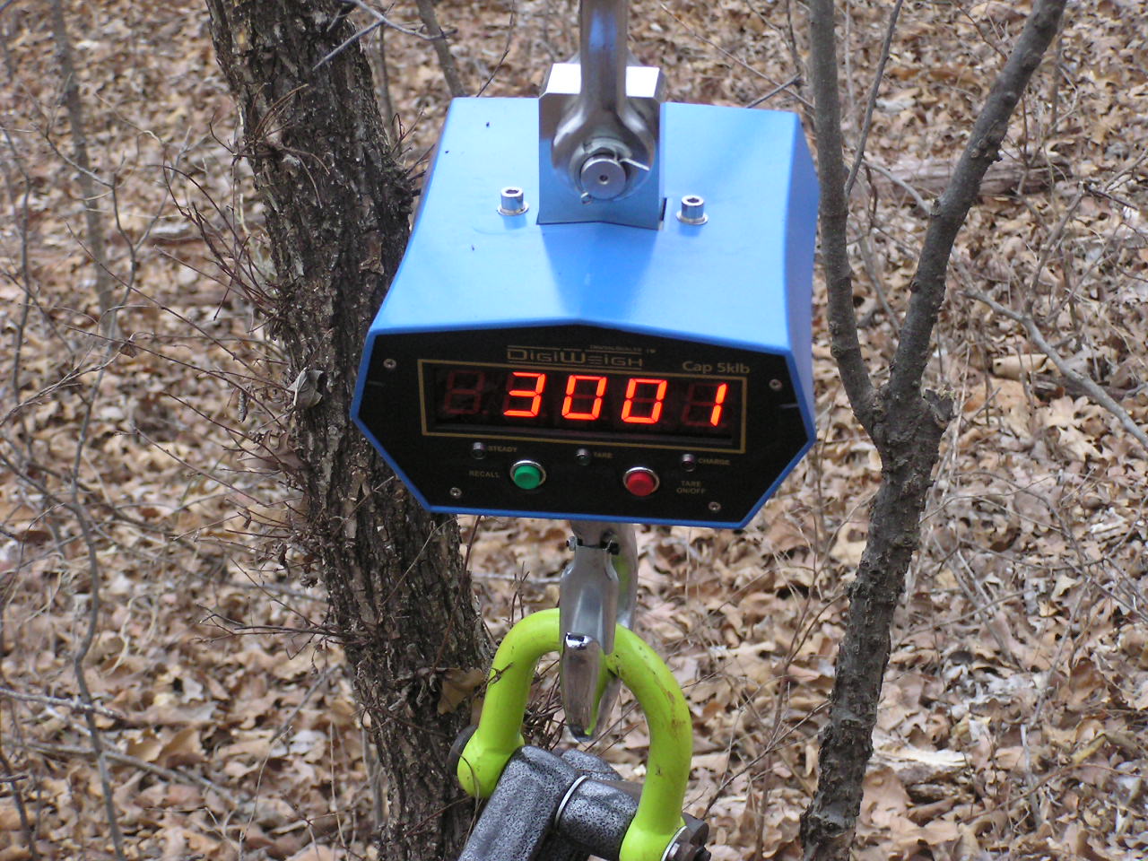

That picture sure showes a good bite. How much can a tool cat pick? Does this force you to drive backwards?Very good looking. Would you make any changes?

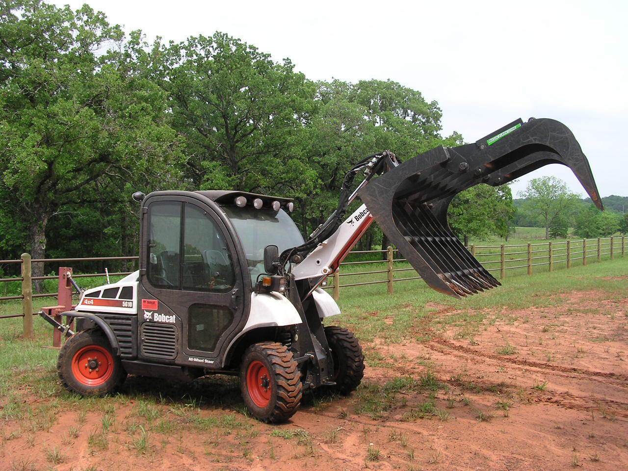

Hey guys I was wondering what your opinions are concerning the ends of the tines? In all of the above photos posted by Xfaxman the tines are pointed upward. What are the advantages of pointing them upward vs having them point down? Other then digging into the earth I'm wondering if they were pointed downward brush, branches etc. could roll into the grapple easier? Your thoughts. Stanley
/ planning stages for a grapple #8
I would think that you choose the angle when picking the pile and when curling back the tips keep the items in it's grip.

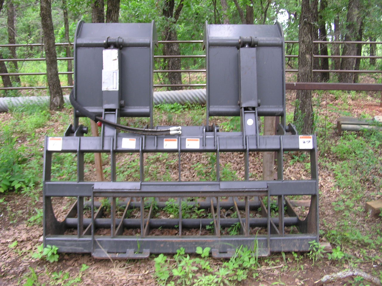

That picture sure showes a good bite. How much can a tool cat pick? I measured about 3000 pounds at the SSQA with no attachment on it.
Does this force you to drive backwards? No, you can see where you are going with the lids down. Very good looking. Would you make any changes? No changes.

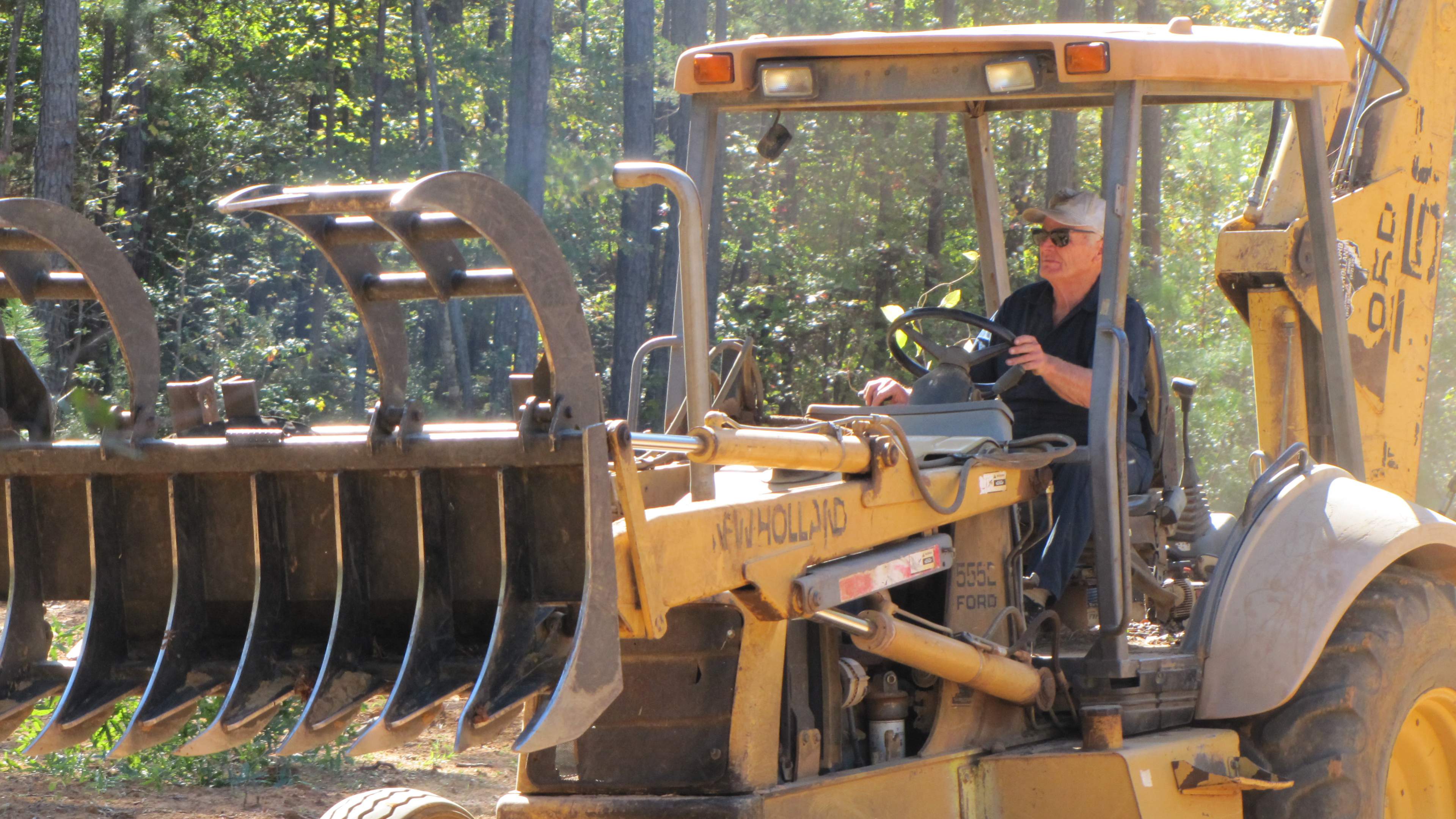

Hey guys I was wondering what your opinions are concerning the ends of the tines? In all of the above photos posted by Xfaxman the tines are pointed upward. Here is one curled down.
What are the advantages of pointing them upward vs having them point down? Other then digging into the earth I'm wondering if they were pointed downward brush, branches etc. could roll into the grapple easier? Yep that is the way it works.
Just curl the tines down slightly below ground level, drive forward to rake the brush and fill the grapple. Then close the lids and drive to the pile.
