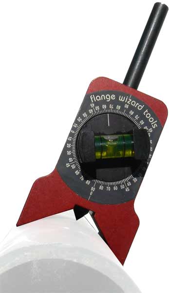

You can use a small piece of angle iron, lay it on your pipe and mark a straight line. Clamp your pipe in a pipe vice or regular vice, use a centering head with a tri-square, (when bubble in vial is center) to make sure the line is right at 12:00 O'clock then place your coping pattern / template accordingly. Or you can use a Flange Wizard centering head with center punch to find 12:00 O'clock on the pipe.

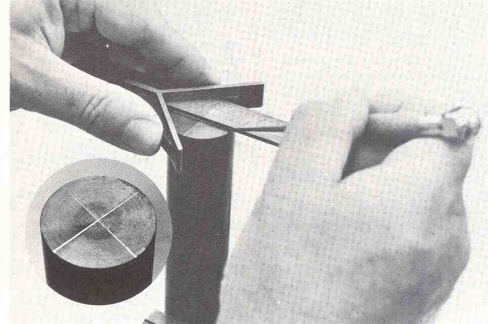

/ pipe fence #13
Here is a better picture, (well not of quality:mad:) of how I was trying to explain how to use a centering head with a tri square.
