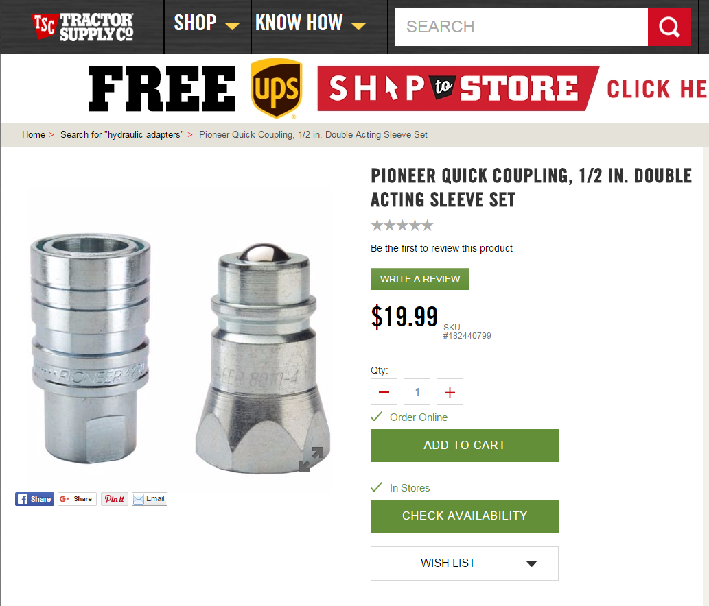

Please excuse the dumb question.
I am running hoses from my rear hydraulics up to the front of the loader to make my snow plow power angle.
Today I went to Tractor supply and bought a bunch of pioneer quick connect fittings.
I now have a "problem"....
The fitting on the back of my tractor(the female ends) I can just push the male ends in and they couple. To uncouple I just pull on the hose.
NOW, with the fittings I bought from TSC I have to pull the collar back on the female coupler to connect and disconnect them.
Is there a different coupler that I can get to just allow me to push/pull to connect/disconnect?
BTW my fittings on the rear of the tractor have a "square" pin inside the coupler, the TCS fitting have a round ball. Is that the difference?
The "tip" on this mall connector is what my tractor has in the female connector and that is the one that just push/pulls
Pioneer 1/2 in. Standard ISO Tip, 3/4 In., 16 ORB, Fits All Current Models, Poppet - For Life Out Here
The couplers I bought have this style "ball" on the male and female couplers
Pioneer Quick Coupling, 1/2 in. Single Acting Sleeve Set - For Life Out Here

That is a breakaway connector, intended for tow-behind implements. That is not the same as a quick-disconnect, though they sort of do the same thing.

It sounds like your tractor has poppet quick connects and you purchased ball (or AG) quick connects. They should interchange just fine.
I have purchased several quick connects from TSC and they have all been breakaway fittings (and they may have been labeled that way).
Sometimes they call those quick connects 2 way or push/pull fittings.
What was the item number for the ones you got from TSC?

IMHO this "double acting" coupler is what you need.
Correct. There is no access to the collar. You just pus the attaching fitting in or pull them apart.
I will have to look closer, But I didn't see any that said they were breakaway or not.
#1824203 is the pair(one male one female) I also bought #1824457(male ends only)

It appears that the fittings I got from TSC are not I.S.O. 5675 agricultural standard. I will have to return them and see If I can get the ISO ones
