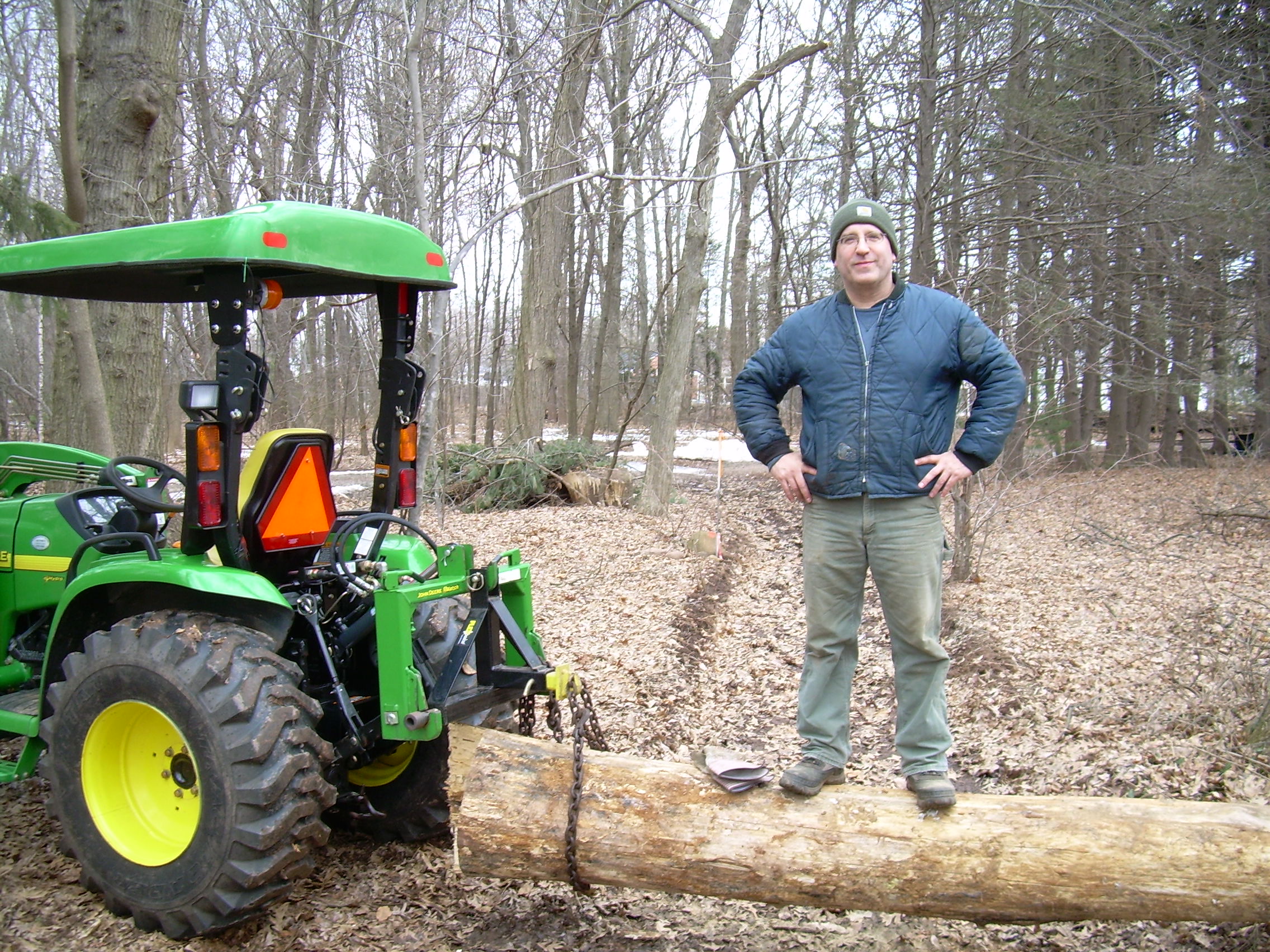

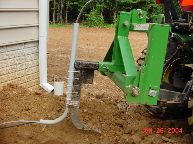

My suggestion would be a 3PH trailer mover, then you can add any receiver you want...
EZMover
TSC
