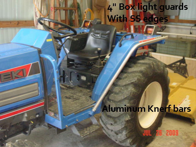

Here is the start to my attempt to brush proof my baby before taking it into the thick stuff with the bush hog. The light covers are 4" box with 3/8" SS rod on the edges. The knerf bars are 1" aluminum mounted outside the fenders to try to keep the brush from getting to the paint. I don't have a picture of the brush guard yet. Cow catcher comes to mind.

The trim looks nice, and is the square tubing for a good handhold an addition as well?
For brush cutting, I back into the brush that may scratch my tractor. :) If the brush is low, then I may drive forward and keep the bucket low to push it over (your cowcatcher idea). But most brush cutting is in reverse.

The sqaure tube in front of the platform is stock. It has a plexiglass window inside it. It keeps the mud off in wet conditons. And also the heat in dry.
