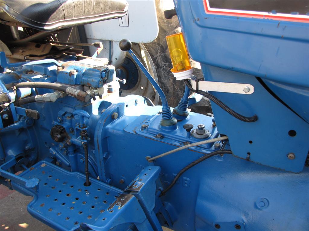

I have been clearing an area for a new shed that I will build. I have been pulling some old posts. At times I needed to set my parking brake, Ford 4610. The problem is that I don't often use the parking brake and always forget that the brake is set. I then move the tractor and when I step on the clutch I realize that the brake is set. I usually just lightly set the brake.
I decided to add a parking brake warning light. I used a pill bottle for the light lens. I used existing holes so I did not have to drill any holes. Now when I set the parking brake that warning light starts flashing. No way am I going to miss that light. I will test this light out and later maybe change it out to a flashing LED that I will place in the instrument panel. I have one open space for a light.
It is Mickey Mouse but it works.

Well, I got to try out my light today. I set those brakes often. I can't miss that light, even in the sun light, and it works well. Some day I will replace it with an LED and move it to my instrument panel.

Maybe I missed it - but how is the light actuated - is there a switch on the pedal?
/ Pill Bottle Warning Light
#14
In order to set the parking brake I have to lift and rotate the set T handle. You can see the handle in the picture to the left and below the light. It has the black plastic wrap vertically on it. Under that handle and below the footrest I installed a bracket that holds a lever action micro switch. I drilled a hole in the lever, added some SS safety wire and ran it up to the T handle. I wrapped it around the bottom of the T handle then held it in place with tie wraps. When I lift and rotate the handle the micro switch activates the light. It seems to work pretty good. If the safety wire does not work over time I am going to replace it with piano wire.
This tractor did not have any type of warning for parking brakes. I often just forgot about the brake. I do not use the parking brake that often.

ETpilot, I noticed in your picture that you have a add-on hydraulic remote block under the factory one. Could you tell me what brand, and where you bought it? Everyone I've seen online says they won't work with the 10 series AG tractors. I have an '85 4610 that I'd like to add at least one more set of remotes. The existing remote is being used for the FEL.

Let me look for the paperwork on it. I think I saw it a few days ago looking for something else. My setup was just like yours. I used the 1 remote for the FEL. That required some long hoses to attach to the rear of the tractor. Plus IIRC when using the FEL I could not use the 3PH at the same time. Now, with this hydrualic manifold, I can attach the FEL and use the 3PH at the same time. It was not difficult to install. I purchased it locally at my Ford Dealer.
I will post the info when I find it.
