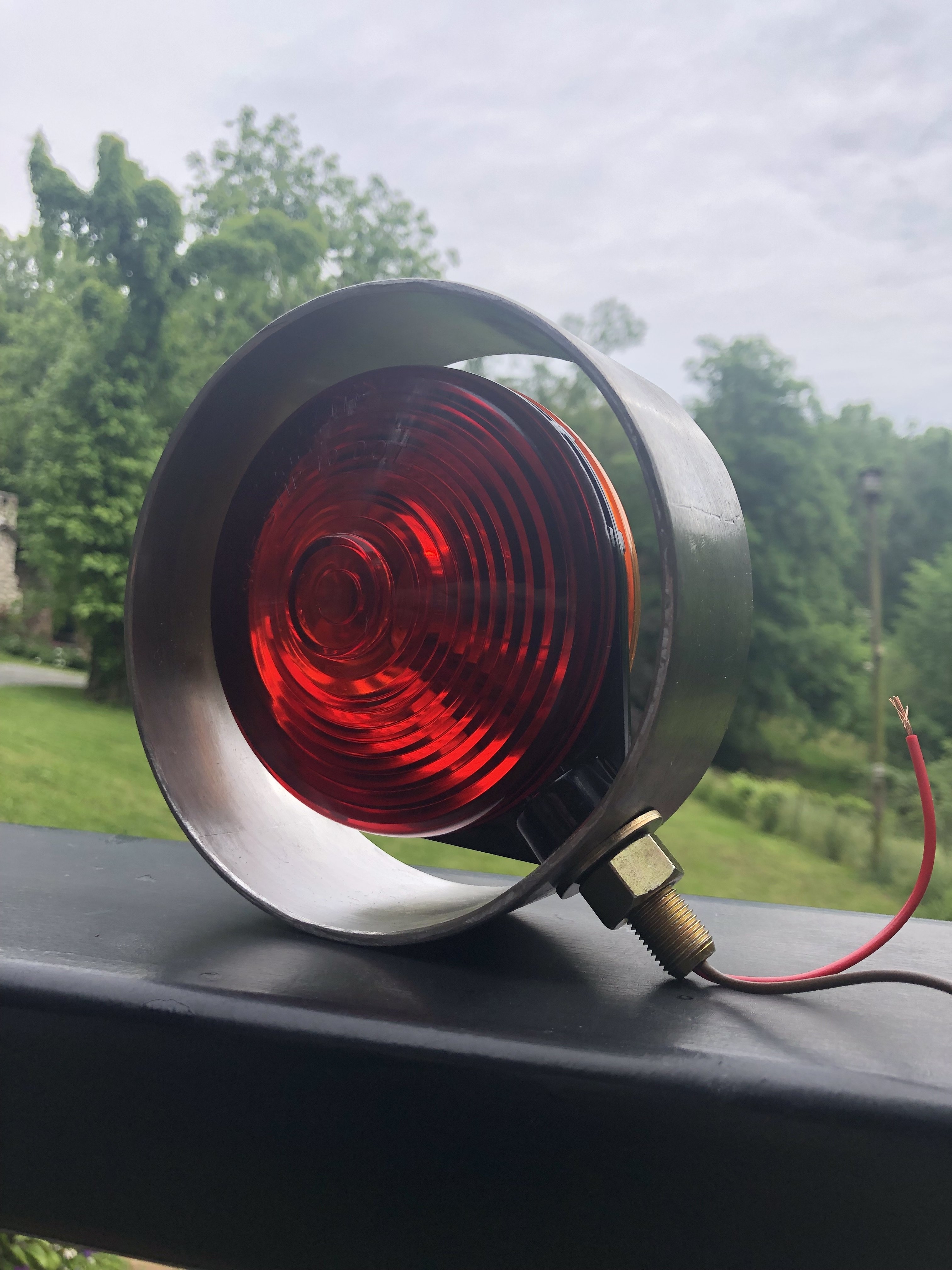

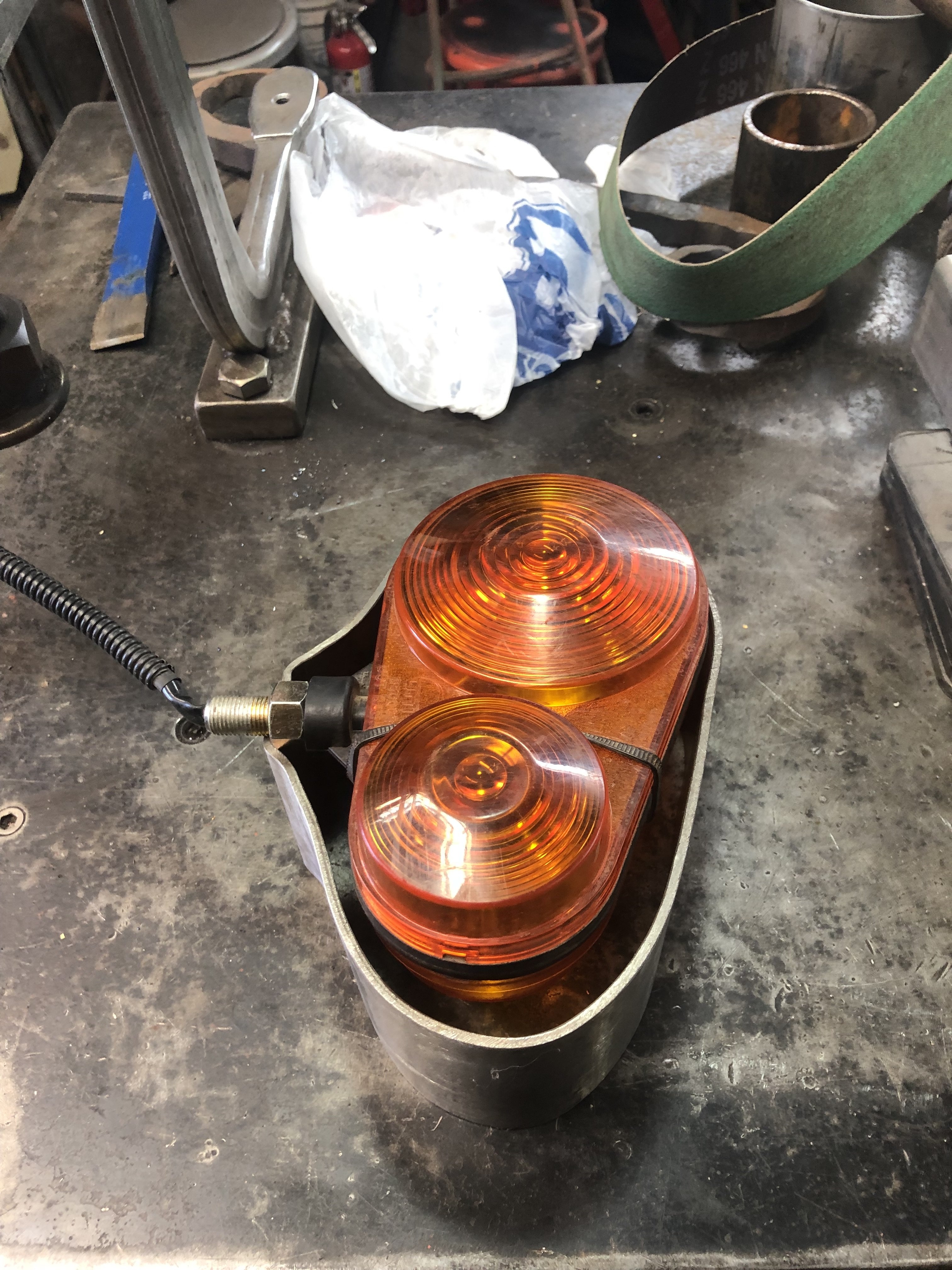

One of this winter’s projects is to replace my TC45DA ROPs lights with ones mounted in a steel framed box.
I’m using 1/8”x3” wide strap to make the boxes. Along with LEDs, I’m also adding strobes and work lights.

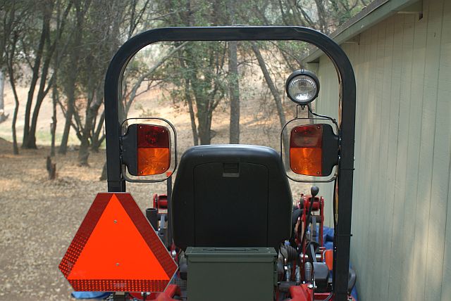

I use my tractor as a skidder and go into dense woods.
I first mounted illumination type lights on the inside of the rops but didn’t like the spread or me being in the way of the light throw.
I mounted the lights back close to the fender on the outside of the rops but arranged the mounting bracket vertically.
This way when the lights are struck by brush, they simply give and hinge back.
When l need the lights, I just push them back straight.
