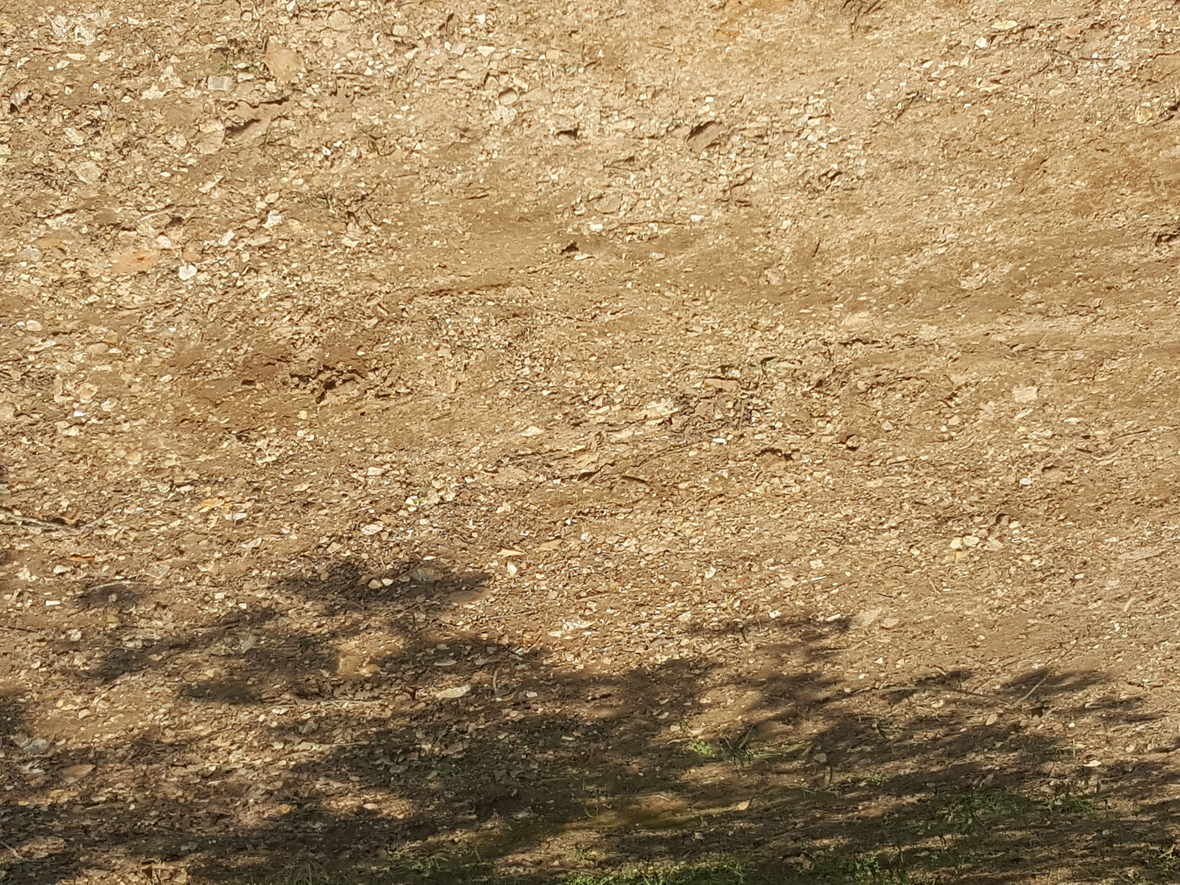

The piranha bar looks and sounds great; my indecision is based on where I live. It is the Ozarks hills in southern Missouri and the rocks are everywhere. Would the landscaping that I am doing be better done with a toothed bar where the projection is probably double that of the piranha?View attachment 567035View attachment 567035
I use both a Piranha bar and a traditional tooth bar (a Tisco). The Piranha is plenty durable, and is more versatile because of its ability when clearing brush and when fine grading and back-dragging. Also better for moving snow. But for a lot of serious digging in hardpan or rocky dirt, or in handling No. 3 construction stone and larger, the traditional tooth bar will give you faster and easier penetration. The serrated design of the PTB spreads the point loads over more surface area of the leading edge.

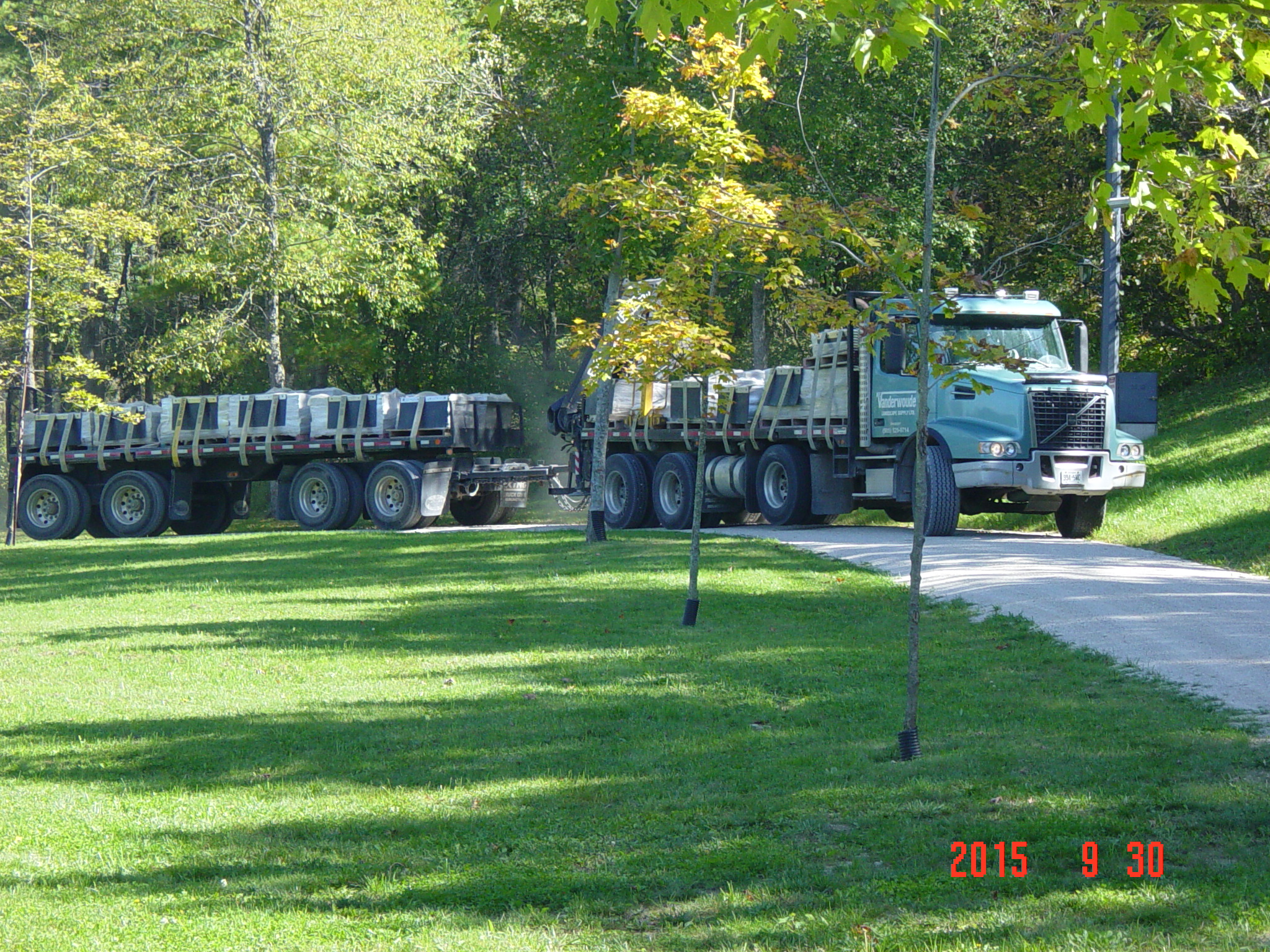

This is Canada, there Aint Nottin! Maybe I have go to Niagara Falls NY.
My Lady friend got me a little retaining wall stone from one of her Condos she manages, that wasn't installed right and falling over. I just had to pay for trucking. Man, I need to get off my azz and do something with it.
