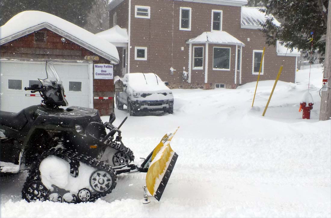

Not very many pictures here!! Taken today. We've been receiving snow continuously for about 4 days now. :thumbsup:
