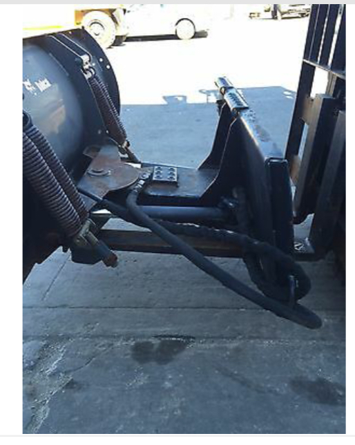

This might be a dumb question but I saw a Skid Steer hydraulic powered SSQA snow plow for sale. What would I need to hook that up to my tractor?
Are the hook ups the same or different? Never seen a skid steer hook up and have no experience with it.
I don’t have a 3rd function on the tractor yet. Not sure if I would invest a lot in one, being the skid steer plow has two cylinders I assume I need two valves? Wouldn’t be as simple as running a few hoses from the rear remote.
Let me see if I can help answer a few more of your questions.
- if the plow looks like the one here. You’d probably fine. Those cylinders aren’t any different than a grapple or truck mounted plow.
- yes you would require a 3rd function but just one not two. Summit Husraulics has the cheapest I’ve seen. Installation is easy. I just finished my own.
- the connection points are likely going to be Bobcat style quick connects. No issue here. You merely unscrew them and install whatever quick connects you end up with on your tractor.
- I just posted my build cost in here title “another underslung story”. Folks are going to chime in and recommend you install cushion valves, flow restrictors etc. it’ll give you an idea what your in for.
- I dont know much about rear remotes but folks run them to operate pistons like this all the time. In short actuating small pistons doesn’t take much.
Hope this helps.

I use a 96” SSQA plow on my L6060. I bought it used, (well actually previously owned but unused). It’s got a urethane cutting edge and works great on blacktop with the shoes removed.
Snow/Light Material Blade | Blades | Snow Equipment | Skid Steer Attachments | Erskine Attachments LLC
I did add a cushion valve and connect it to my third function. If you don’t have a third function, you could run long hoses back to the rear remotes, it only takes one valve to work the angle regardless of how many cylinders are on the blade. Y9ur tractor hydraulics would be adequate to operate the angle cylinders, the high flow attachments with motors like augers, snowblowers or brooms would be a different story. And I’m assuming that you have a SSQA on your loader.

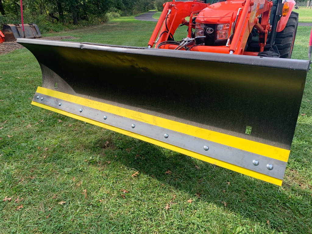

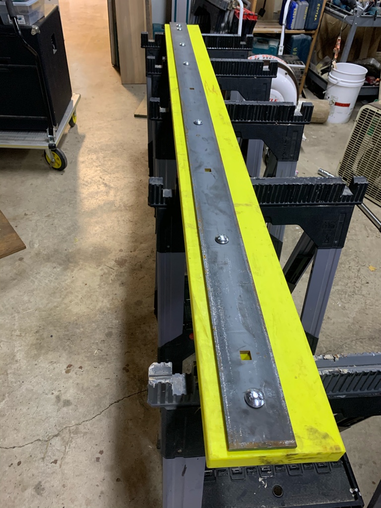

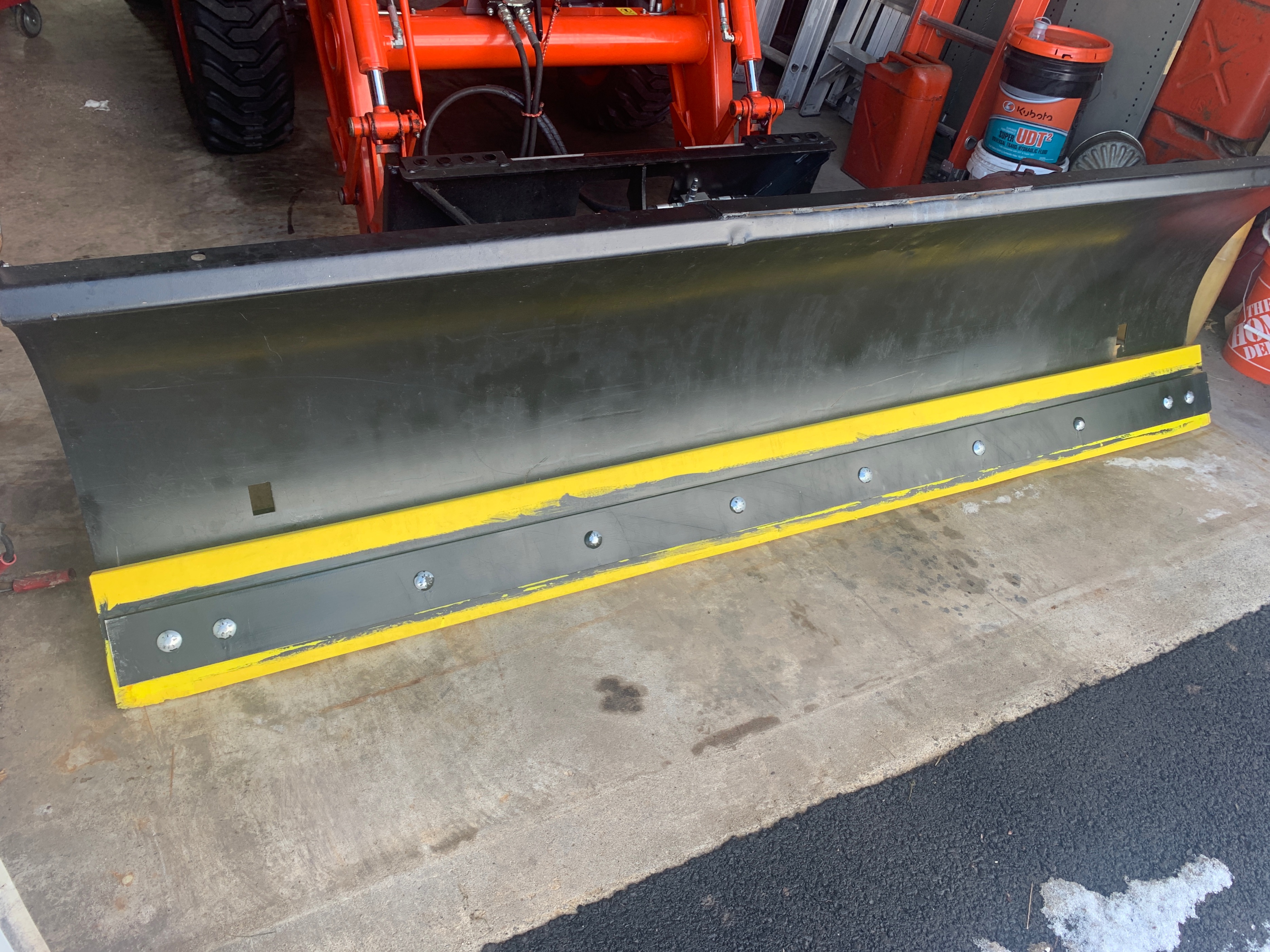

Curious about your cutting edge...
Your blade is a similar weight to my HLA 84" blade, and I am considering a uhmw polyethylene edge. I can't decide on the thickness though. Is your edge actually polyurethane? How thick, and how is it wearing?
I have a 2" thick polyurethane edge on my lighter rear plow which has worn well over the past 4 seasons. I lowered the edge this season to accommodate 1" of wear.
The polyethylene uhmw supposedly wears better than urethane, and I only see it available up to 1.5" thick.
Thanks for any insight and experience...
