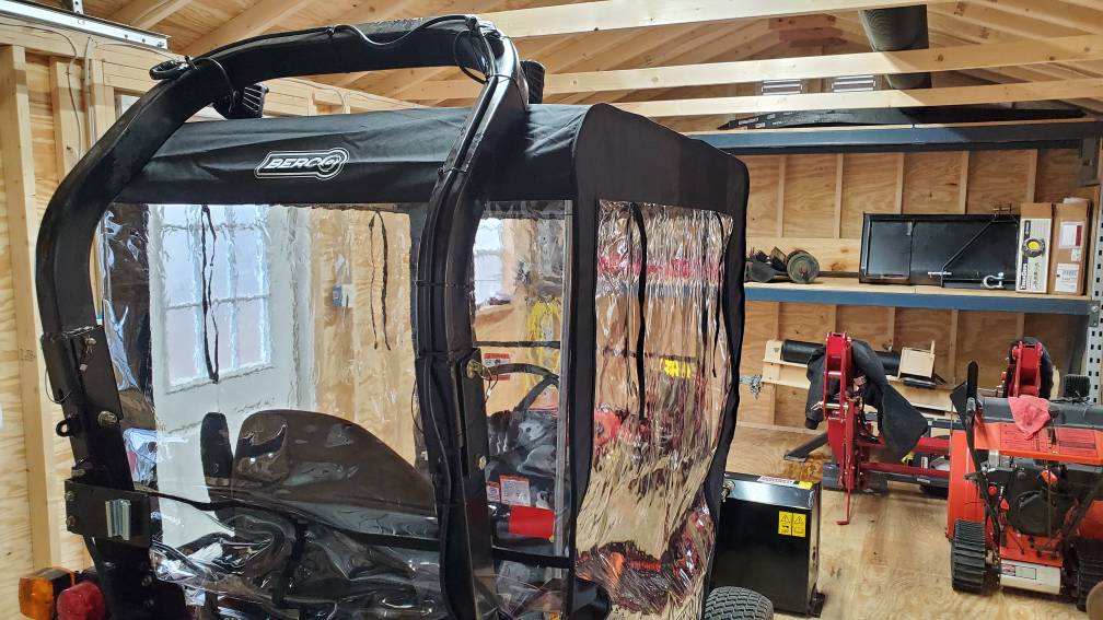

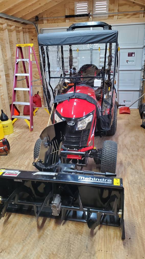

Mahindra EMax20s 48" 2 stage blower,, Berco 40 inch universal cab and modified the brackets to work. I chose the universal, because the cab is not as tall, and I had already cut shortened and rewelded the rops to fit under a standard garage door.
The only thing left to do for my install is to put a 1 inch grommet in the cab for the chute crank, and put the rubber tire chains on.

How do you plan to handle the melted snow after a storm and coming in on the wood floor? Is there a drain?
   / Pictures of your snow weapons #5,804
I plan to park in our heated garage on a concrete floor when necessary. If we get a big storm.
In the event I end up keeping it on the wood floor at times, I'm not too concerned. The floor slopes toward the door. Shovel the excess out, let the floor dry If the ply starts getting soft in a few years, 15/32 ply is $30 a sheet.
I built my previous shed in 1986, and kept my old tractor and blower on it all winter. That shed is still in use as a she shed. I only replaced a small section of flooring once in 34 years.
Adequate air flow in the shed is helpful. I have a ridge vent and two gable vents on each end which I hope does the job

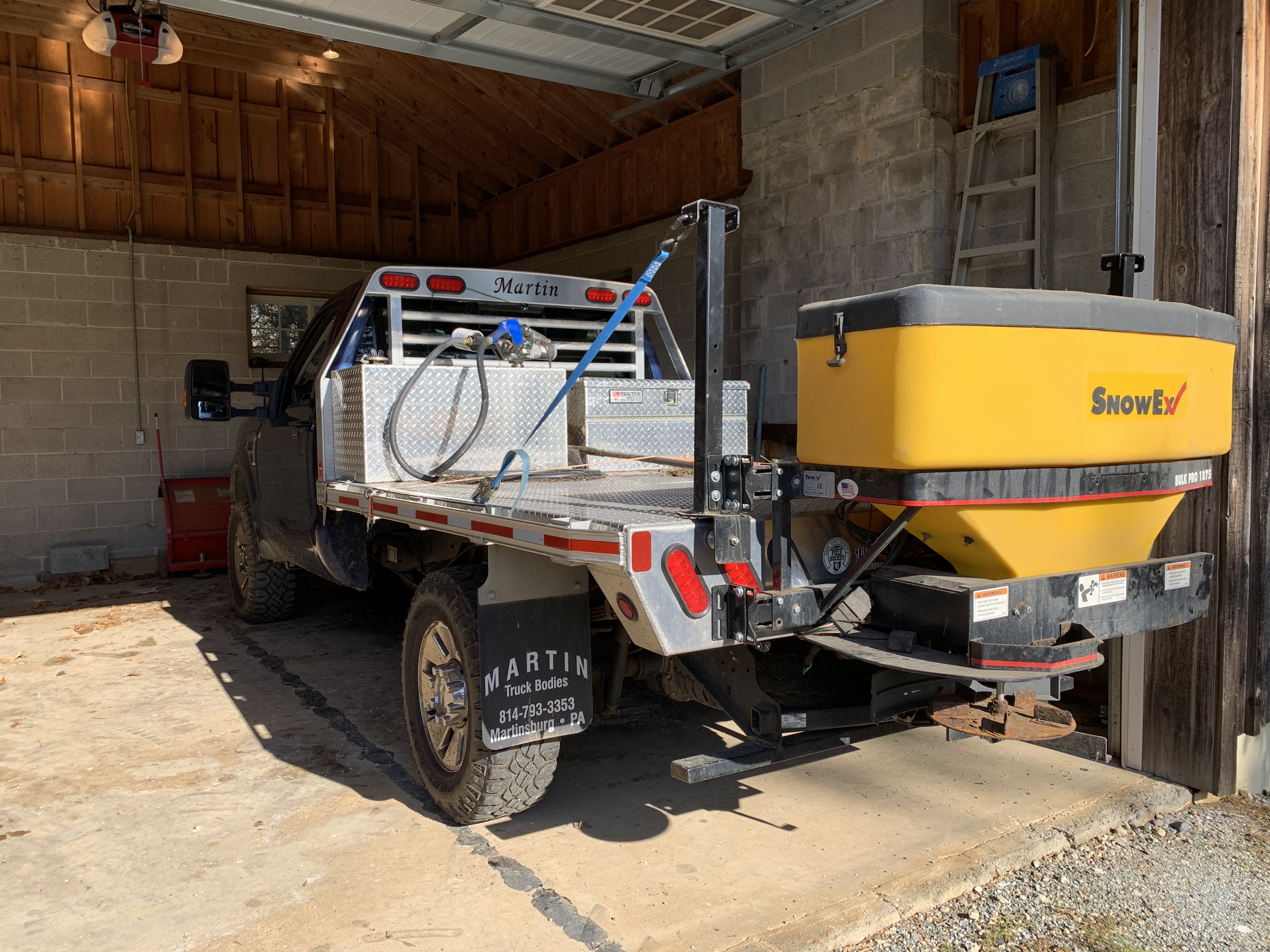

Hay Dude how do you like your aluminum flatbed ? How's it holding up? What did you pay and where did you get it ? I'm thinking of putting a flat bed on one of my 99's since they want $3,000 for a regular bed no tailgate.:confused2: I hate salt !!!:mad::drink:
   / Pictures of your snow weapons #5,810
Really like them. I have 2 trucks with aluminum flat beds. I also had an F550 with a steel flatbed.
2020 RAM 5500 with 9 EBY
2008 (removed) F350 with 9 Martin
Steel is more goof proof. If youre carrying anything heavy/pointy, I suggest steel. Aluminum looks better longer and of course no rust. A sheet of 3/4” treated plywood can help tremendously
They are holding up well, but I also take great care of them when Im loading cargo.
The Martin bed is nicer, but to be fair, I built the Martin bed with thicker aluminum. I highly suggest the heavier gauge aluminum diamond plate if you carry anything heavy and pointy. Itll dent the thin aluminum. I built the EBY bed a little lighter to keep the truck weight down to allow more heavy towing capacity.
I dont carry boulders or anything that will damage the beds. I use them for towing or carrying loader buckets and other attachments.
