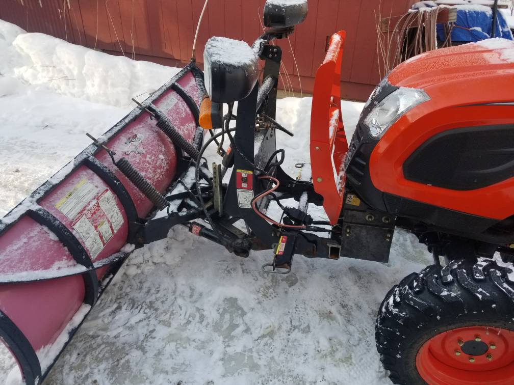

Just got my boss 7.5ft sport duty mounted to my ck2610. It works great so far. I can switch the plow between my tractor and truck now. View attachment 540343 20180217_081549.jpg

Why didn't you mount the plow slot closer?? Would be less stress to the front axle I would think
Probably because the plow brackets are the only piece that could practically be shortened and it wouldn’t fit his truck then. The plow should still be a lot less stressful on the axel than the loader.
The plow is no further out then the bucket. And I can just barely open the hood where the plow is now. And at 400lbs the plow isn't nothing the tractor at all.
Not to say closer wouldn't be better.

Looks good, have you considered a brace back to the mid or rear section of the tractor.
A truck has a full length frame where as the tractor front is a sub frame tied to the front of the engine,
It wasn't many years ago when our truck, jeep and scout plows actually had attachment points under the cabs
back about where the seats mounted.
