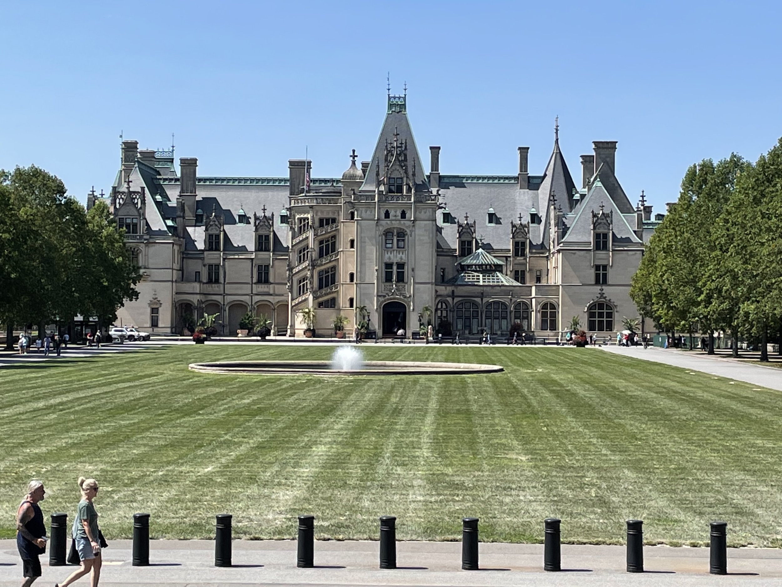

We visited the Biltmore Estate a couple of years ago and they obviously make an effort to keep it looking perfect. They have a huge front lawn area and the day we were there they were spreading something that looked like sand. I now suspect it was.

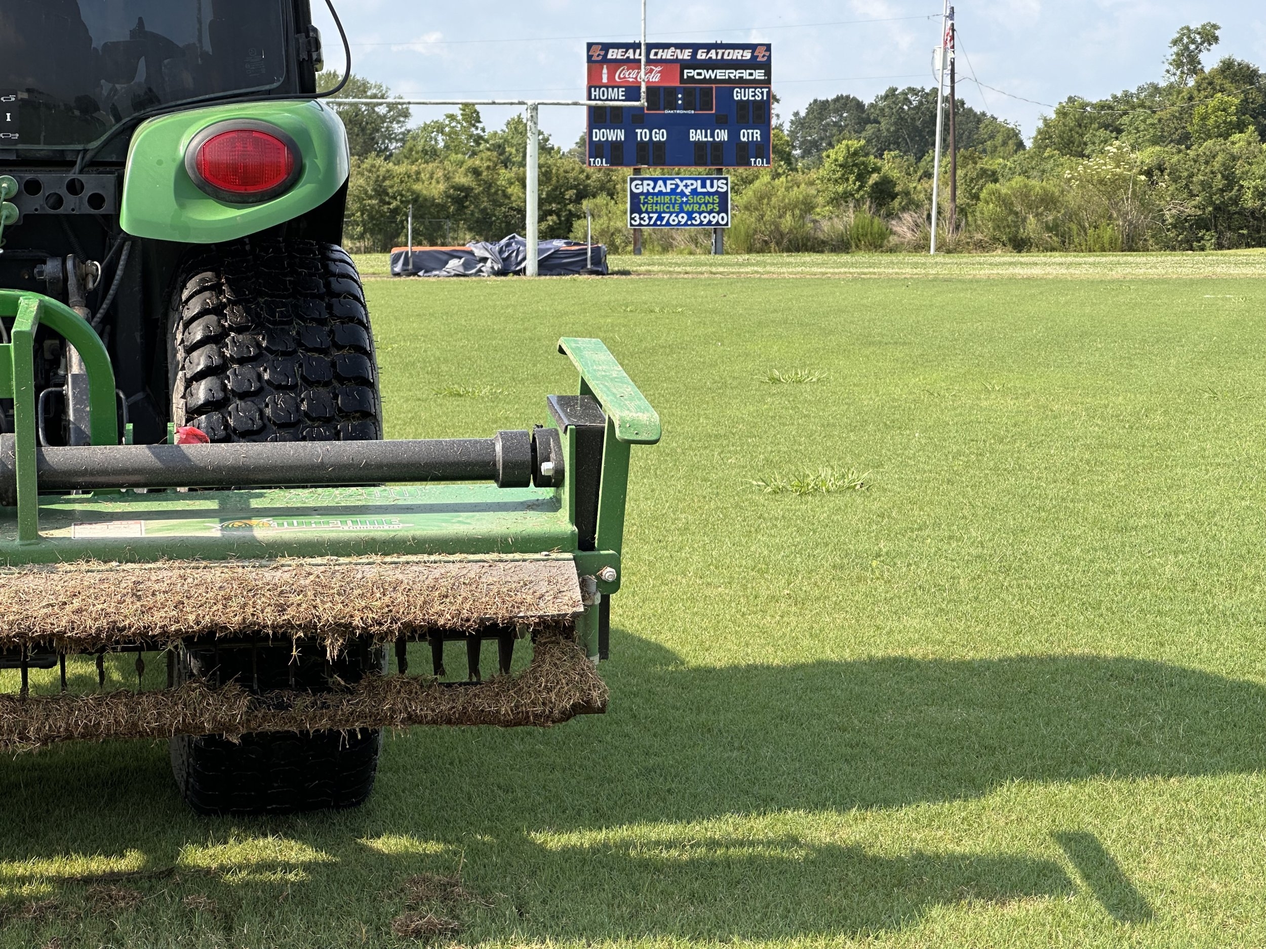

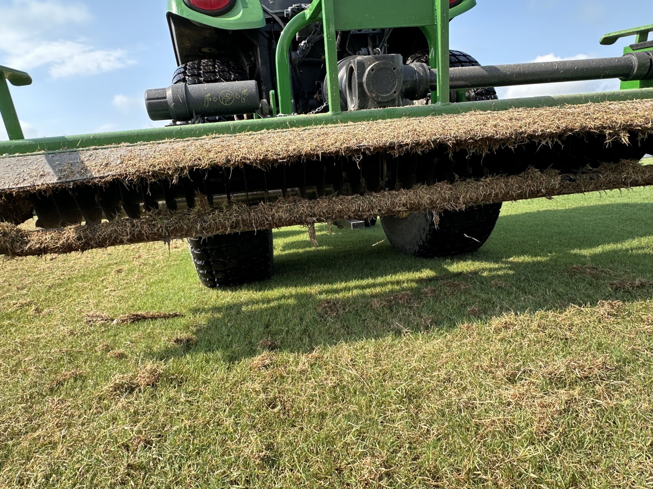

More verticutting today. I had to hold off the 18 loads of sand on my schedule because of the rain we have been getting. This field is scheduled to be aerated and topdressed as soon as the weather allows.

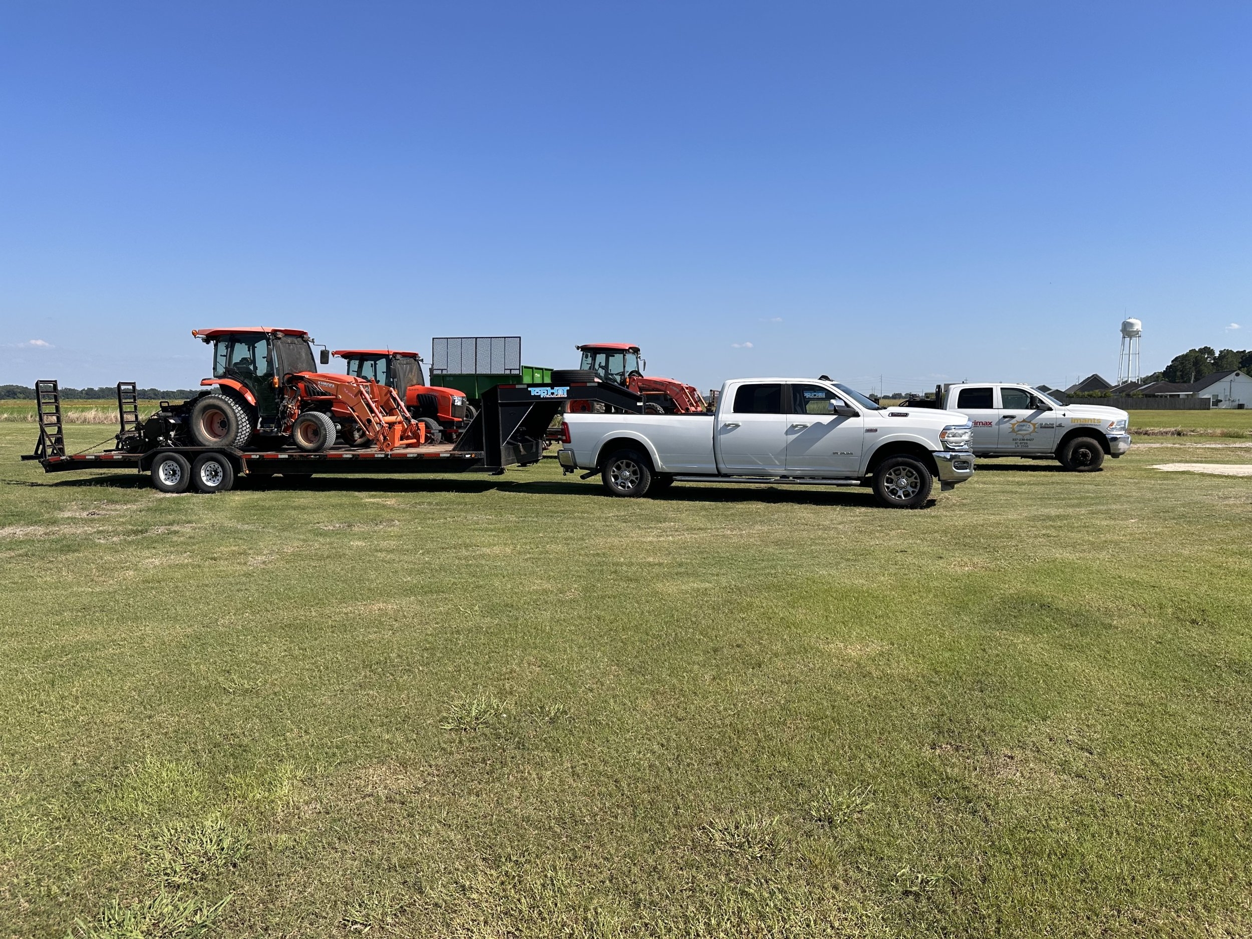

Ya'll all loaded and geared up to get it done, hopefully the weather will cooperate.

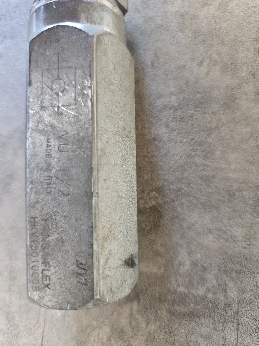

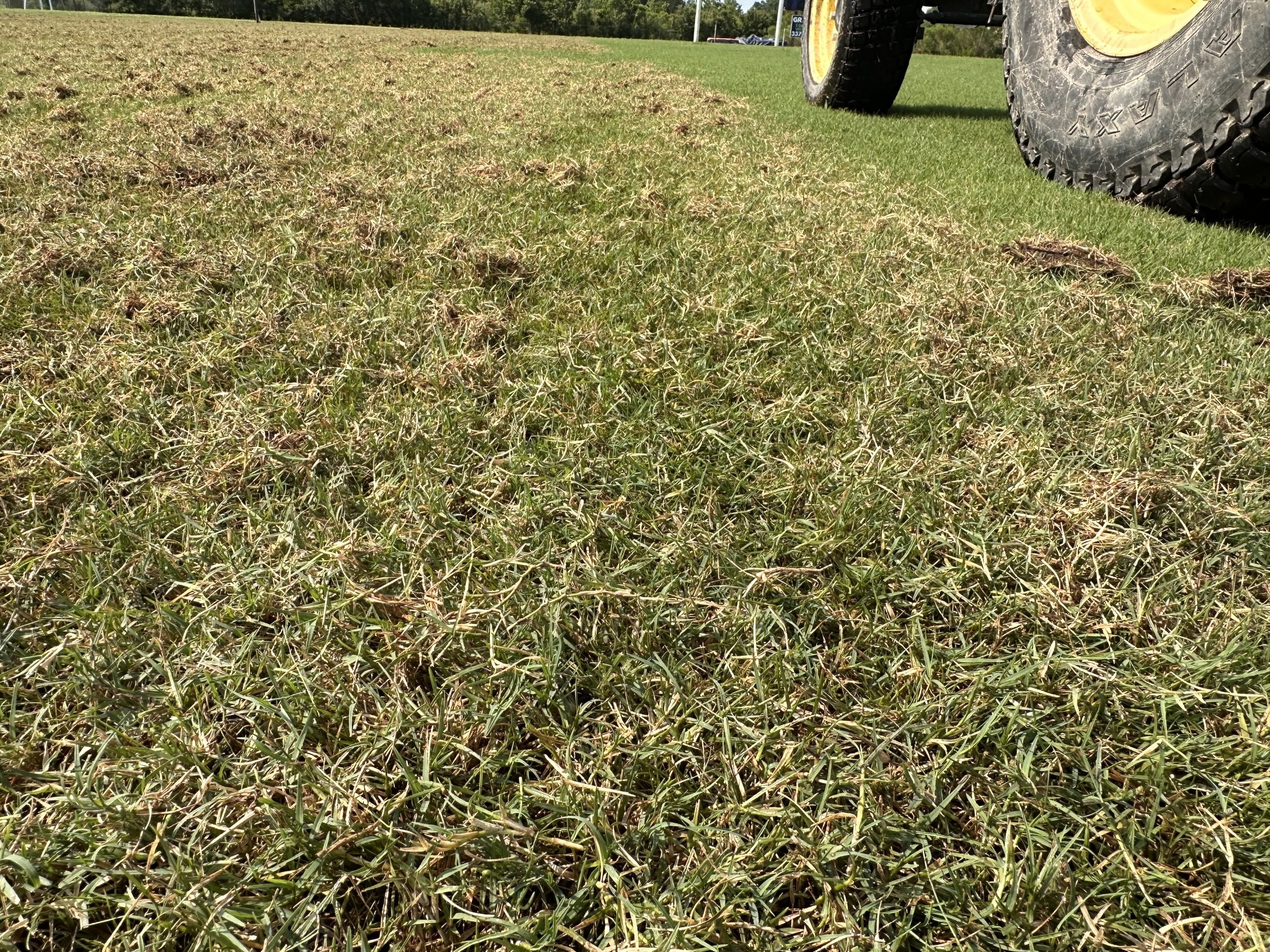

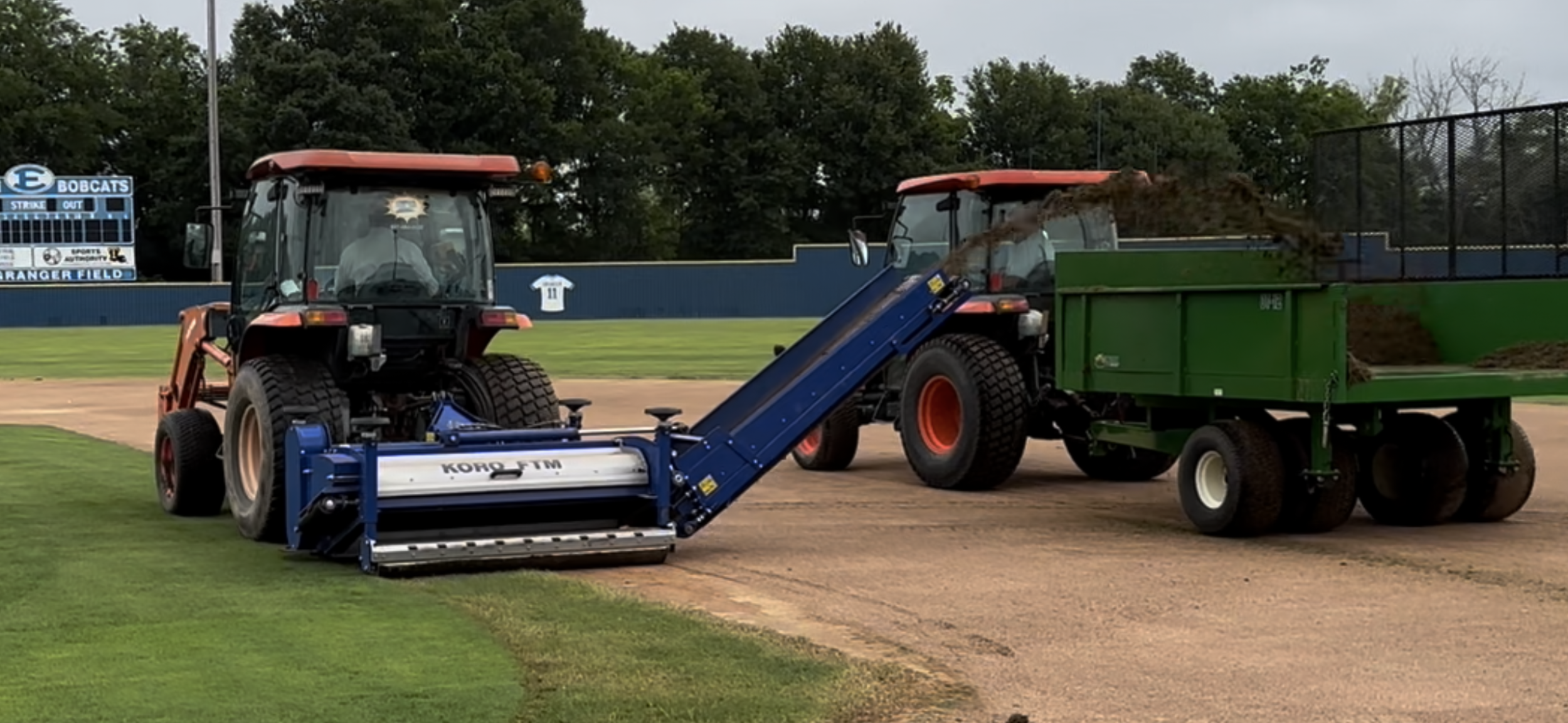

We should be able to finish this job tomorrow. We aerated the field today and were supposed to remove the lips around the skinned area, but had trouble with the lip removal machine.
There is a check valve in the hydraulic hose that turns the hydraulic motors on the conveyer belts. That check valve must have gone bad, because we took it out and now the belts turn.
We also have 5 loads of sand to spread on this field.
The rain is scheduled to start Sunday, but I think we can finish this job tomorrow.

What are "lips"?

Lips are a hump or bump that develops over time in the grass area right next to the skinned area. Sort of like a small levee. This can cause a ground ball to bounce erratically or even cause a twisted ankle.

On this job, we had 3 tractors, 3 trucks, a skid steer, 3 trailers, and several attachments.
I figured that’s about $400,000 worth of equipment. That’s why I charged just over $12,000 for about 2 days work.
