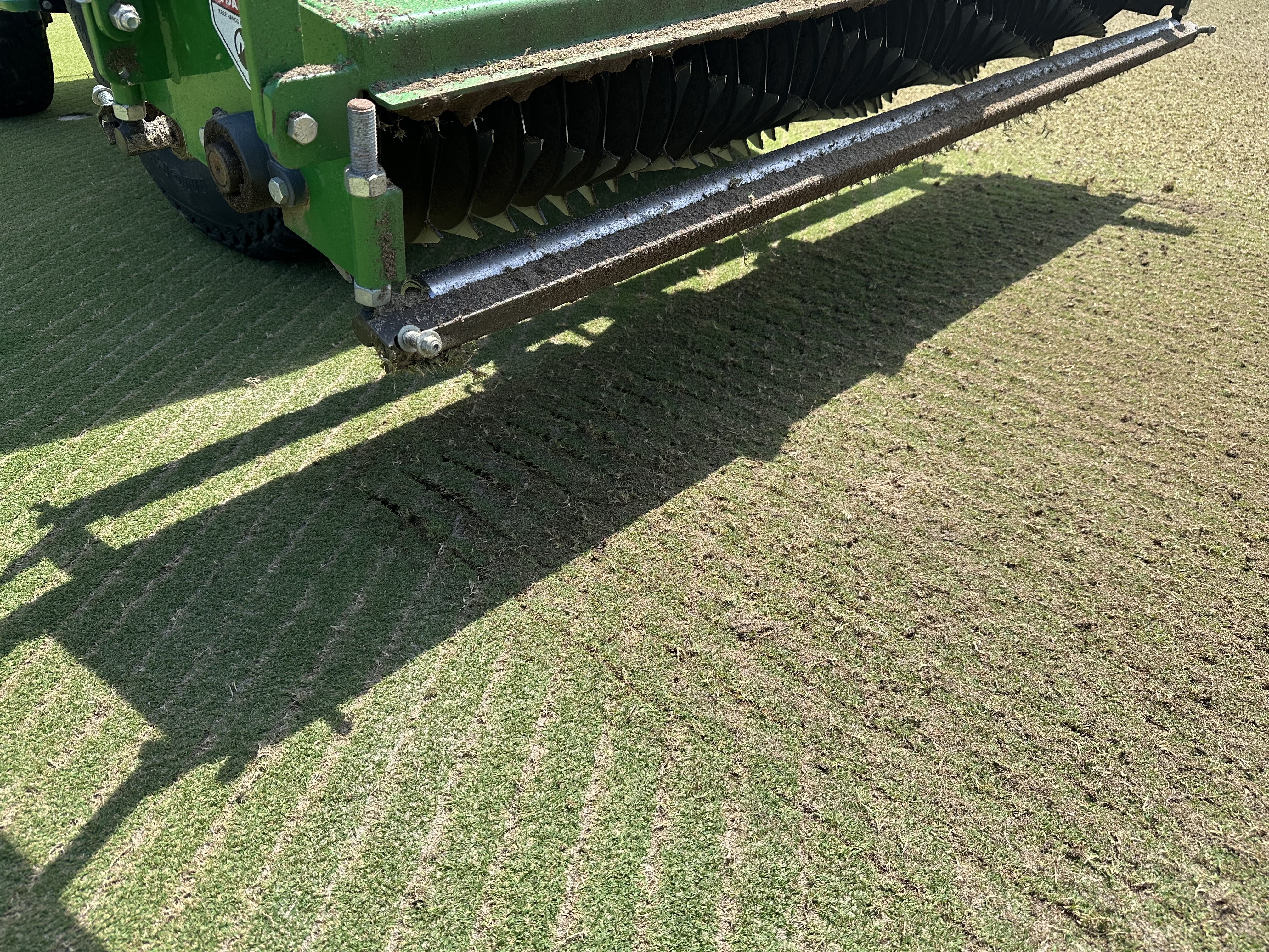

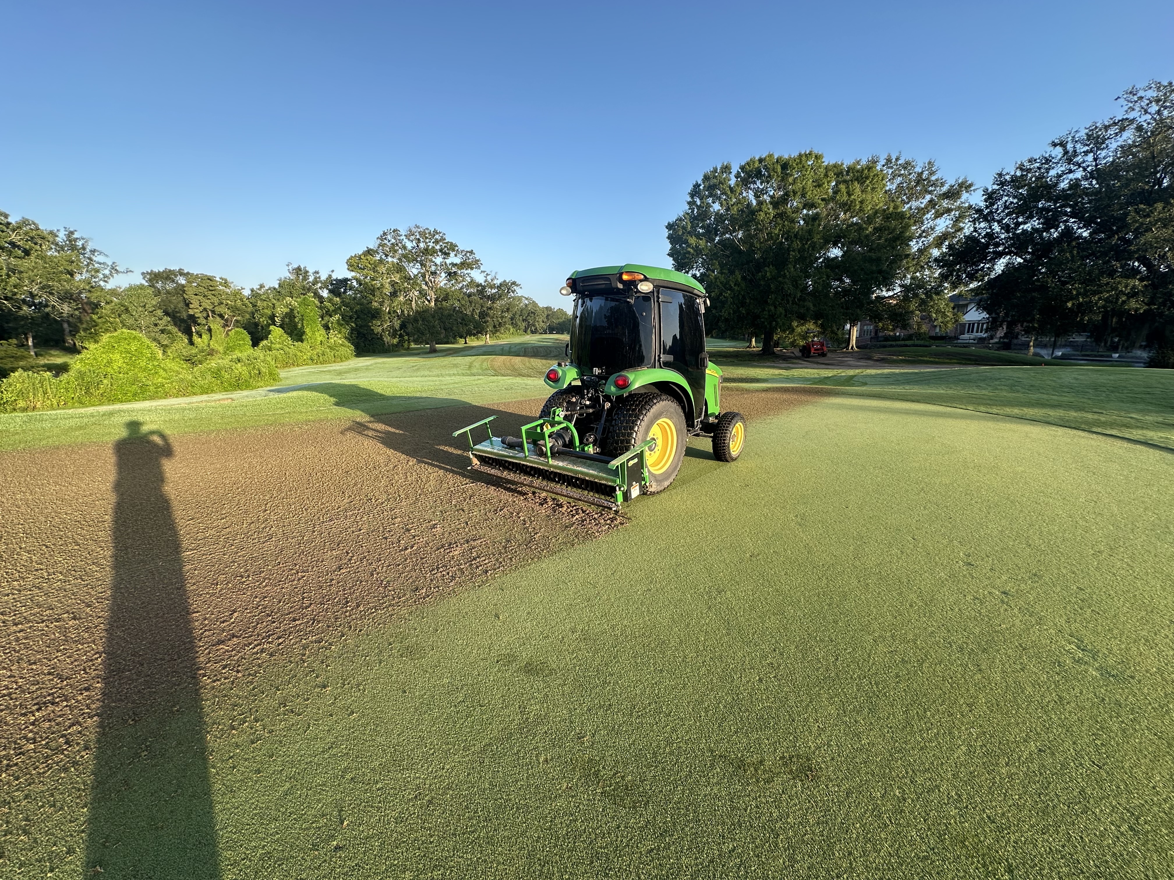

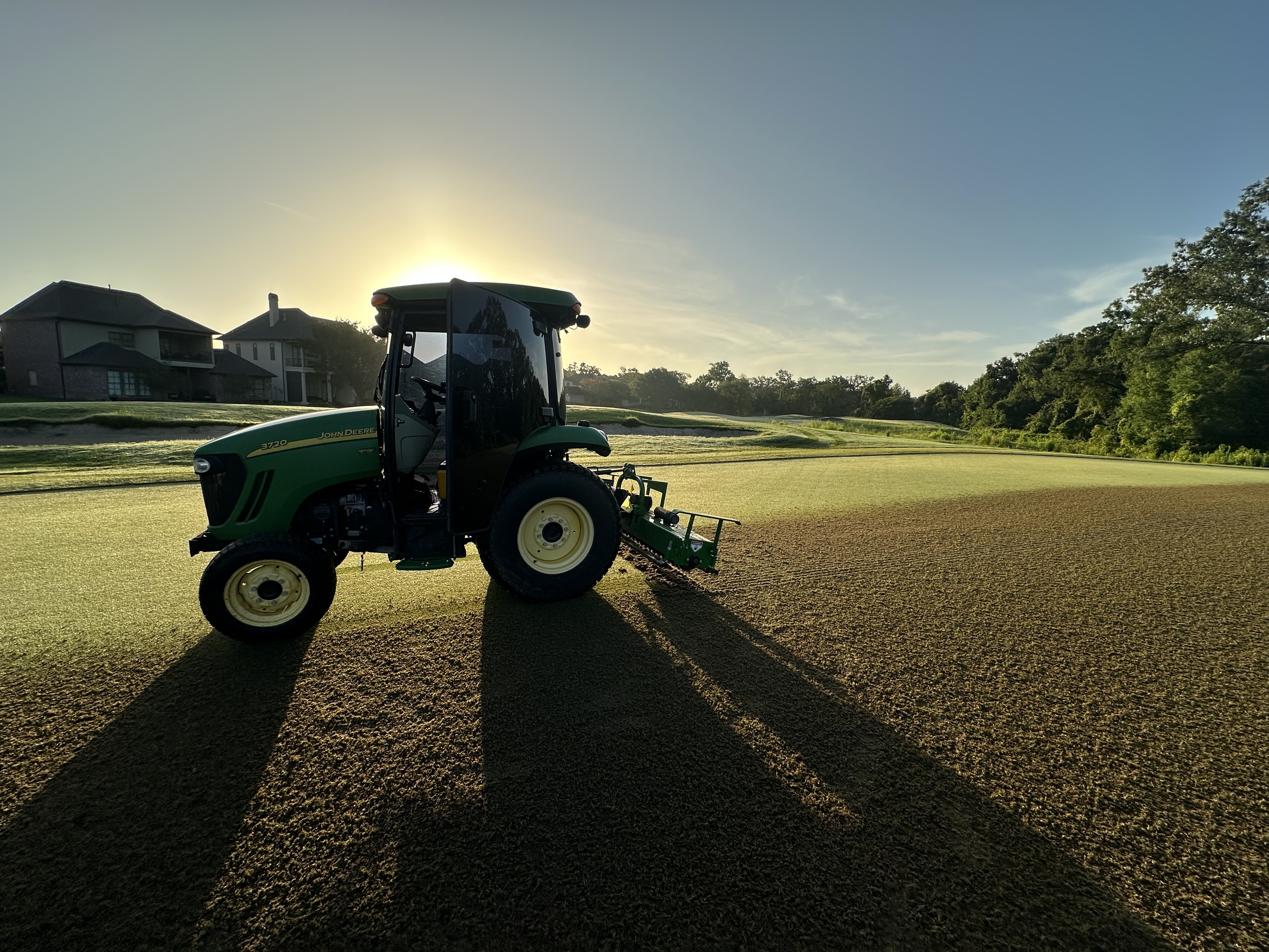

Spent the last 2 days verticutting greens at a nice golf course in Baton Rouge.
Golf maintenance starts at 5am every morning, so I had to leave my shop at 4am to get there by around 5:30 and get started at first light.
We cut in one direction first, then they came behind me and cleaned up. Then I cut at about a 45 degree angle on the second cut.

What does that do for the grass?
   / Pictures from an athletic field contractor
#334
It stimulates new growth, it removes some thatch, and it brings up some sand and re-deposits it on top, which is topdressing. Topdressing also helps manage thatch.
The golfers won't be happy until it grows back in a couple of weeks

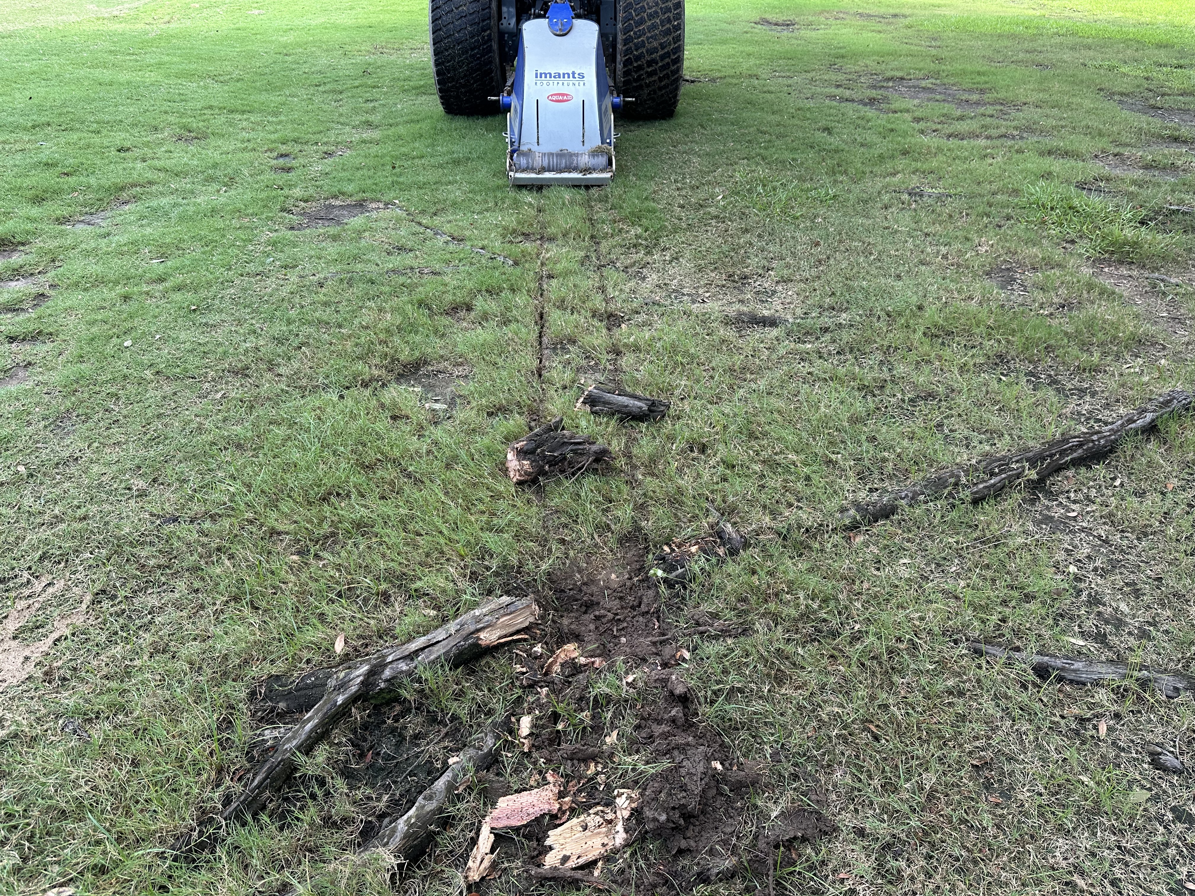

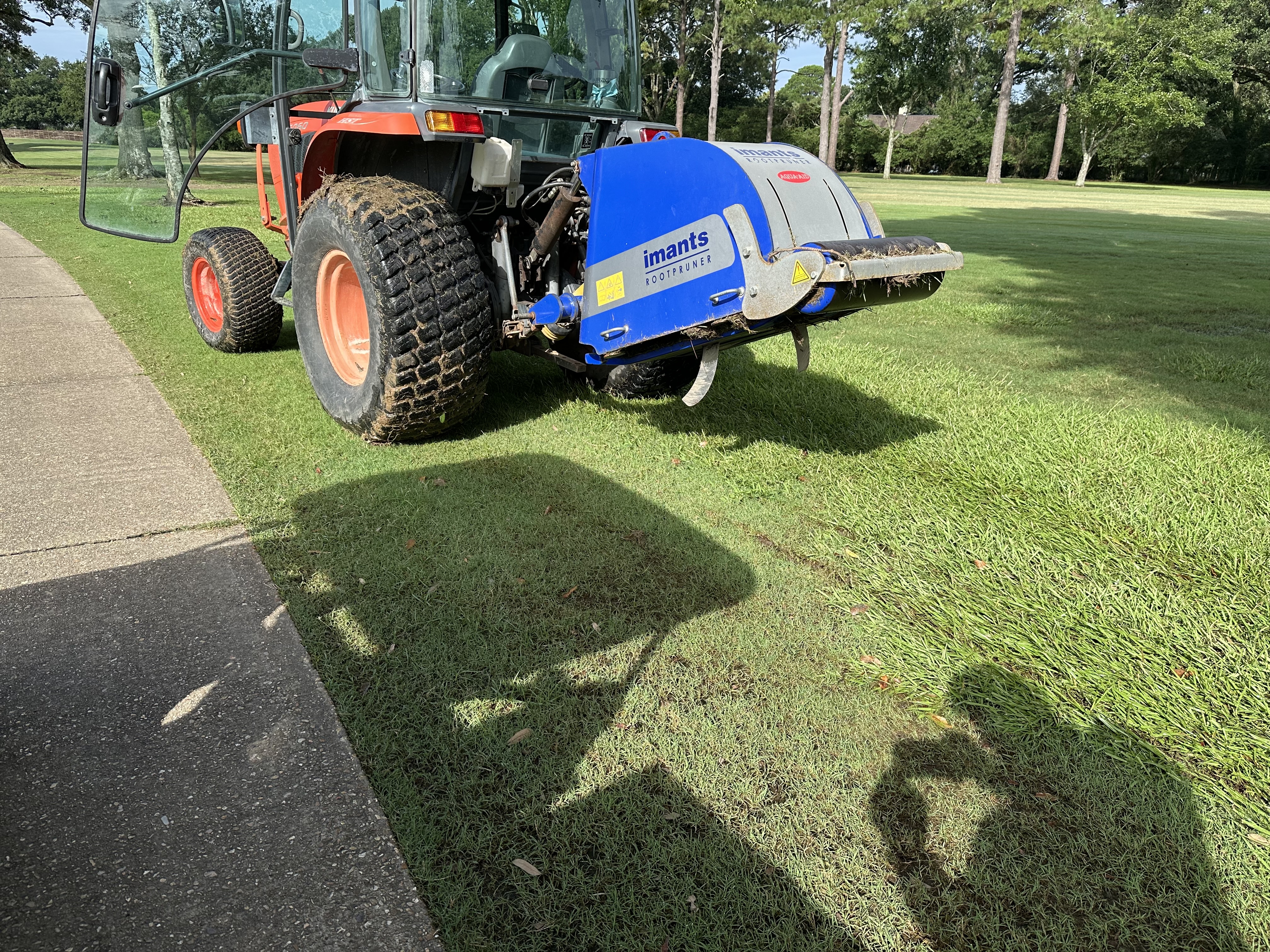

Something a little different today. This is a root pruning machine. We use it on golf courses to prune the tree roots along the fairways so that the trees don't steal the moisture and nutrients from the grass in the fairways.
It will cut roots up to about 4-5" diameter. It will rock your world when you hit a big root
