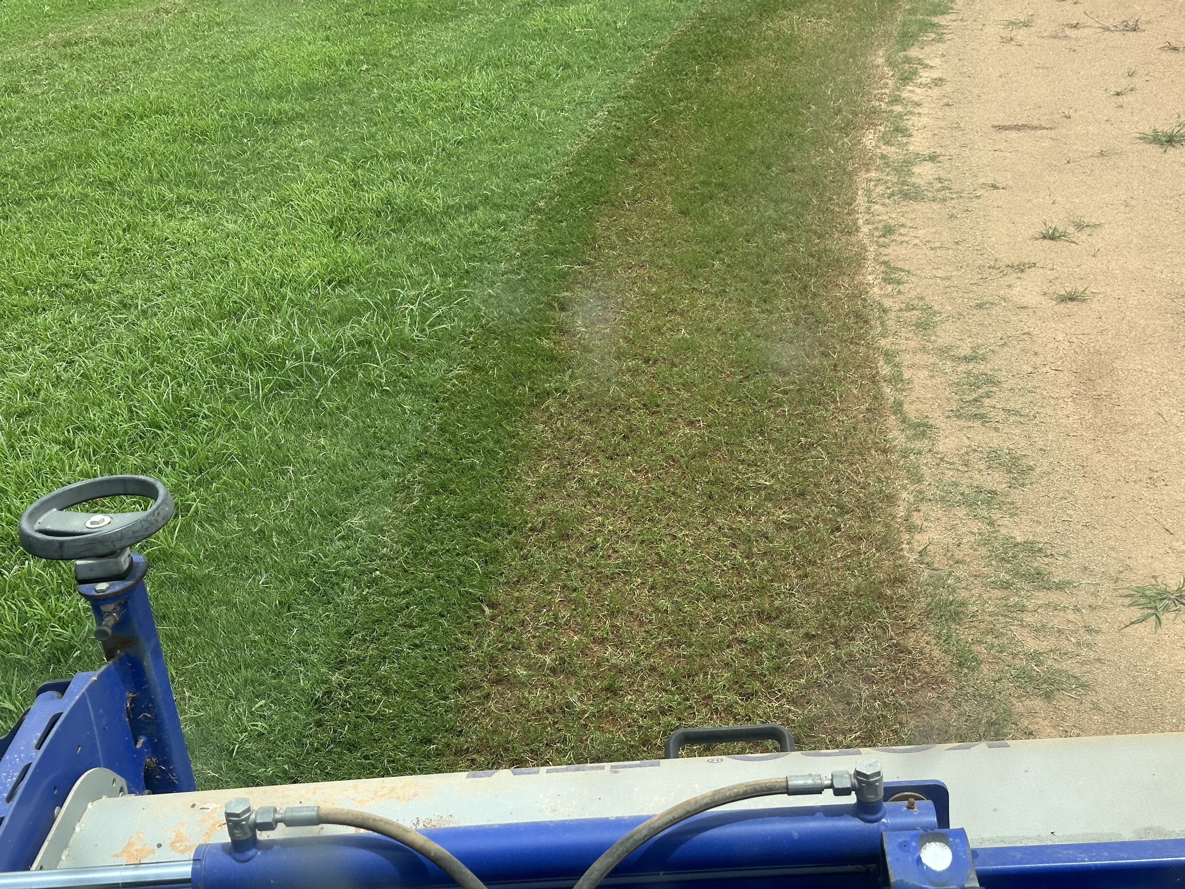

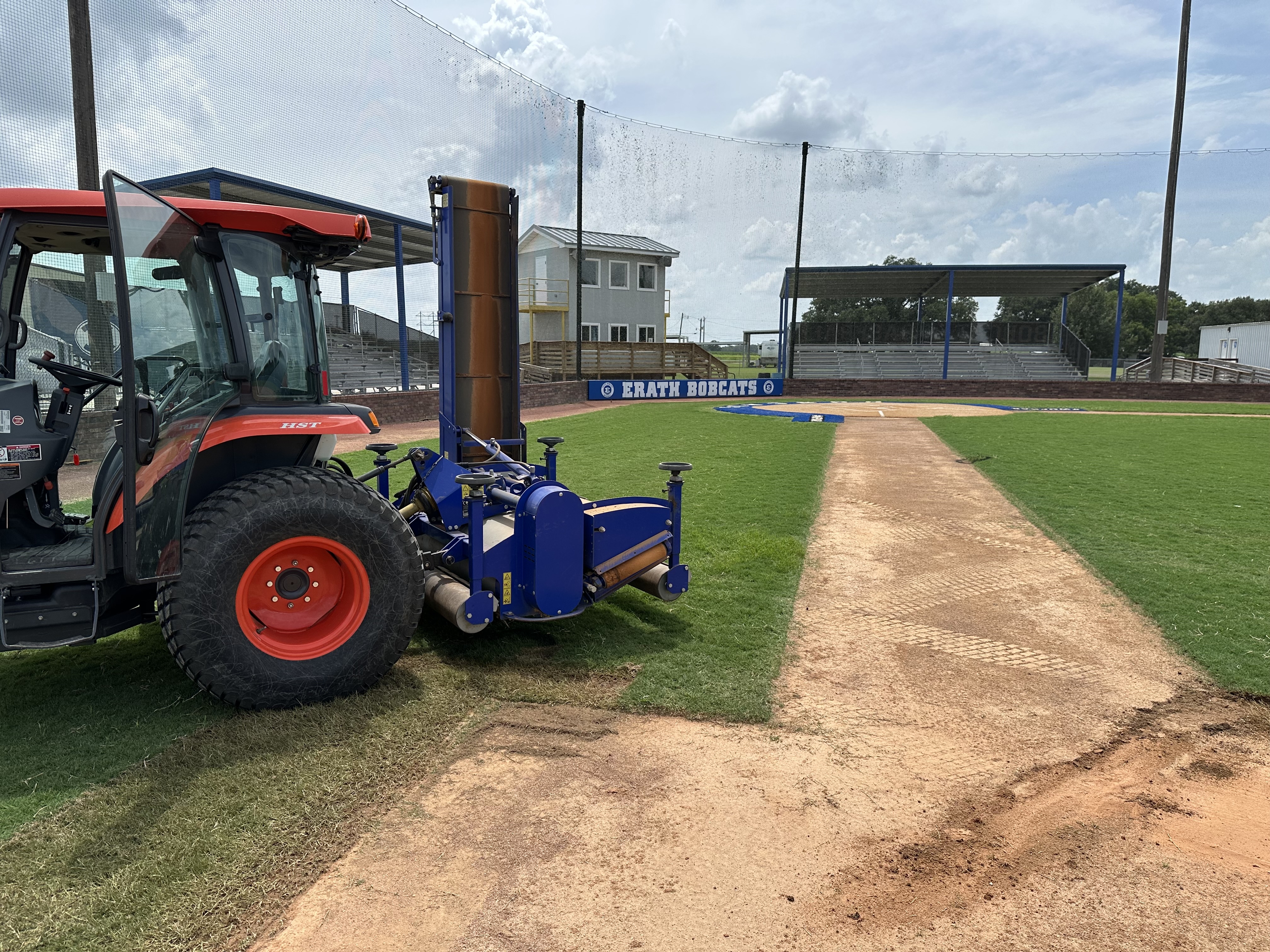

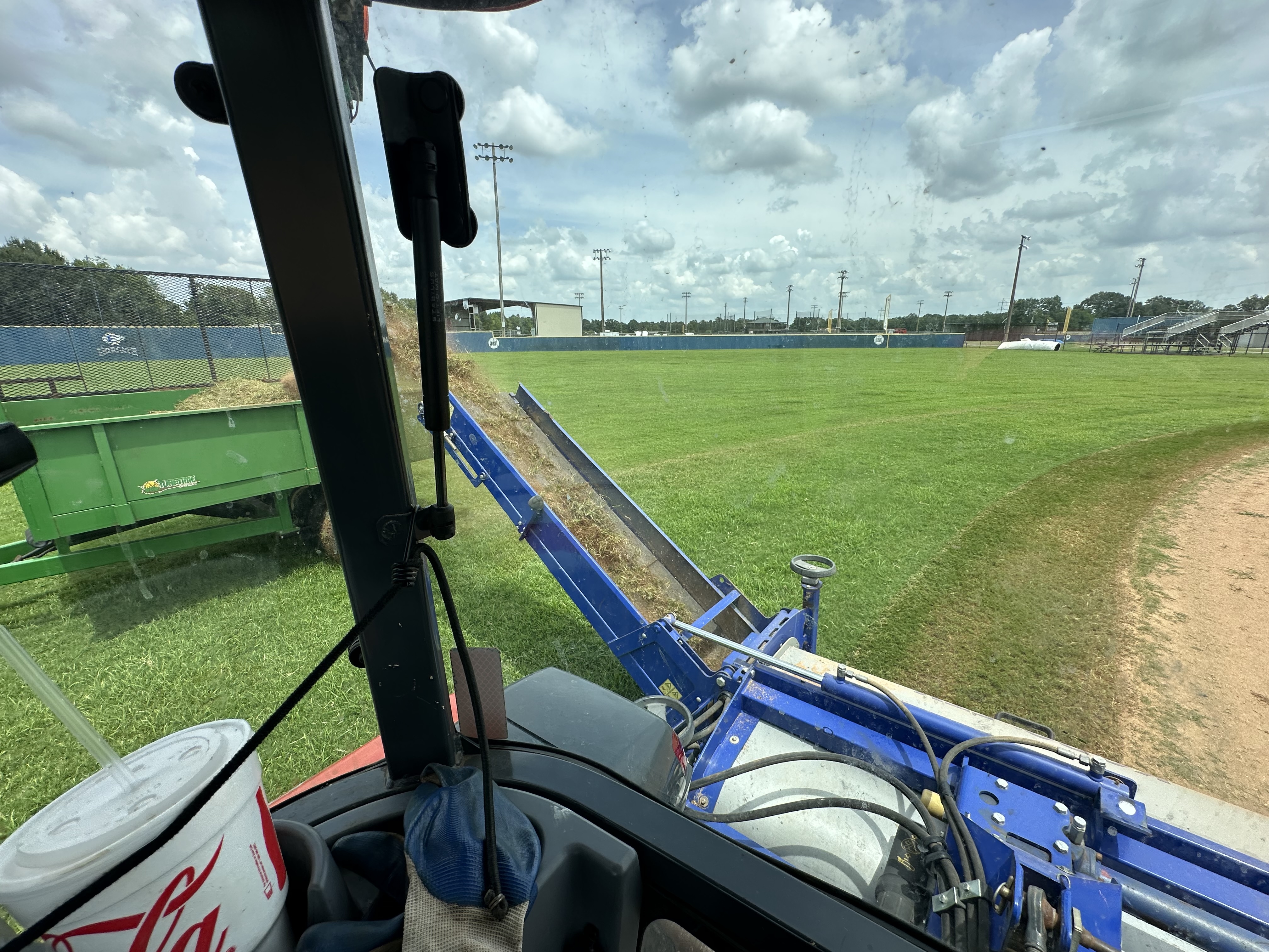

Do you sprig other places with the lip removal scrap you haul off?
   / Pictures from an athletic field contractor
#312
I have never done that. But, it could be done. The material we remove from the lips is often mostly soil and not so much grass.
However, the machine we use for lip removal can be used to harvest sprigs to be planted. I've just never used it that way.

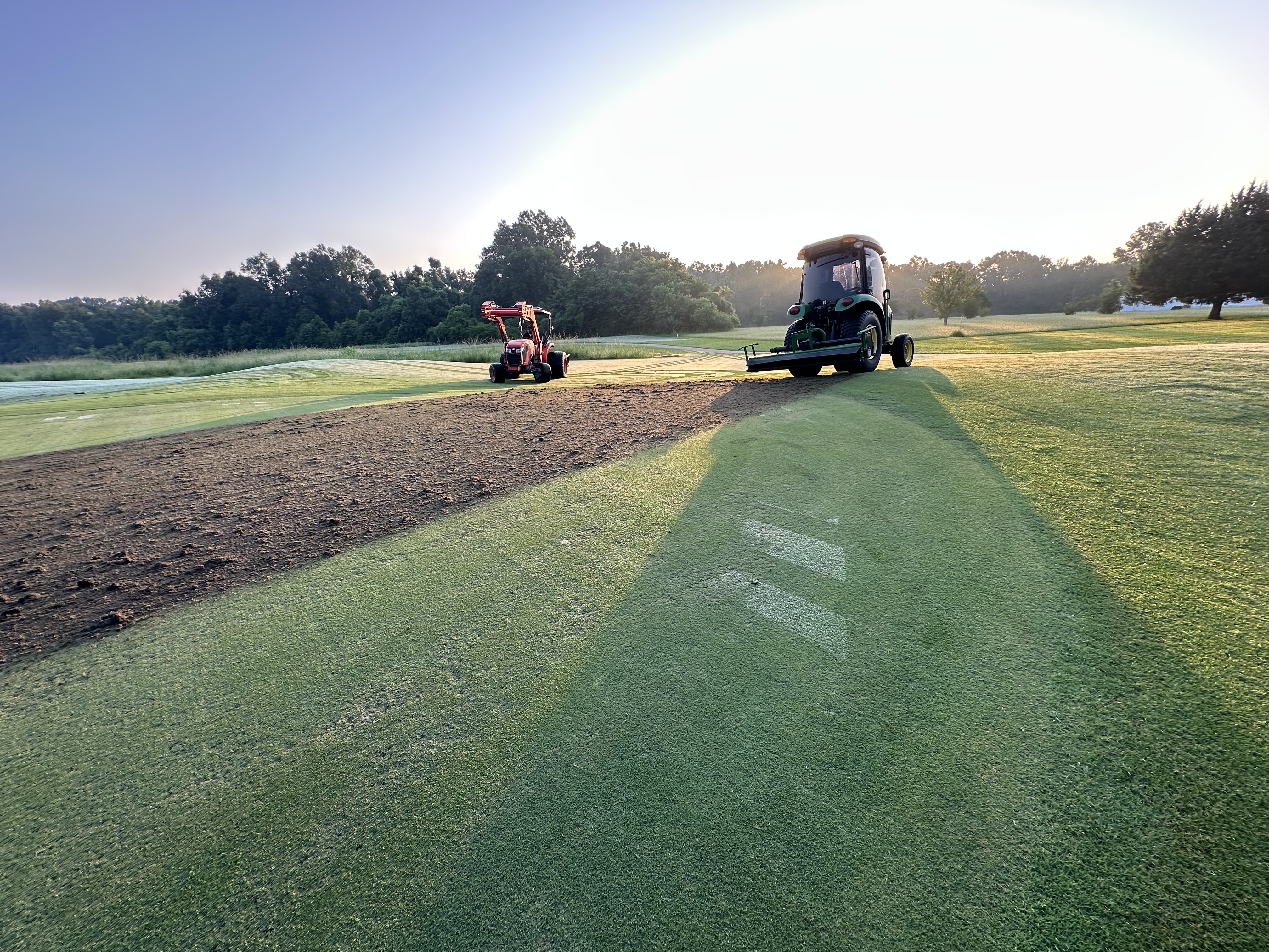

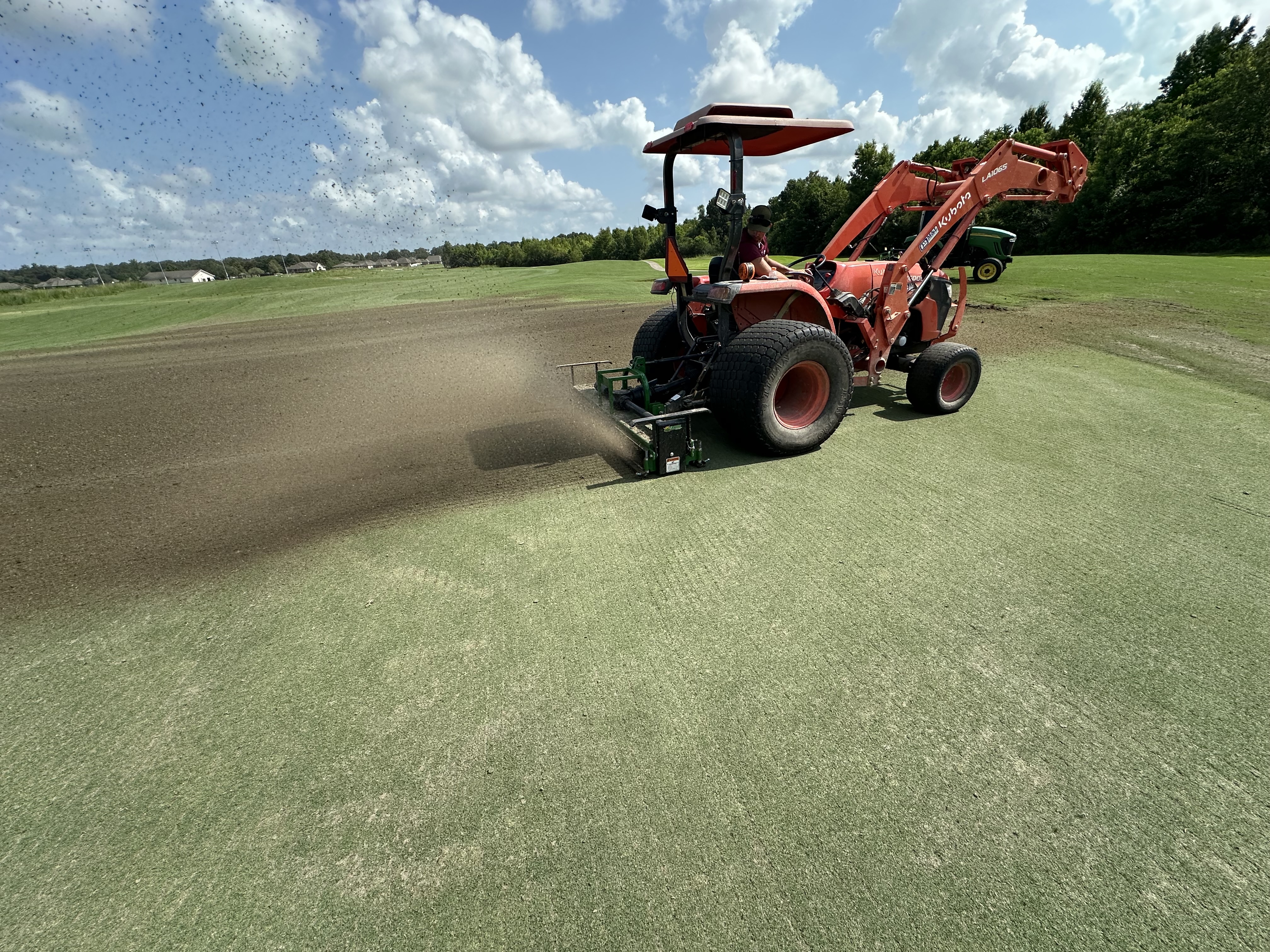

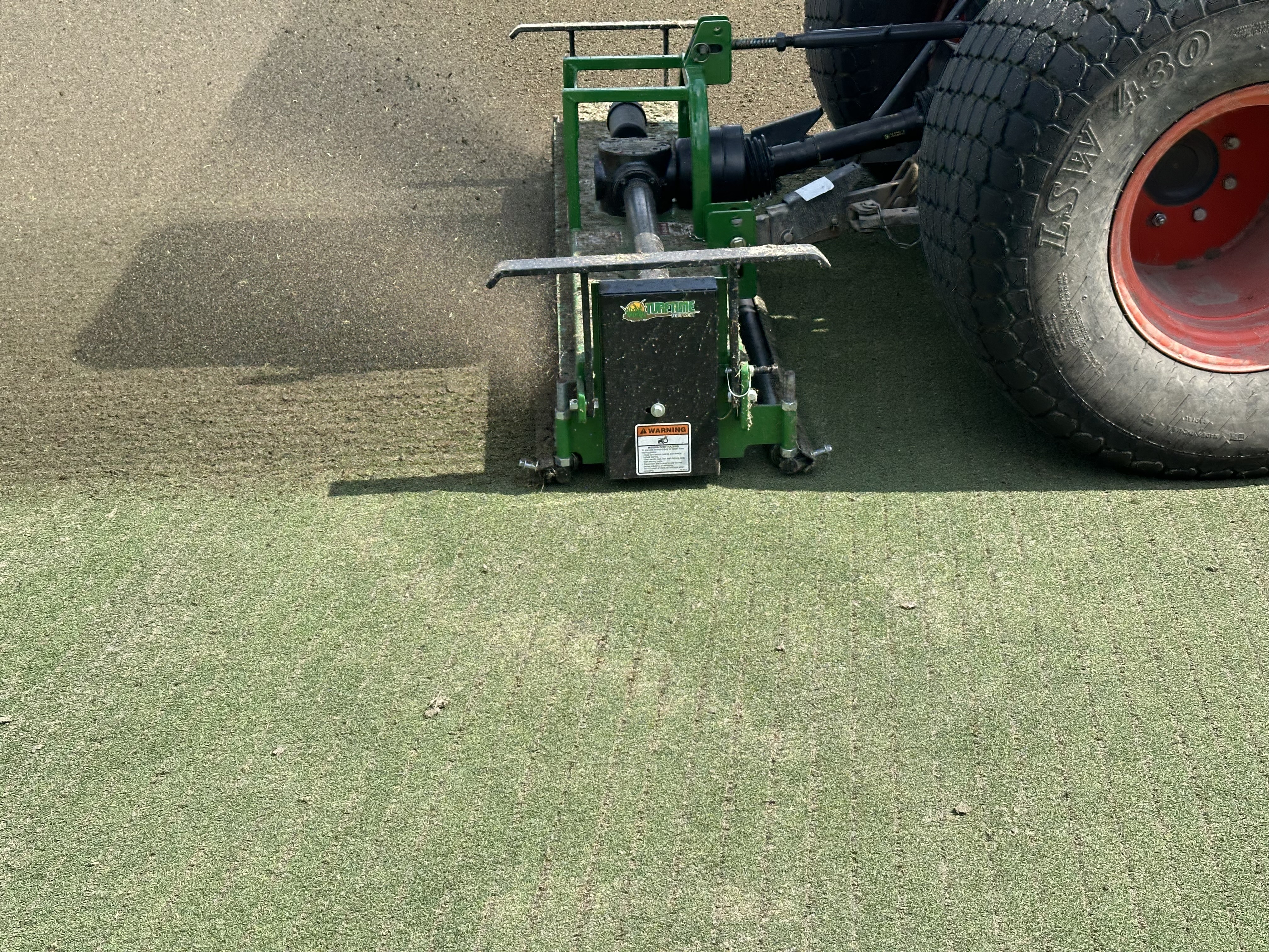

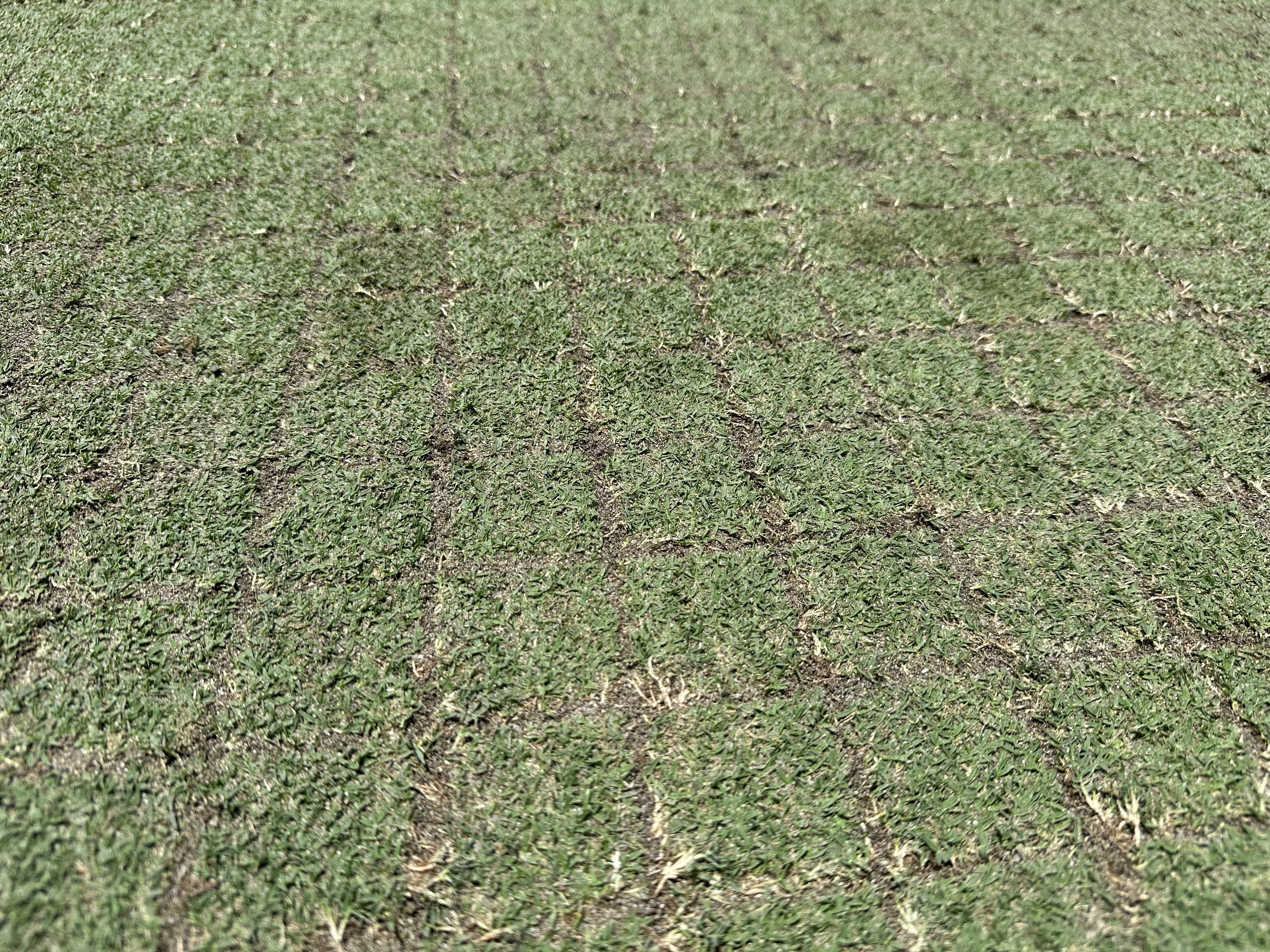

Today we did some verticutting on golf course greens. We ran the machines in two directions.
This is what it looks like after it's cleaned up. Tomorrow they will topdress (add sand) these greens

I don't do a lot of work on golf courses. They do have tons of equipment.
The reason they wanted me there today, is so that we could get most, if not all, of the course done in one day today. The course is closed on Monday's, so we could work without bothering, or being bothered by golfers.
The verticutter you see on the Kubota is one I sold them last year. And I have one on my John Deere. This was at one of Baton Rouge Recreation (aka BREC) four golf courses. I have 2 more to do in the next weeks.

Does the lip just build up because of how they mow the grass?
#320
It's a combination of things that cause the lip. One of the biggest reasons is because they drag the infield before almost every time they use it. Since they drag in a circular pattern, this will sling some of the infield soil into the grass. Another reason is that the grass just grows and thatch builds up. The grass doesn't grow in the skinned area. And you have players kicking the dirt out as they play, and wind will blow it out into the grass.
