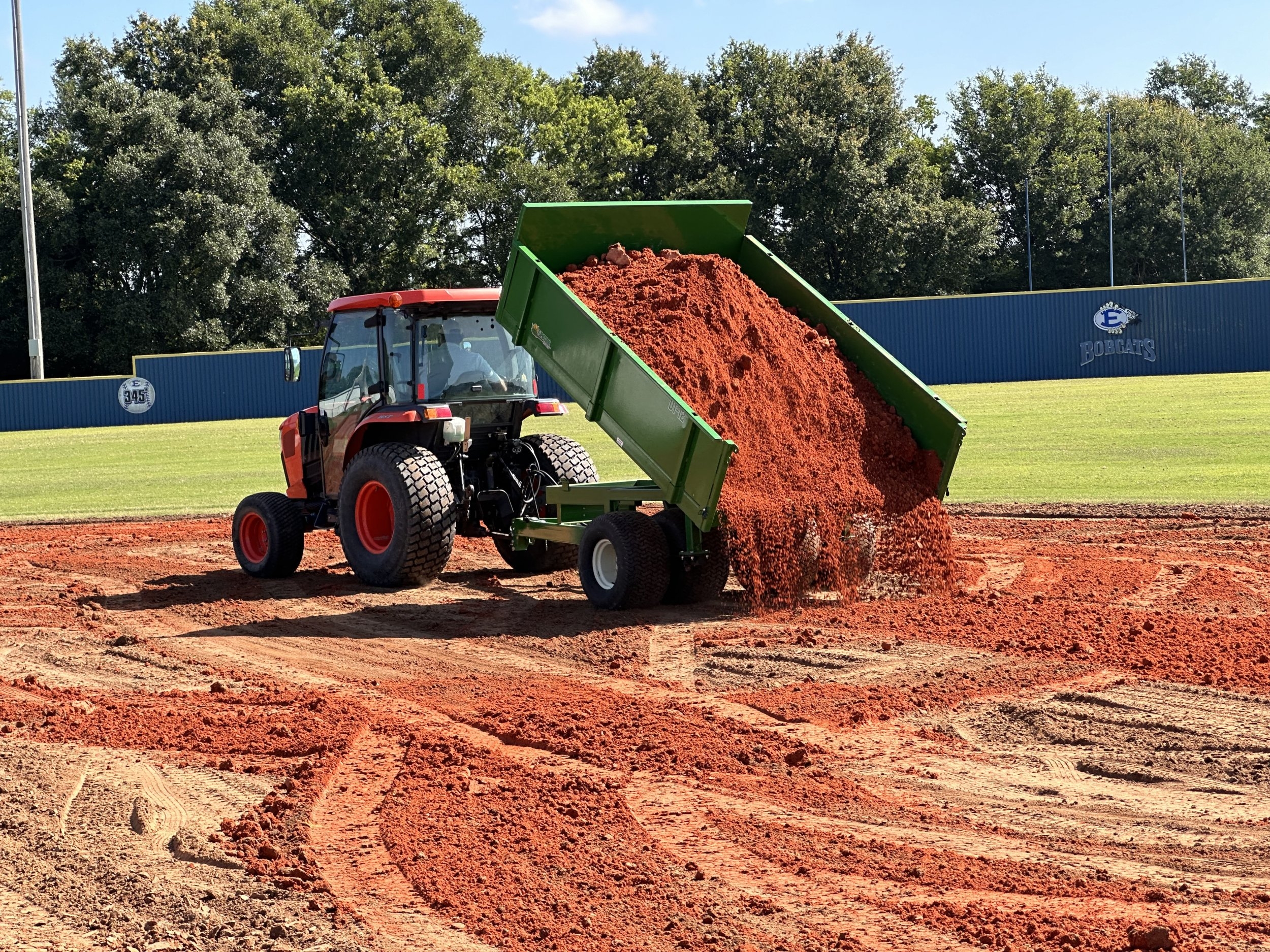

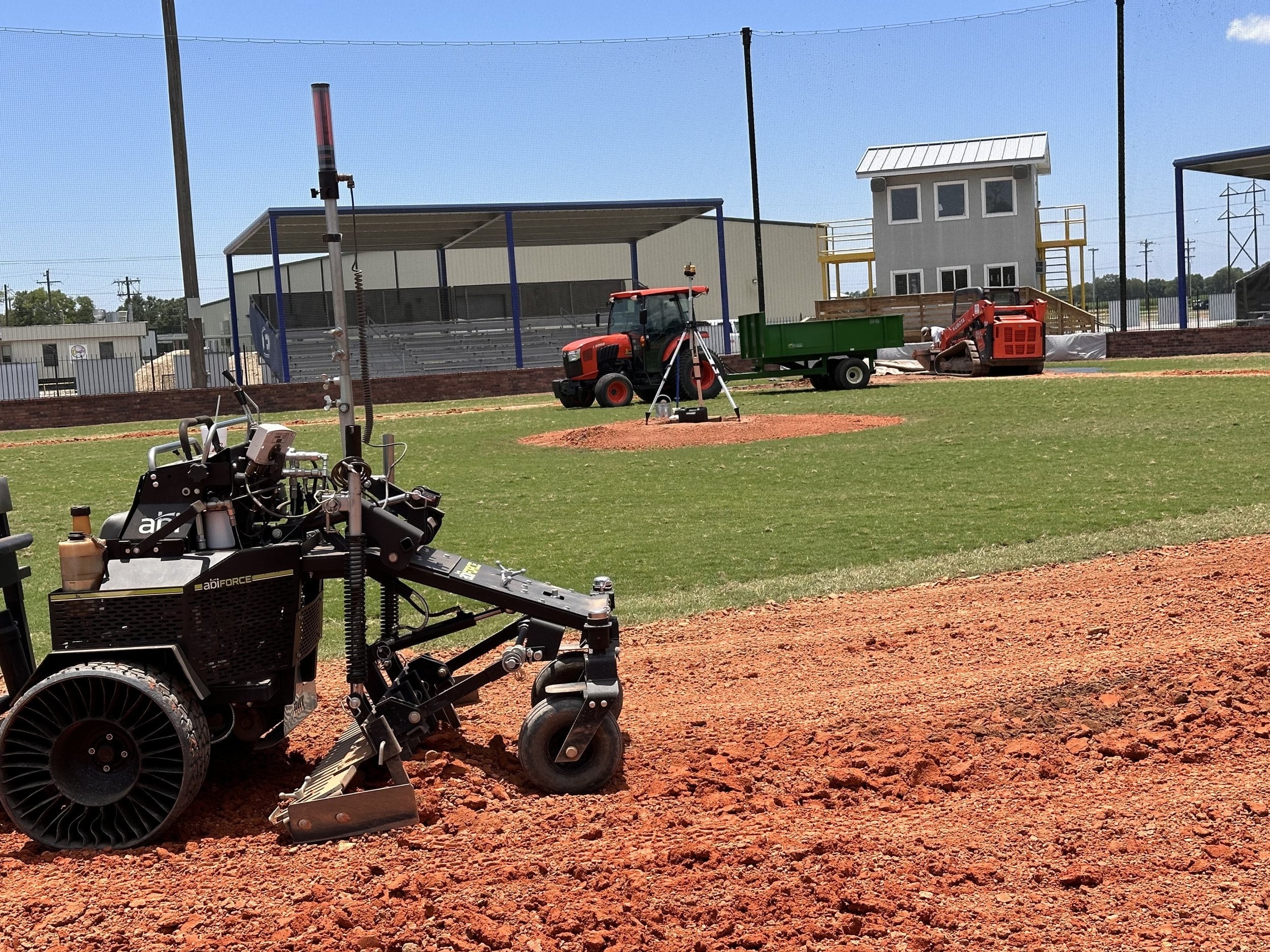

Added 2 loads on infield clay mix and laser graded the skinned area today.

I bet that transit takes all the guess work out of grading.
It's the only way to do a good grade. This transmitter is actually a 'cone' laser. I use it on baseball and softball fields. When doing a football field, I'll use my dual slope laser.
The only other way to do it would be with a GPS guided system. But, those are about $80,000 last time I checked. Thats what you see on dozers building roads and such.

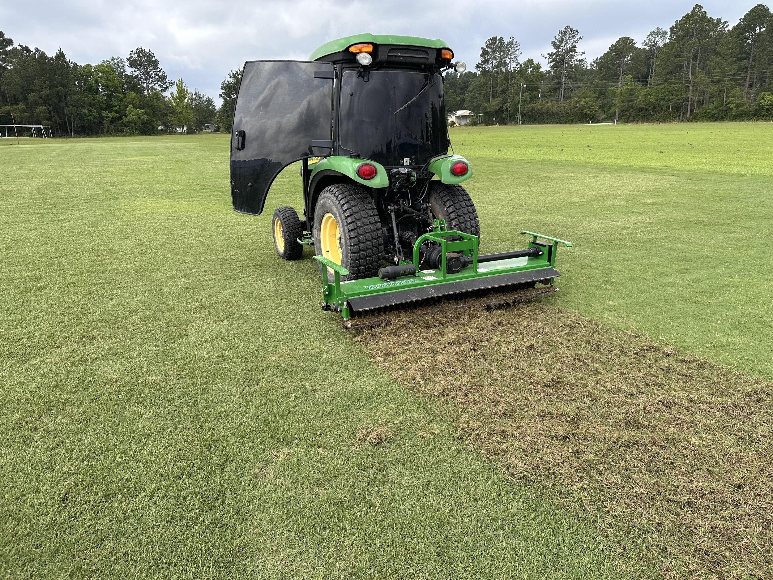

Verticutting today at a high school football field. Sorry I didn’t get more pictures, but the tractor was having some issues
