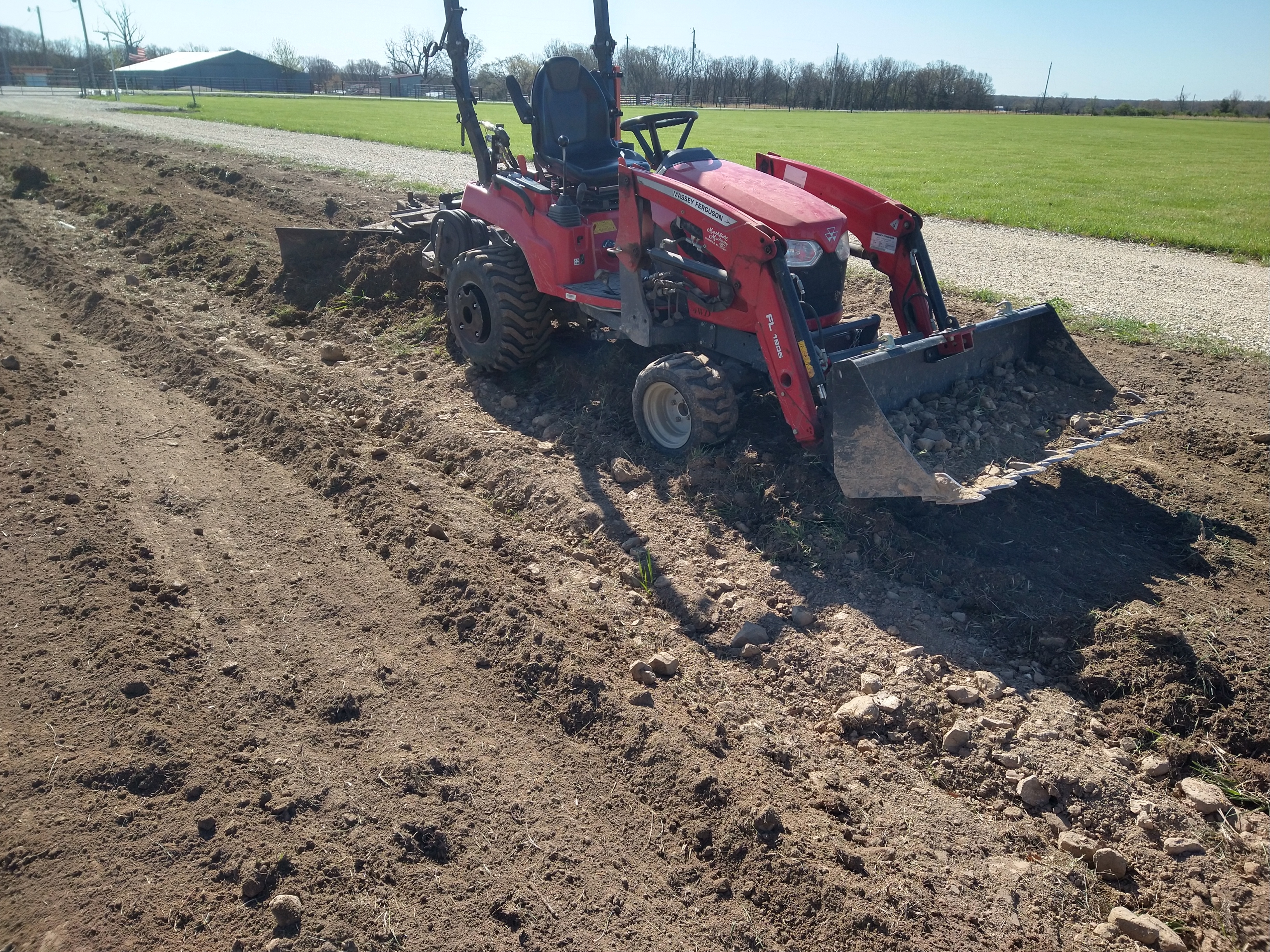

The problem I found with a rear blade was traction ... While I have a very old HEAVY (396.4 Lbs!) Cat 1/2 rear blade ... I found I could easily loose TRACTION once it got full ... Rear tires filled, 4X4, rear axle locked, as far as I could go, three tires spinning ... Notice I added gravel to the bucket too ...
Added the 70 Lb steel wheel weights to each side, plus another 200 Lbs of steel weight lifting plates to the BH frame, since have added another 75 Lbs ...
Now it has TRACTION! I stopped, and was able to start again, no spinning!
Once you drop a rear blade or box blade on the ground, you no longer have the advantage of that weight on the tractor for TRACTION!

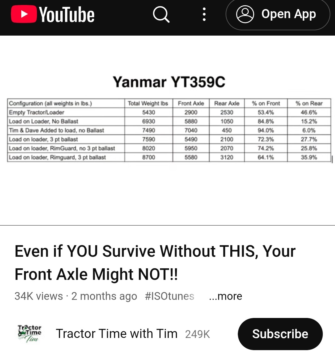

I'd recommend re-considering such a light attachment on the back for rear BALLAST.
Think about if you were to buy your tractor as a TLB package ... How much does your BH weigh? As it's difficult to add more weight, that's about where I want to start to relieve the front axle of over weight.
The rear filled tires don't help in that regard, just helps traction ...
Here is a screenshot from that video ...

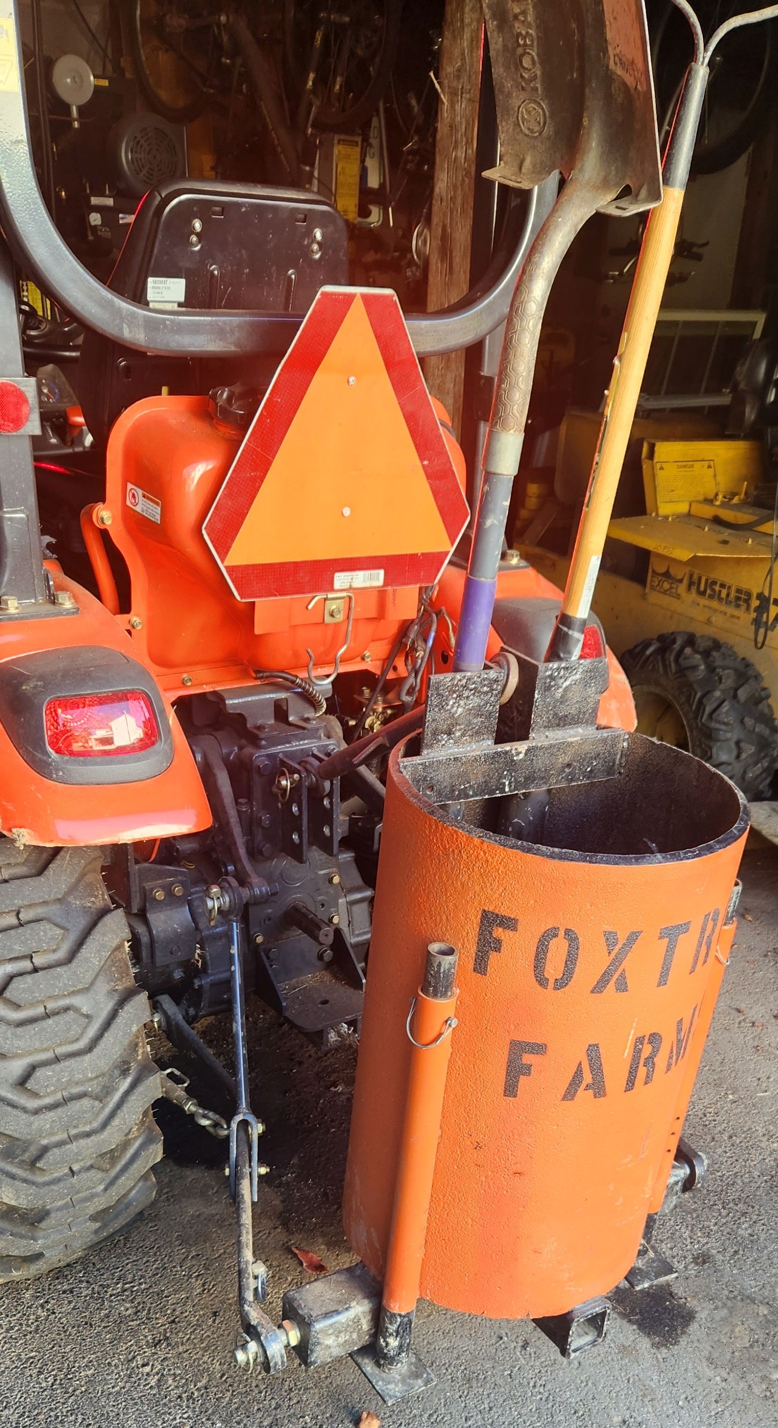

Howdy everyone trying to get ideas on making a rear weight for my 1705 MF tractor. I would love to see some!!
Here is what I did. Note, the featured this in an FarmShow issue a few years back. All the ballast boxes I looked at had major flaws. On some the 3-pt hitch has to be raised when they’re installed, which puts constant strain on all hitch components and also raises the tractor’s center of gravity. Others are so large they’ll scrape the ground as you drive up an incline, or they’re in the way when you have to navigate tight spaces.
I started with a 2-ft. long, 16-in. dia.. 3/4-in. thick sewer pipe. Then welded the pipe onto a homemade, 3-pt. mounted bracket with an expanded metal floor, as well as a ball hitch on back and 3 welded-on, homemade jacks. Each jack consists of a pipe that rides inside a larger 1 1/2-in. dia. pipe. Both pipes have a series of holes in them, and the jack’s height can be easily adjusted by changing the position of a pin.
The sewer pipe weighs just 240 lbs. empty, but the tractor’s rear wheels are filled with ballast so I only needed a little more weight. If I need more weight, I can drop rocks or other heavy objects inside the pipe. By lowering the 3-pt. all the way, the ballast doesn’t interfere with the pto. To remove the ballast I just raise the 3-pt. and then drop the jacks to the ground.
I stores rakes and shovels in 2 vertical pipes mounted next to the 3-pt.’s top link. I leave the ball hitch and a toolbox inside the pipe all the time. There’s room for a 5-gal bucket inside the pipe to carry smaller items.

I believe Tim’s video shows that more is gained by weight on the 3PH overall. That’s my direction.

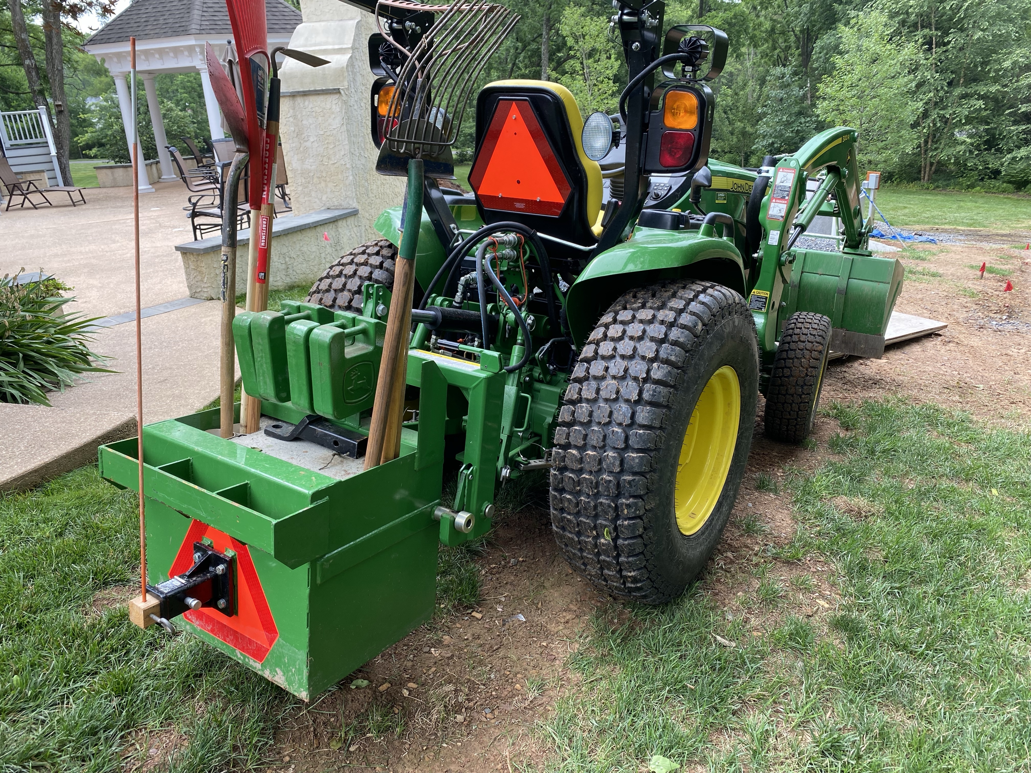

Probably on the 3 point lift

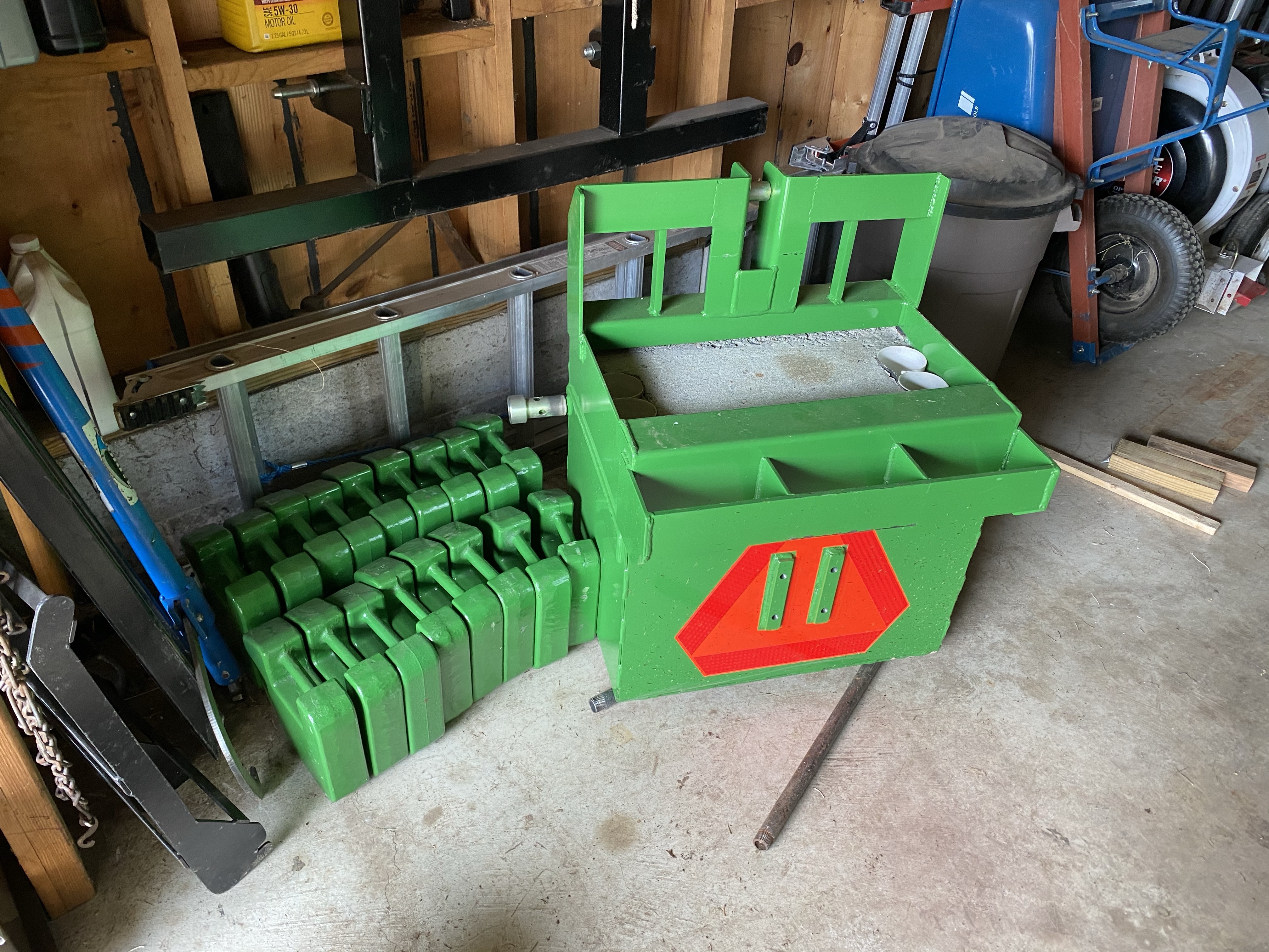

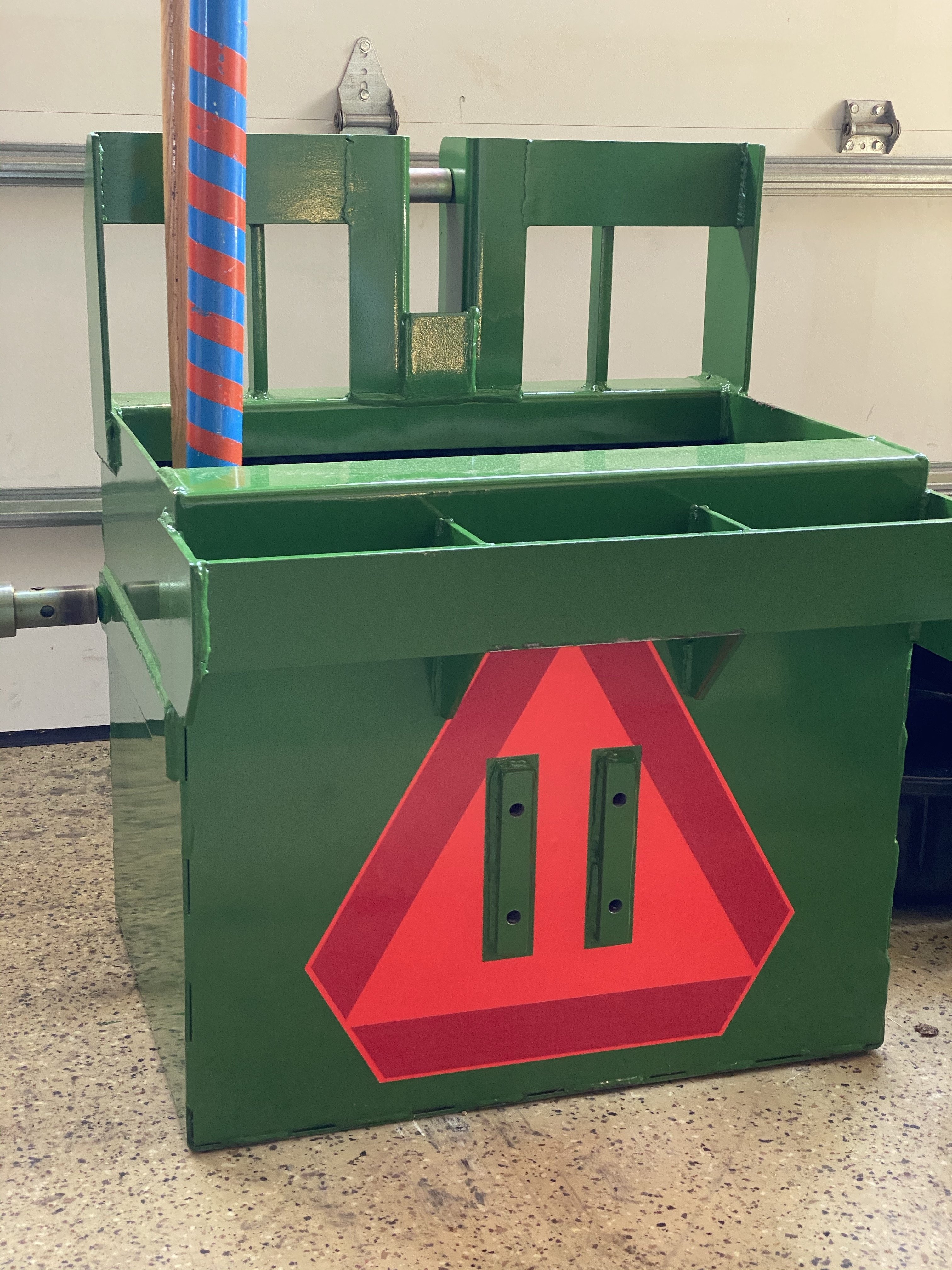

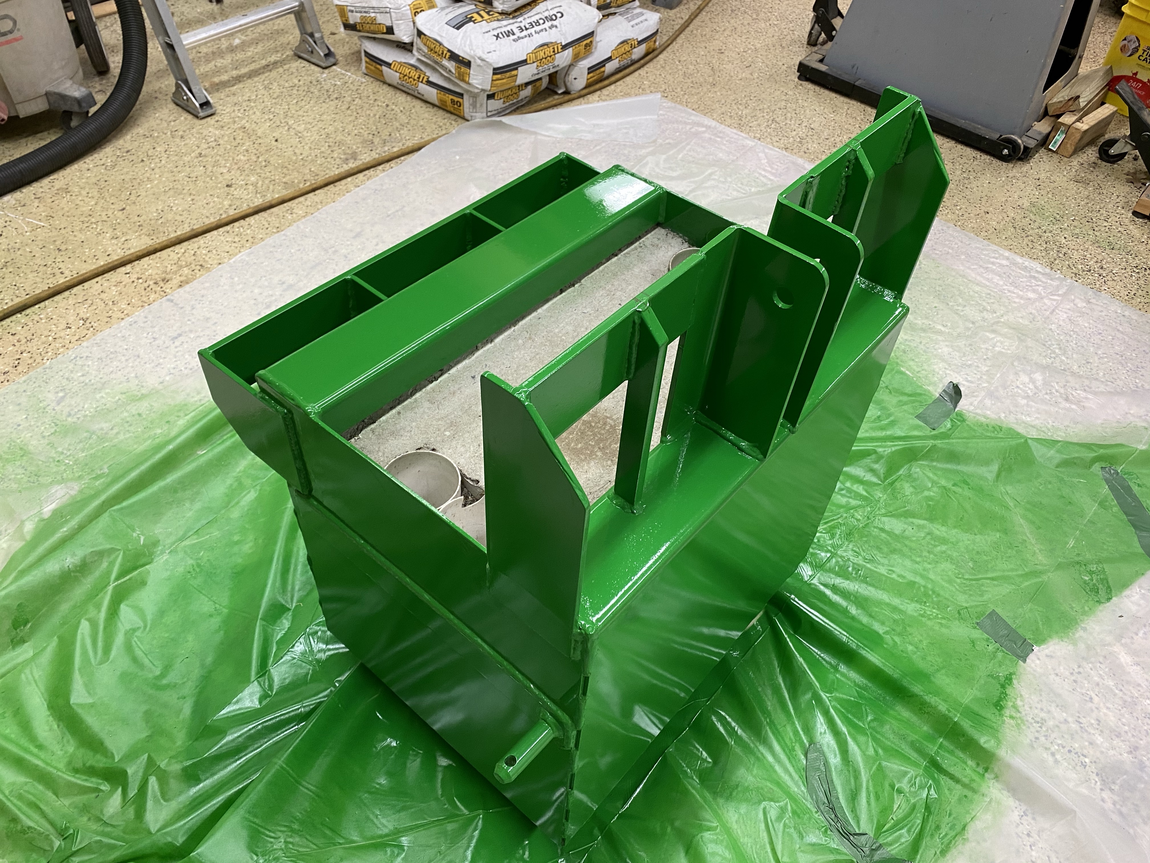

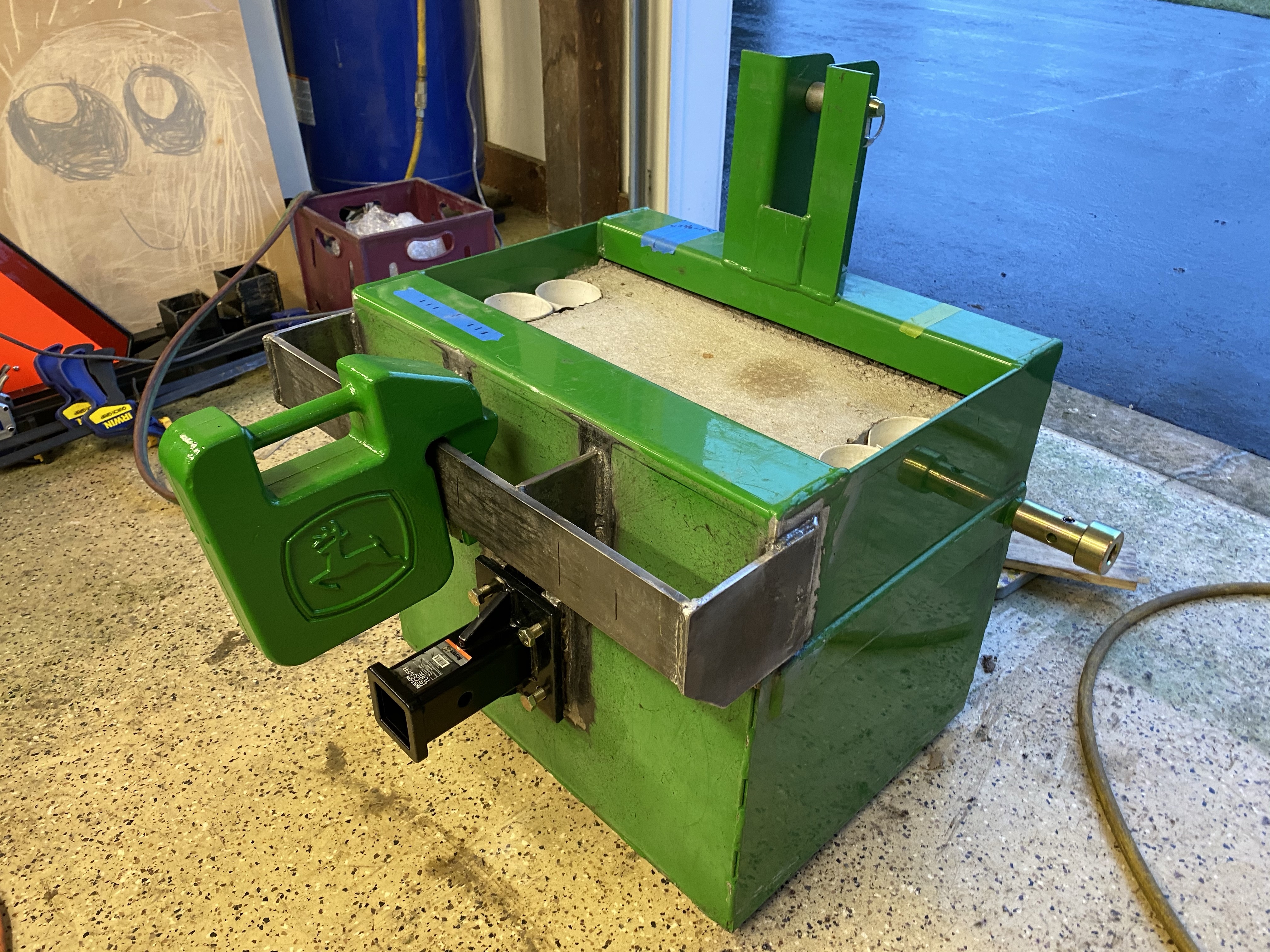

I took a standard 750 lb. ballast box, sunk four 3" PVC tubes into it to hold shovels and rakes before filling it with concrete, and added some weight-hanging bars to it so that I could add suitcase weights up to 1500 lb. I also left some space in the top tray to add chains, not so much for weight although they have that bonus effect, but because I often need chains.
I also welded some mounting plates on the back drilled and tapped to mount a hitch receiver, since I tow a lot of trailers with the box mounted.
