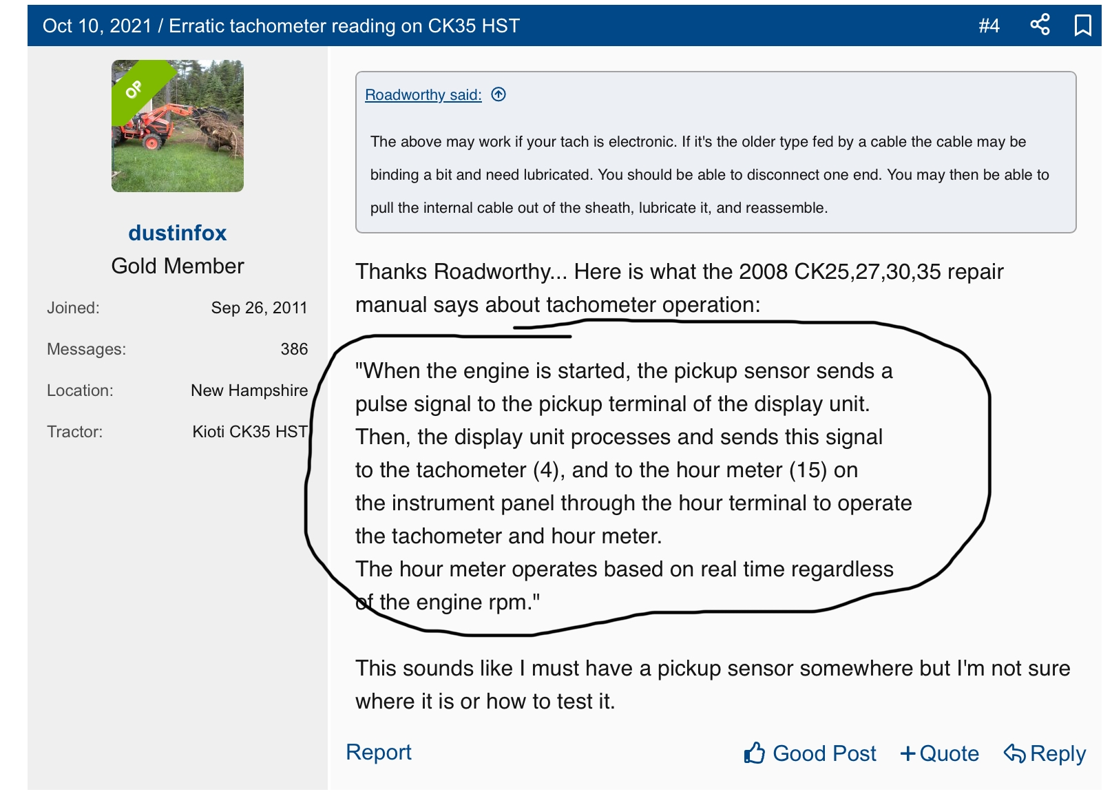

What is the purpose of a pickup sensor. I just noticed a broken wire to pickup sensor on my kioti ck25.

From another thread,
