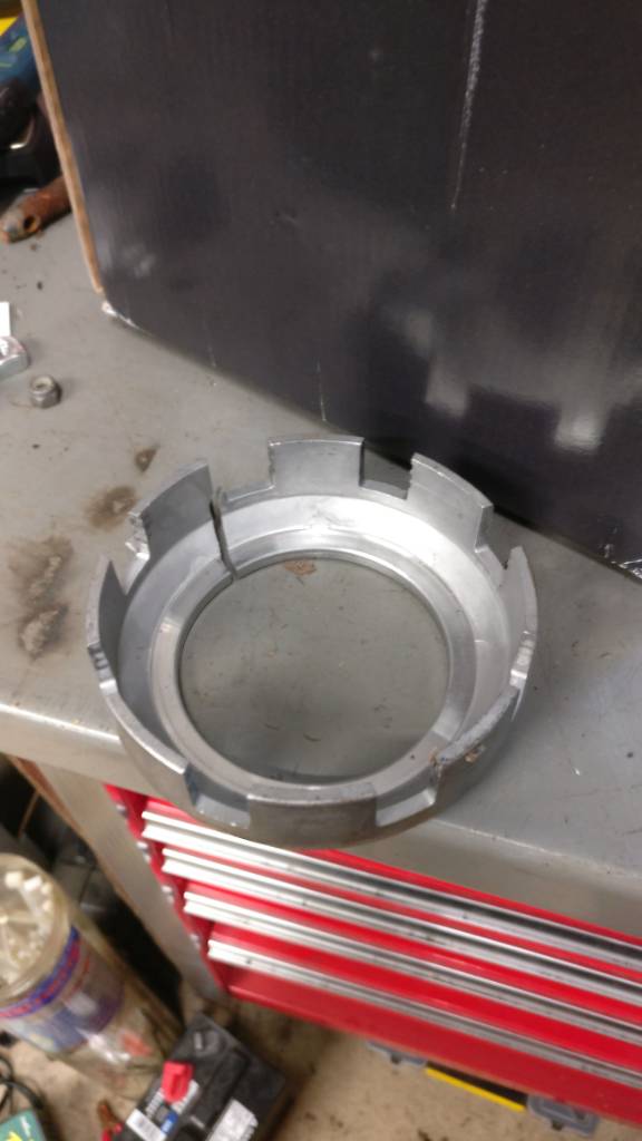

I get the impression that my JD 6200 with an electrically activated PTO does not try and slow down my 1000# cutter wheel in my wood chipper at all, when disengaged. It rolls on seemingly forever and to a slow stop, suggesting to me, no brake. EDIT The chipper DOES have an over running clutch, which may come into play when throttling down, but I don't think it comes into play with the PTO disengaged. I usually cut the PTO, then throttle down. If the tractor quit unexpectedly, it is nice to know that clutch is there.
Thinking about it, I don't think any tractor I have had or used, had a PTO brake.
I should call my Mennonite JD Experts (Martin Farm Service) and talk to people who actually know these tractors on the inside.
   / Picked up half a megawatt worth of Caterpillar power, think I'll make a PTO generator #95
If it has one it could be broken. Attached is the PTO brake basket out of a JD4300. Note the crack. IMG_20181102_120353.jpeg

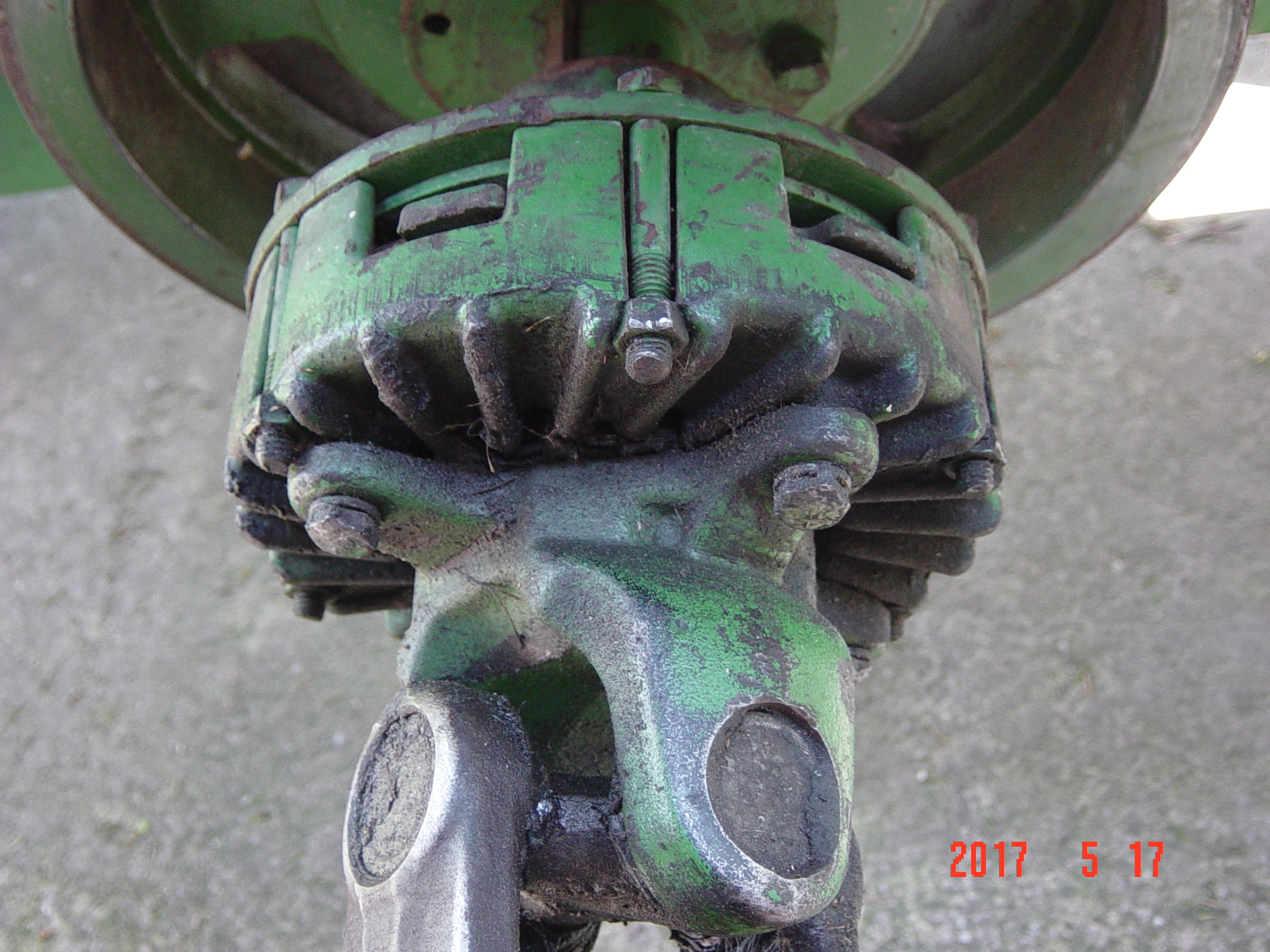

I posted a picture of my chipper clutch on here last year, as I didn't know what it was or does.
That baby screams (and smokes) when the power is applied. I found that kicking the PTO clutch momentarily to get the thing moving, then applying it for good works best, but I am not sure why.
It is a compact unit that goes on the shaft. Over-running and friction clutch. I would recommend one for your application.
