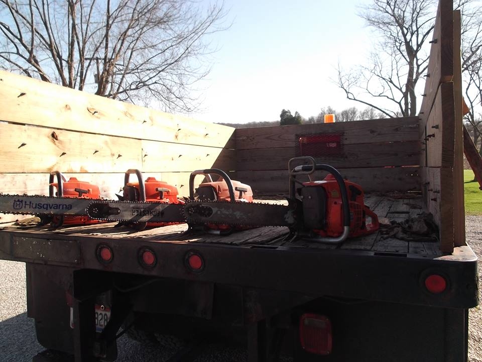

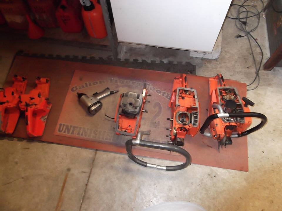

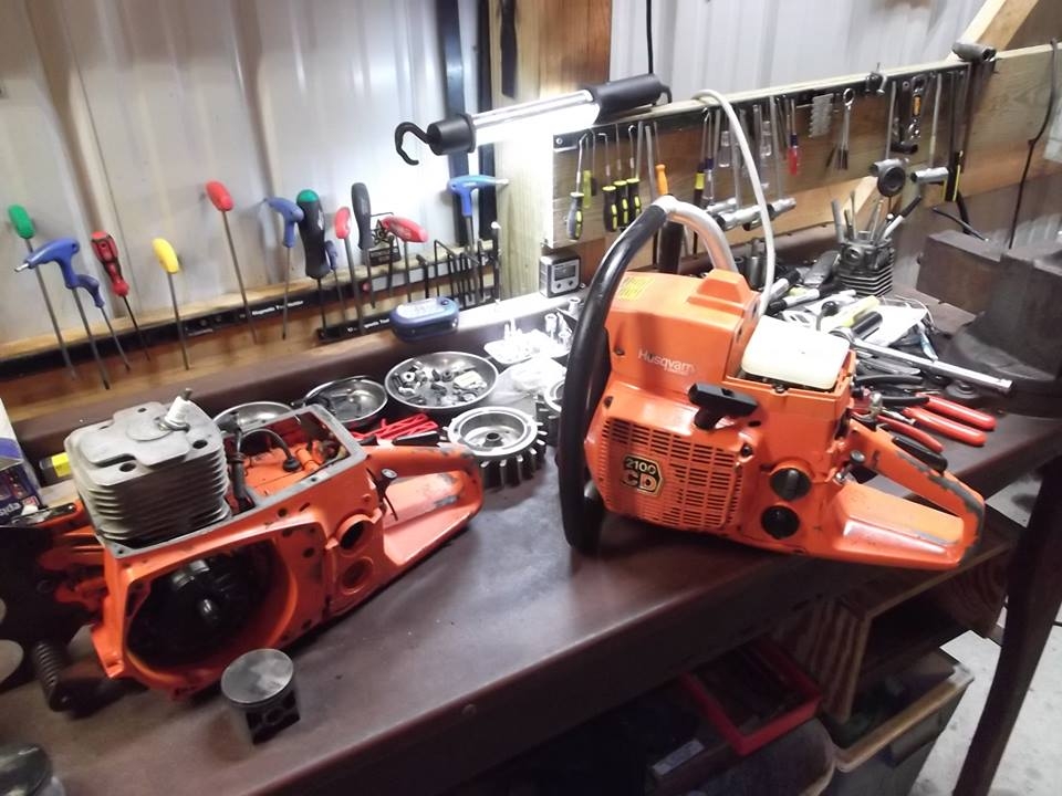

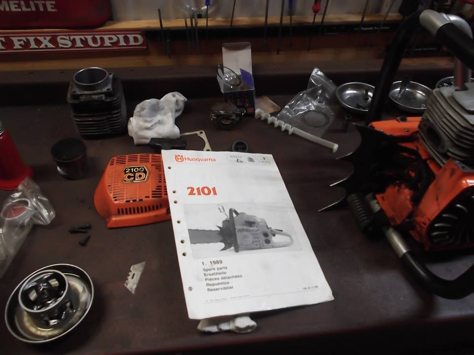

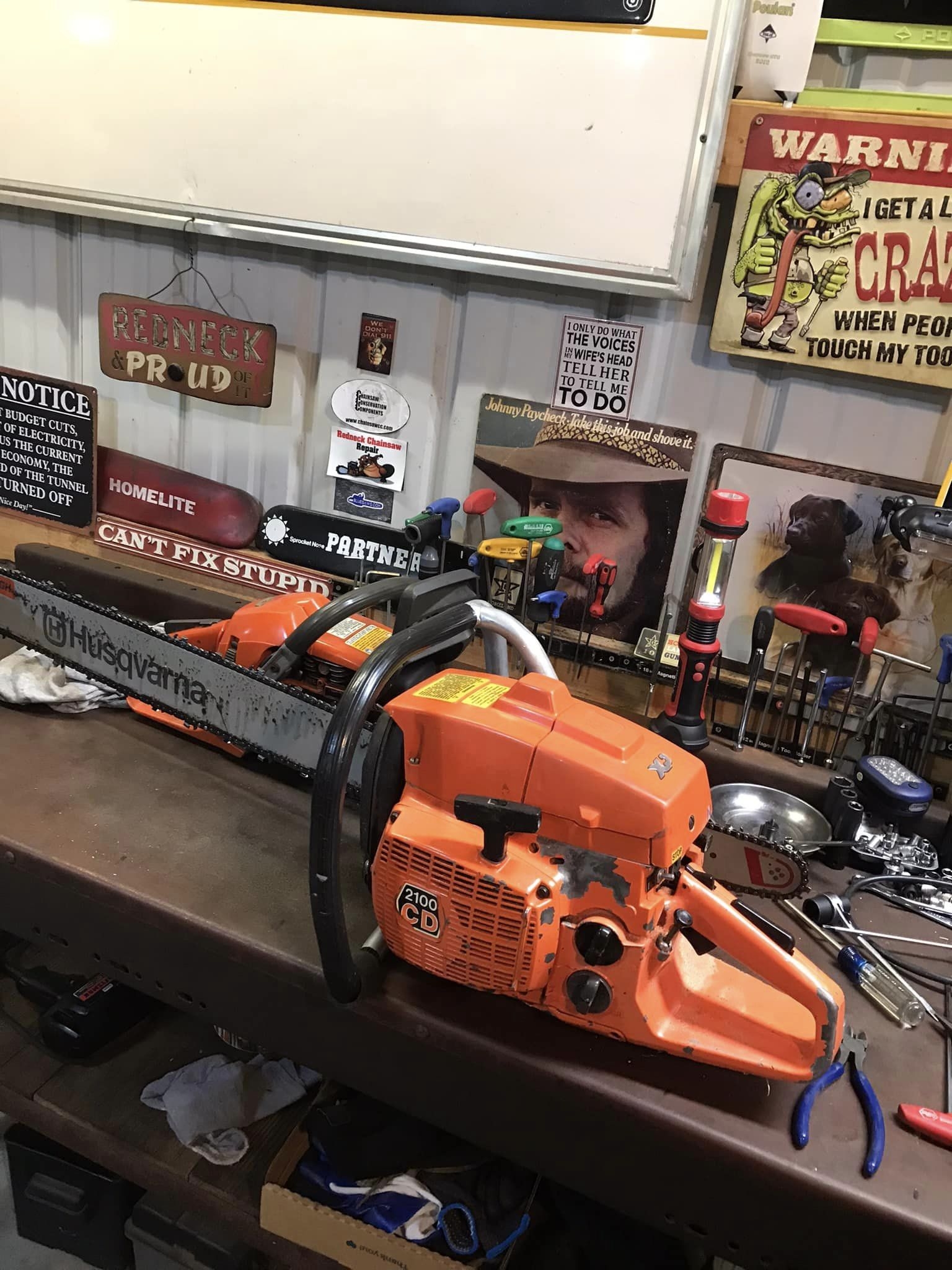

I actually enjoy finding and rebuilding saws for the collector types though. I have a list of saws that folks want and get them and ship to them when needed.
Heck this local had me build 4 2100 2101 from boxes of parts.
All easy money for me. Being on a pension already and not worried about where $ coming from, it is just play money to me to buy more play things for myself. (y) 😁
One I just hooked him up from another friend. Quick tune and sent him home with another.
Learned more about 21's then I ever wanted to know. :ROFLMAO:

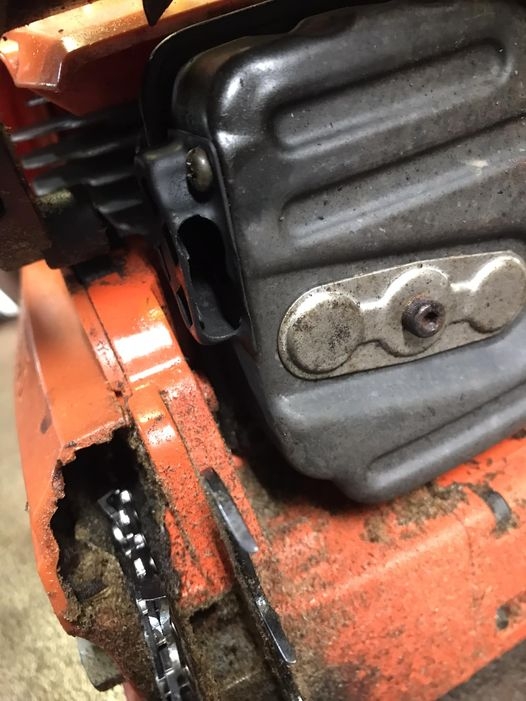

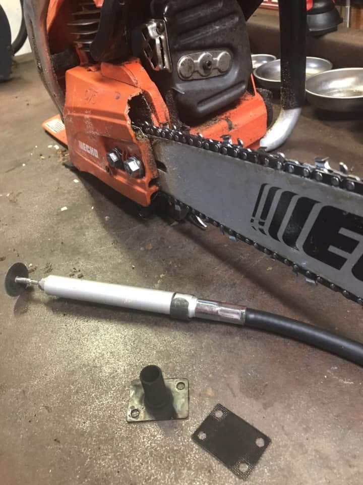

New echo 4910 $280 and tax here. 5 left at dealer.
Just need that muffler mod and cut with 346 NE.
Tune as they come lame. Mine was in 11's. Max is 14K
Toss inside tube, cut slit and grind open and open front of deflector.
   / Picked up a used Stihl MS261 #34

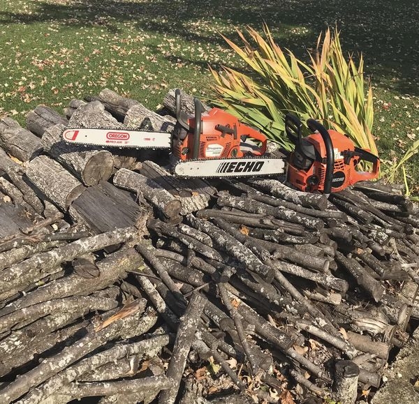

View attachment 1952645View attachment 1952646
$280 is a steal of a deal! I ported the muffler and reduced the squish down some. It will cut as well as my 261CM. Love that Echo!

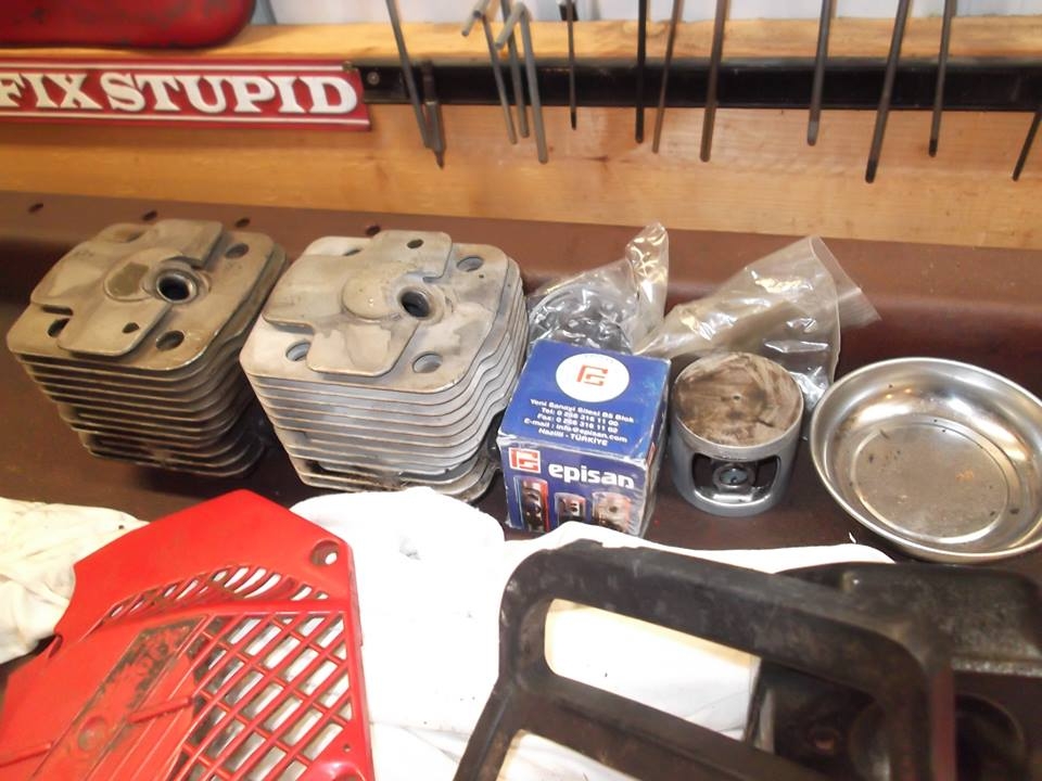

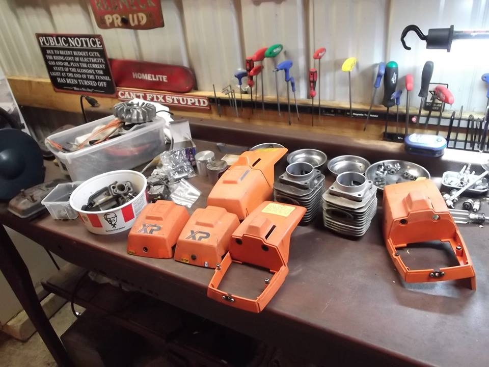

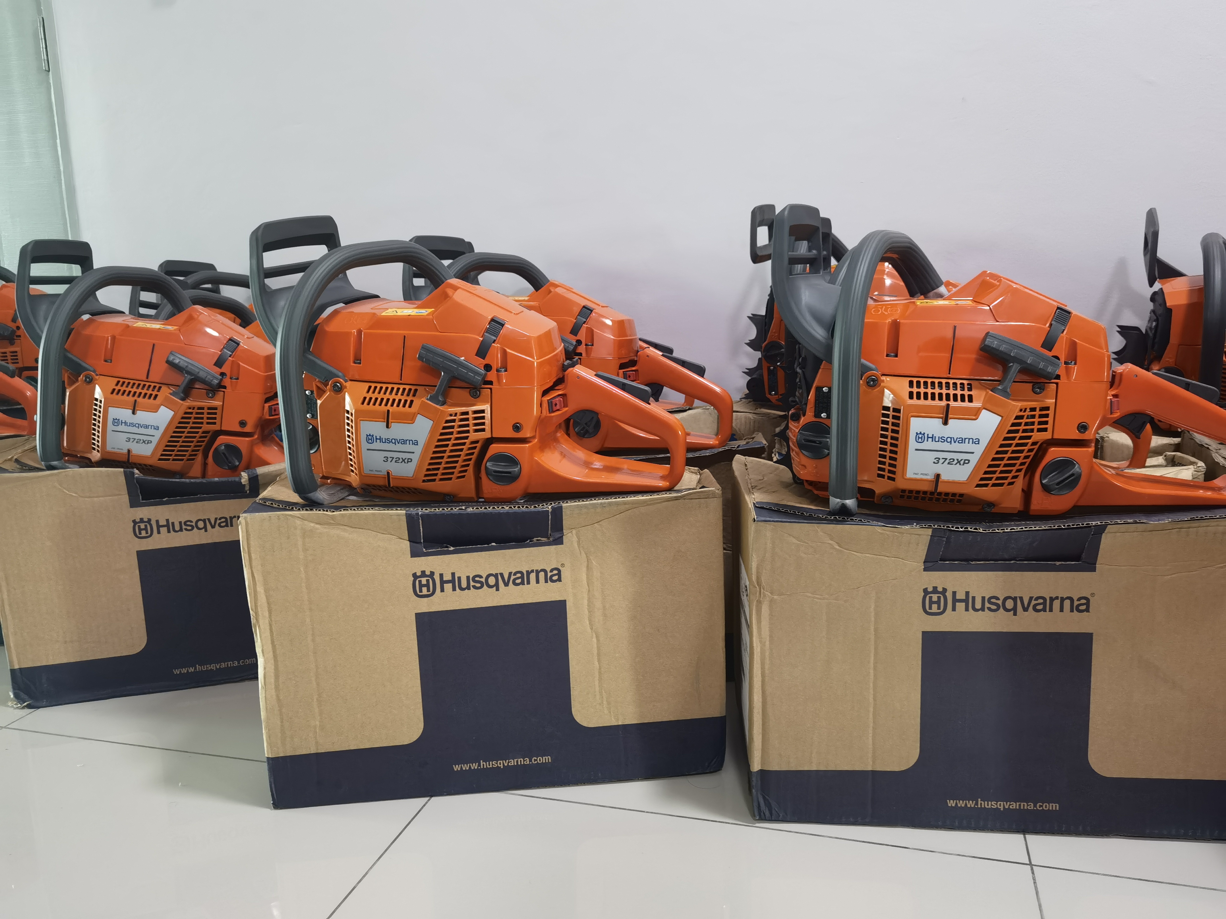

Used US and or New shipped in.
OE 372 440 044 046 460
OE 372 can still be bought new by a dealer from overseas in my group. Like 900-950 shipped.
Porting now days adds 300-400 more cost and use a trusted porter. Not some of these boobtube hacks trying to take your money.
So best learn that yourself. For that cost or used saw to do it on once fixed right.
