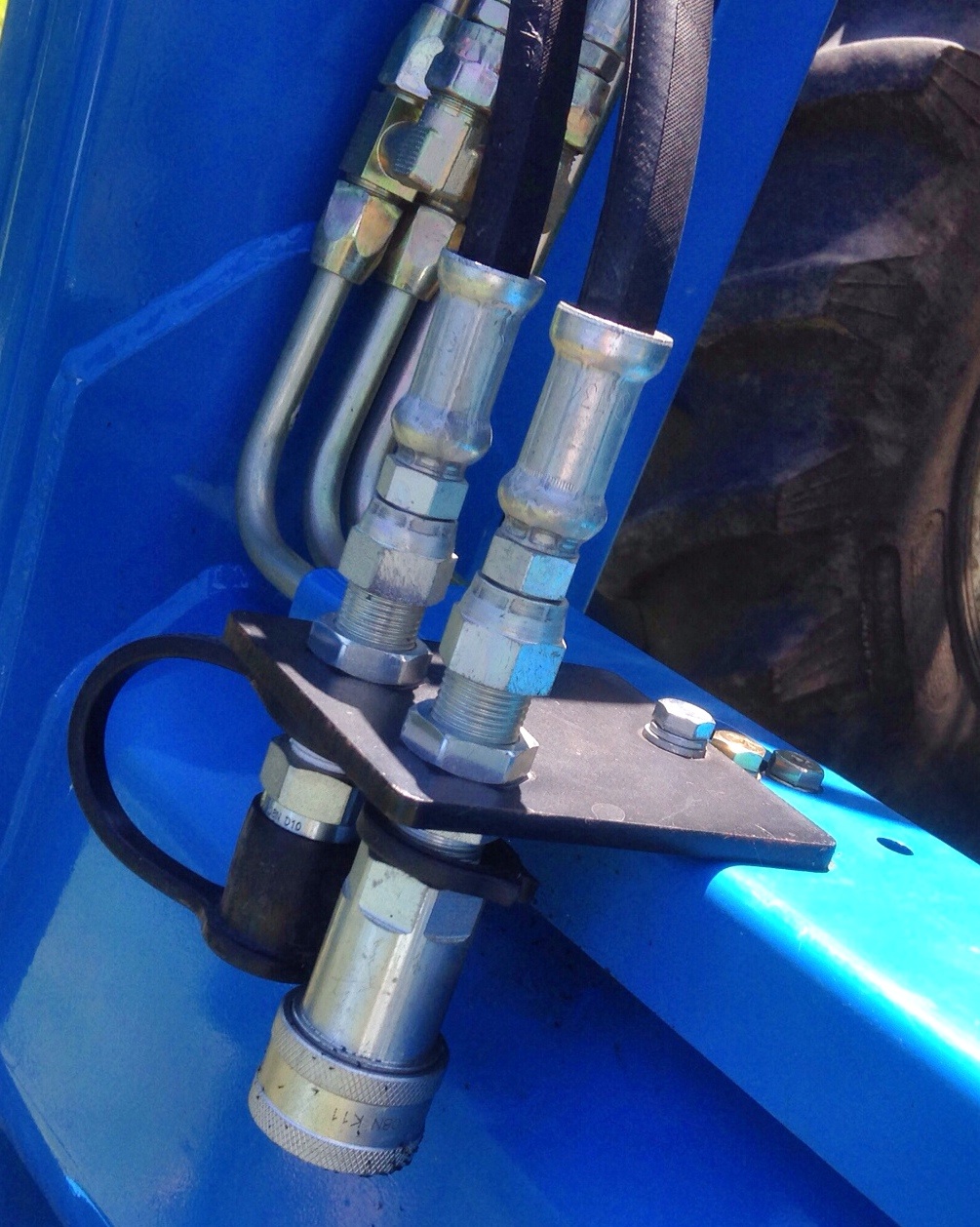

Mine are attached to the cross member on the loader with a plate, you could do the same thing with hard lines I believe.
/ Photo request for QD location on loader
Up on the other end, do you have QDs so that you have the option to remove the loader on your 3rd F hydraulic lines? If so, do you have a bolt on plate there as well?
/ Photo request for QD location on loader #4
There are QDs at both ends so I can take off the loader. There is no plate on the rear, it is attached/detached right at the valve.

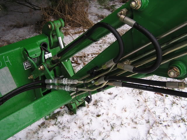

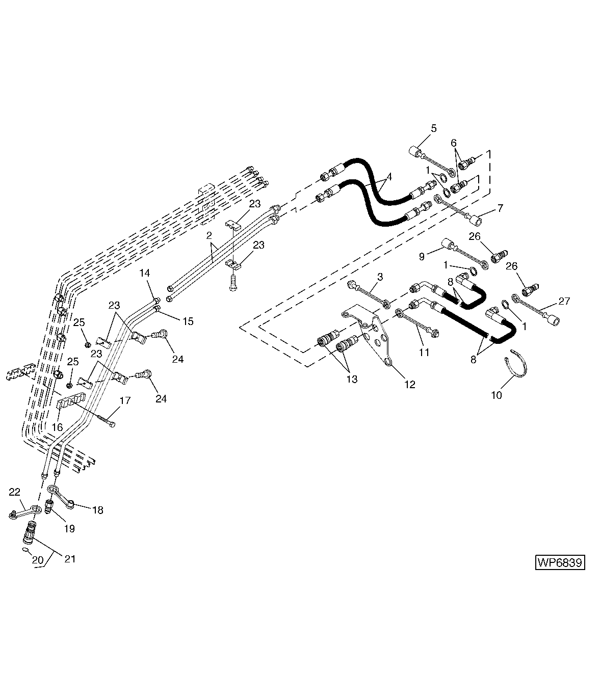

Here is how JD terminates their 3rd function hardlines (misc pic found on TBN, not mine):

It really looks like JD has the easiest method. If you know, what application is that parts schematic from?
Yep, sure do...
The 300cx and 400cx loaders.
