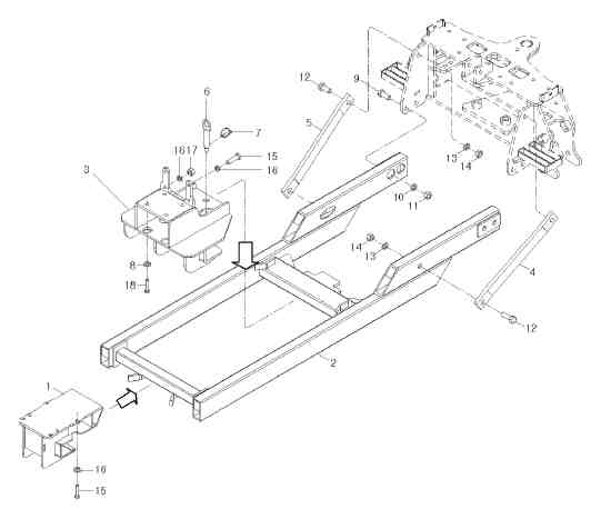

/ Photo request for kioti backhoe subframe front attachment
Wallace,
Is it possible to just buy part number 1 in your diagram?
Thanks,
Marcus
/ Photo request for kioti backhoe subframe front attachment #6
Check your pm
