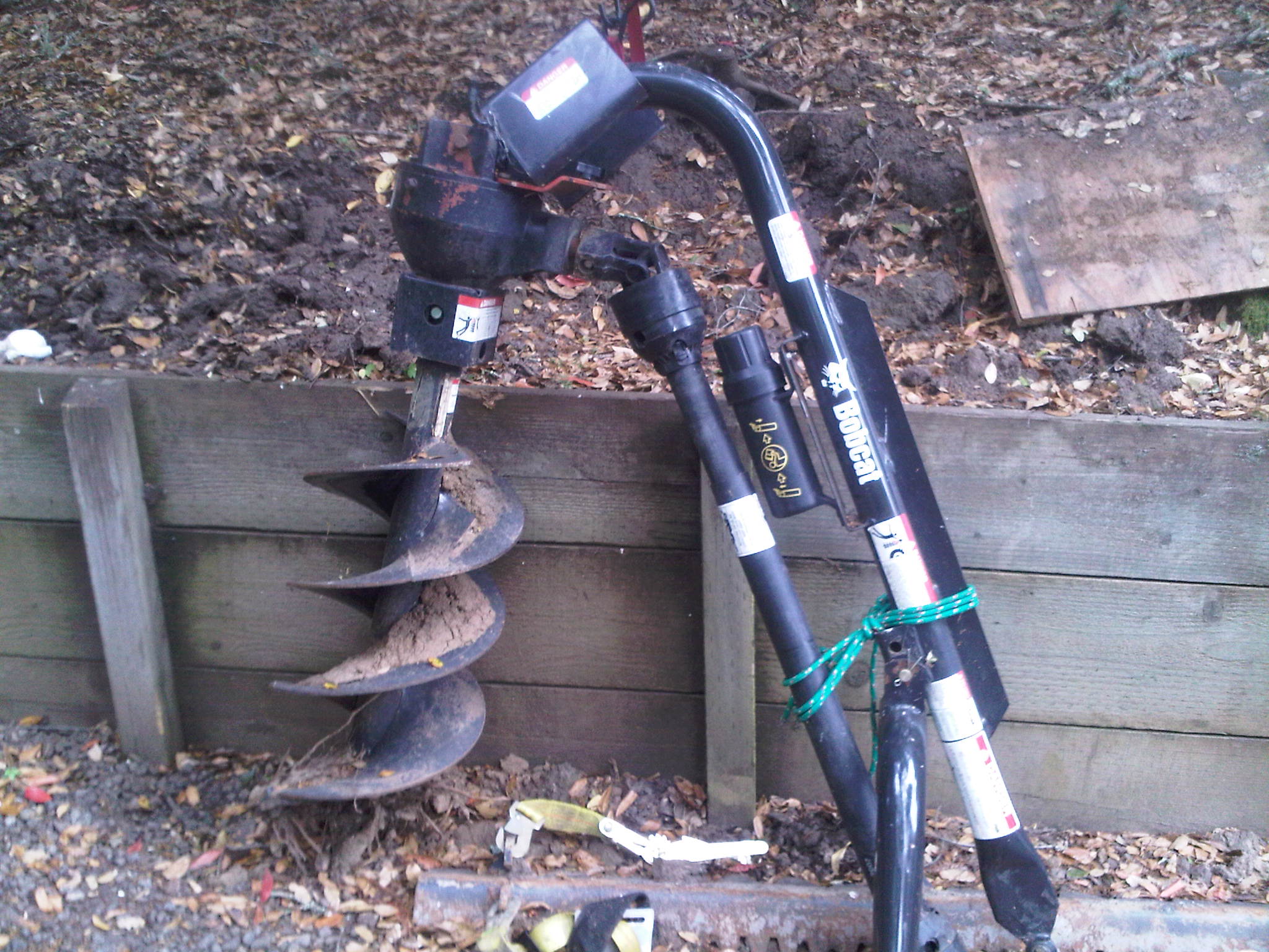

Below are some pictures of my unit as it sits.

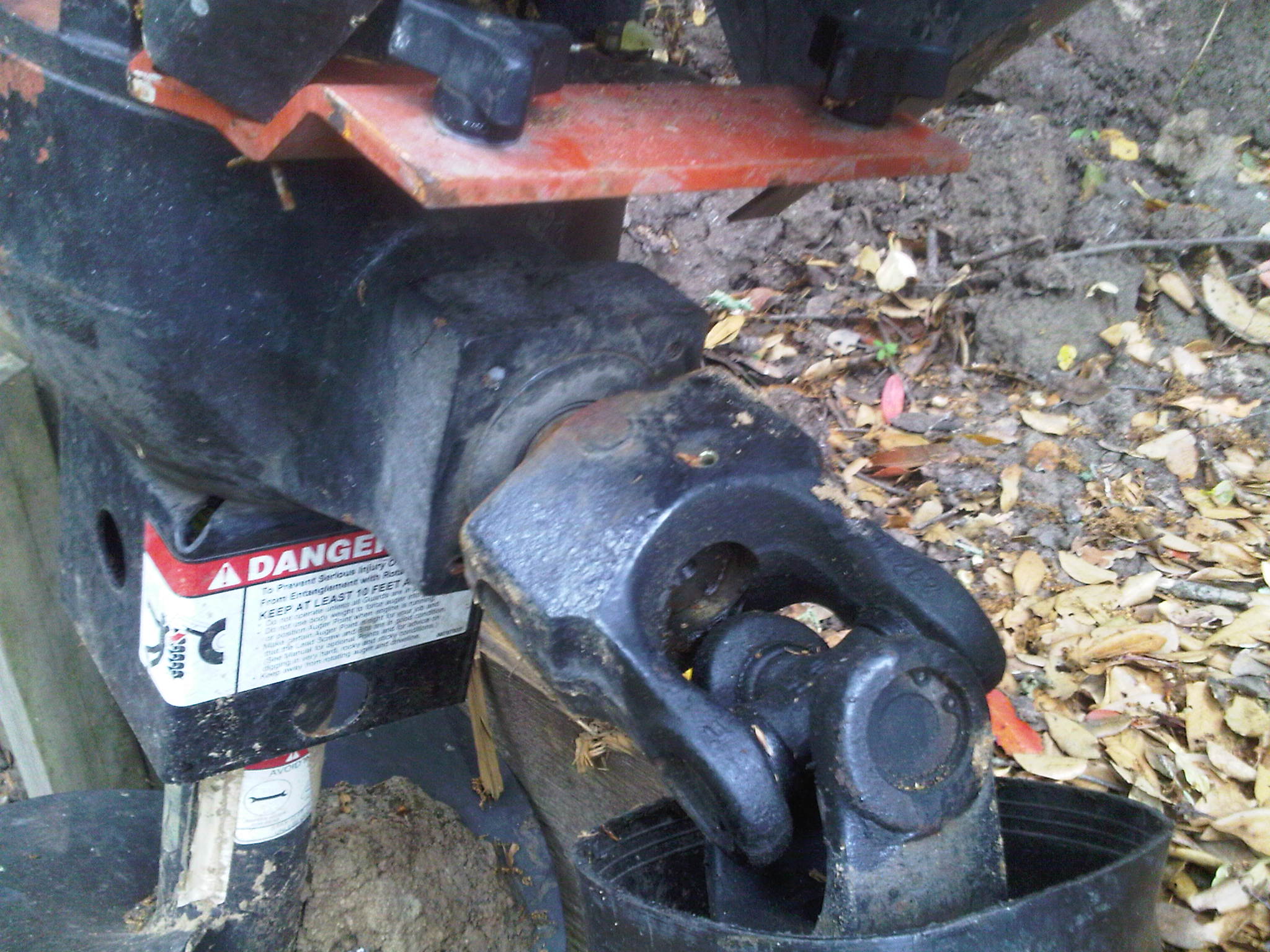

Essentially it seems that no more than 300 RPM would be required. Some things I'm not certain about are whether a relief in the motor will be required (or will the tractors relief valve be suitable for the remote). Will I need to increase the bolt size or will grade 8 1/4" bolts be acceptable (seems quite small to me).
The bolt spacing pattern on the existing PHD appears to be 2 5/8" square OC? or 3.625" in diameter? with the overall square portion being 3 1/2". The input shaft to the gear box is 1 1/4" diameter (shear bolt, no key) by 2 1/4" long.
I'm thinking a motor, motor mount, bucket mount and a coupling are the required components (beside hydraulic hose and fittings).

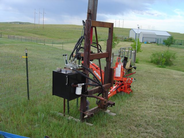

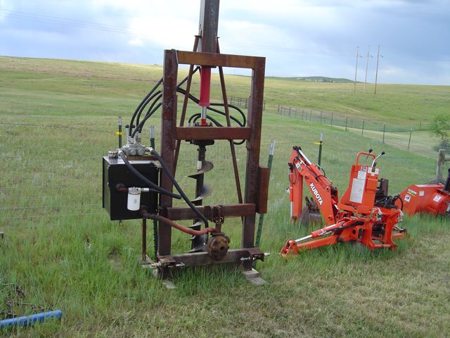

I converted a SpeeCo digger to hydraulic 10 years or so ago. I originally used it on the FEL but drilling holes straight (vertical) was a challenge due to the arc the loader travels in. Down pressure was the reason for doing it. About 5 years ago I got ambitious and built a frame that guides the head and has a hydraulic cylinder to provide the travel and down pressure (kind of like drilling rig). I run it with a 12 gpm (I think) PTO pump and it has a 15 gallon reservoir and a 2 spool valve. I made it to fit both the BX22 and a Category 2 3-point. I chain the mast to the drawbar so I can put the weight of the tractor on the auger. It works pretty good.
I made the hydraulic motor mount to bolt where the PTO guard was. They were metric bolts and either 8 or 10 mm. I coupled it up with a LoveJoy coupling. I had 2 CharLynn motors of different displacements. The first I tried ran it about the same speed as the PTO would but it didn't have enough torque to dig. I changed to the bigger displacement motor and although it is a little on the slow side it digs fine. All the materials except for the valve and hoses was stuff I had laying around or was pilfered from other projects. I can't tell you what the displacement of the motor is without looking or what the reduction of the head is. I think the relief on my valve was set to 1500 psi which was the rating of the motor.
I would drill and tap the holes out 3/8 or what ever the bolt hole size is on the adapter if you can. Can't say that the 1/4 wouldn't work but bigger is better. You'll also need to make sure the adapter is the right length face to face for your shaft lengths. I would look for a motor close to or more that the psi rating of the tractor so you will have the maximum torque. Not sure that the Surplus Center mount would be strong enough going by it's HP rating. It does resemble what I made though.
I'll try and get the displacement of the motor I used so you have something to go by. Might take me a day or two. Definitely a doable project.

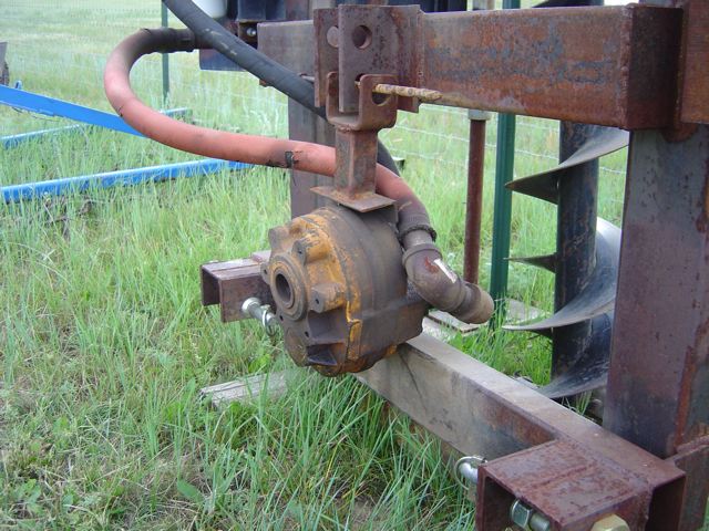

Just realized that I never added the pictures to the thread. Here are pictures of the PHD as it sits...

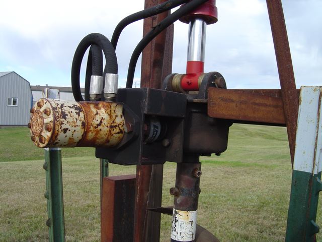

Steve; The motor I used on the digger is a CharLynn 101-1008-07 which is a 20 cu/in. With any luck there will be pictures

I was kind of questioning the 20 cu./in. on that motor so I looked it up on CharLynn's site and it is actually 22.6 cu./in., 1250 PSI and 15 GPM max. I would think if you can find a higher PSI rated motor you could make do with a smaller cu./in. motor and get the RPM up. That was a motor I had and made work. Probably not the optimum motor. If I do have a 12 GPM pump I'm only turning the motor 122 RPM. I don't know what the reduction is on the digger head. Kind of need to know that. Should probably be looking at the in./lb. of torque number along with the gear reduction. I couldn't turn the auger to determine the reduction. I don't know your time frame for this project, but I do have some fencing to do yet this year but I'm currently building a garage. If I get the digger on a tractor I could check the ratio. Might not happen until fall. I had intentions of getting the thing painted but had a few mods I was going to do 1st, but never got around to it.
Kim
/ PHD conversion to hydraulic?? #9
I just went back to the motor site and the in./lb. of torque number is 3347. I wouldn't want less than that.

So after some input and searching what was available (mostly at Surplus Center) I ended up using a 6 ci displacement hydraulic motor coupled to my current PHD gearbox. I used a hydraulic motor to gas engine mount (of the shelf component) and did some minor machining on the drill press to make everything bolt together. I picked a motor with the same diameter output (1 1.4") as the input to the gear box. It is assembled with a solid steel coupling and a flywheel key on the motor side and a through bolt on the gear box side.
Here is a picture of the first test run with the auger attached to the rear.

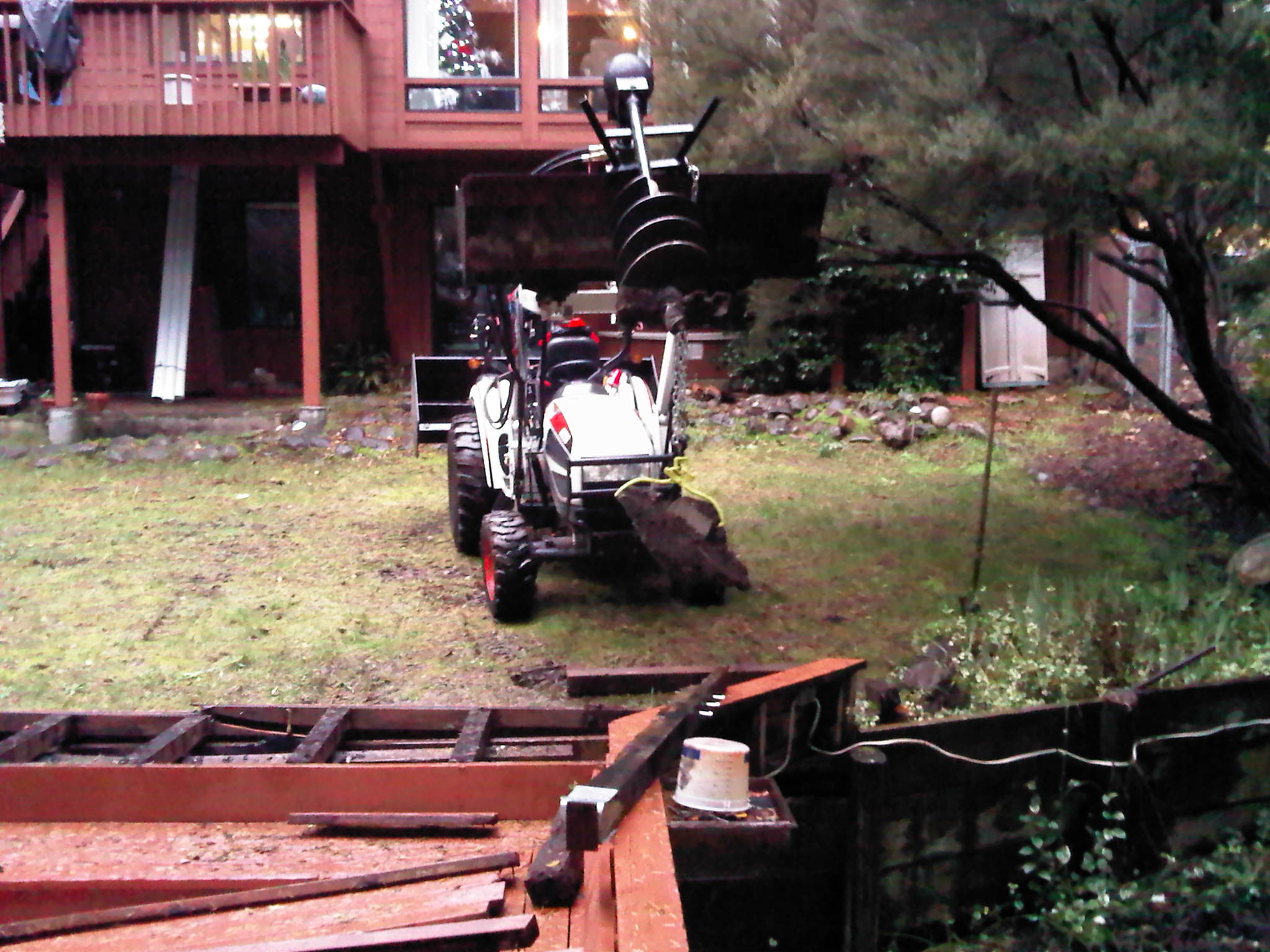

Bolstered by my success drilling some practice holes at idle and at PTO speeds, it seems the size of the motor was about right for the capacity of my rear remotes. At idle its a nice slow rotation. At PTO speed the auger spins fast enough to whip the dirt off the auger drive.
The next step was to mount the device to the FEL so I could drill holes up slope and deep holes down slope of the tractor. The receiver welded to the top of the bucket (idea "borrowed" from TBN), seemed to be a good platform for attachment. So a 2 way swivel was fabricated to allow the auger to remain plumb. A stop was added to prevent the motor / hoses from hitting anything during transport. And a pin on bracket was used to prevent the auger from swinging side to side during transport.
You can see the pictures of the project now under way. Essentially drilling deep footings on the uphill side of the deck to prevent it from sinking into the ground further. Over the course of time the up slope side of the deck has sunk into the ground more than 10". It appears that the existing (crazy shallow) footers are sitting on non compacted clay fill and organic matter.
Some of the lower footers will also be drilled at a slight angle from the access "road" that I cut below the deck in 2009. The FEL mount allow me to raise the auger up higher above ground level than I could before using the rear mounted version.
Today I picked up a combined 38 tons of CMix and base rock to begin pouring new footers and compacting the base rock in the dirt area under the deck to minimize water infiltration and settling. As you can see this small dimension on the deck is 28 foot long, so this redwood beast is over 1000 sf, so the replacement cost could be quite substantial should it "slide down the hill".

For the safety police... It seem appropriate to add a picture of the rear ballast hanging out back (along with my latest mod, the tilt). This box beast came of a retired circa 1970 skip loader and has 3/8" thick steel. At 77" its way too big for the tractor, but it's main use is ballast and spreading base rock on the community road at which it does a fine job. Too bad the tail board was lost over two decades ago. My rears are also loaded, as you can see the hills here are SCARY!! I'll take all the weight I can get just above ground level.

Here's the breakdown on the parts (all from Surplus center)
https://www.surpluscenter.com/item.asp?catname=&qty=1&item=9-7490
9-7490 Motor 6.09 ci $135.50
1-3228 Hyd Pump Mount SAE A $37.95
9-6901-10-8 SAE 10M x 1/2 NPTF 90 swivels $11.00
****1-1563-G Shaft Coupler 1 1/4" $14.95 ****
Plus Hose, quick couplers, scrap steel and some bolts and pins for roughly another $100.00.
*** Note the shaft coupler was a mistake. The key way was not the same size as the key way on the hydraulic motor. So it had to be opened up to a larger size (8mm (roughly 5.16")) instead of 1/4" to fit the hydraulic motor.*** Surplus Center does sell the larger key way rigid coupler.
The motor was selected using two criteria:
1. The shaft type and diameter matched the size of the input for the Auger Gear box I already had. So a rigid coupler could be used.
2. The displacement was calculated using the gear ratio of the Auger Box and the output of my rear remotes (7.9 GPM) to turn at the desired rate of rotation depending on the engine speed. It's nice and slow at low engine speed and fast enough to sling the dirt out of my 15" auger at a high engine speed. I used the Surplus center online calculator to determine RPM at GPM.
Some minor (drill press) machining was required on the motor mount. The coupler needed to be cut to length, drilled and the key way opened up to the correct size. The swivel, brackets and rest were fabed and welded from roughly $30 of 1/4" steel tubing (plus some angle which I already had around).
