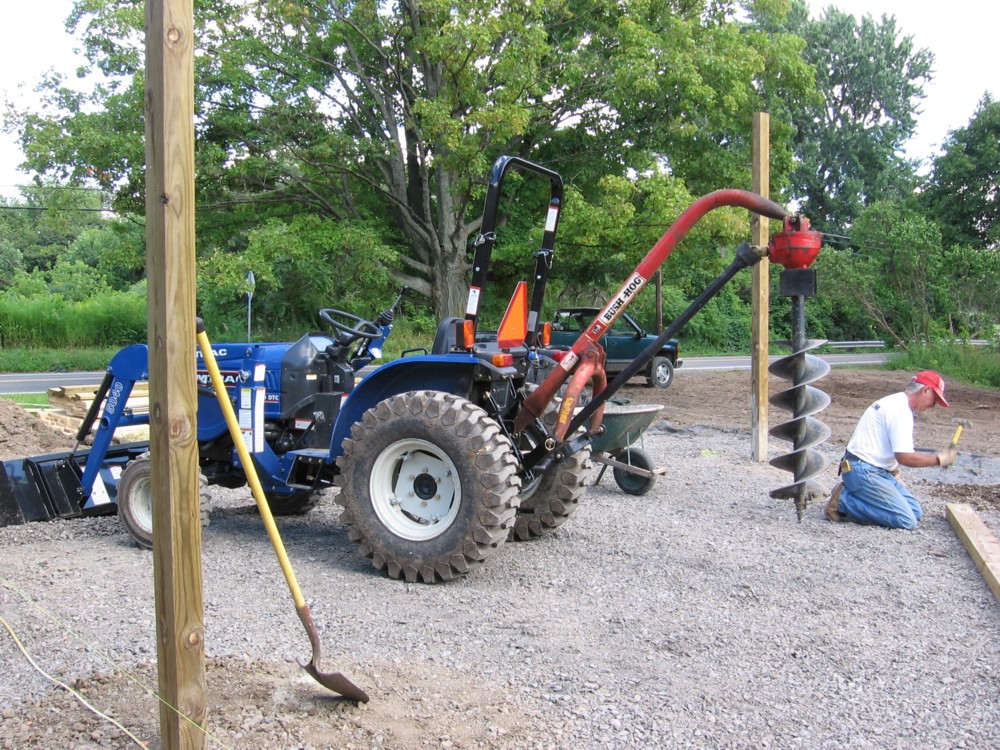

I use my PHD just for fence posts. I have always had two augers. A 9" auger for four inch diameter fence posts and a 12" auger for seven inch diameter fence posts. The 4" poles are line poles and the 7" poles are corner/brace poles. Too small an auger and there won't enough slop in the hole if the hole is out of line a bit. Too big an auger makes for a lot of tamping with a spud bar.
/ PHD Auger #9

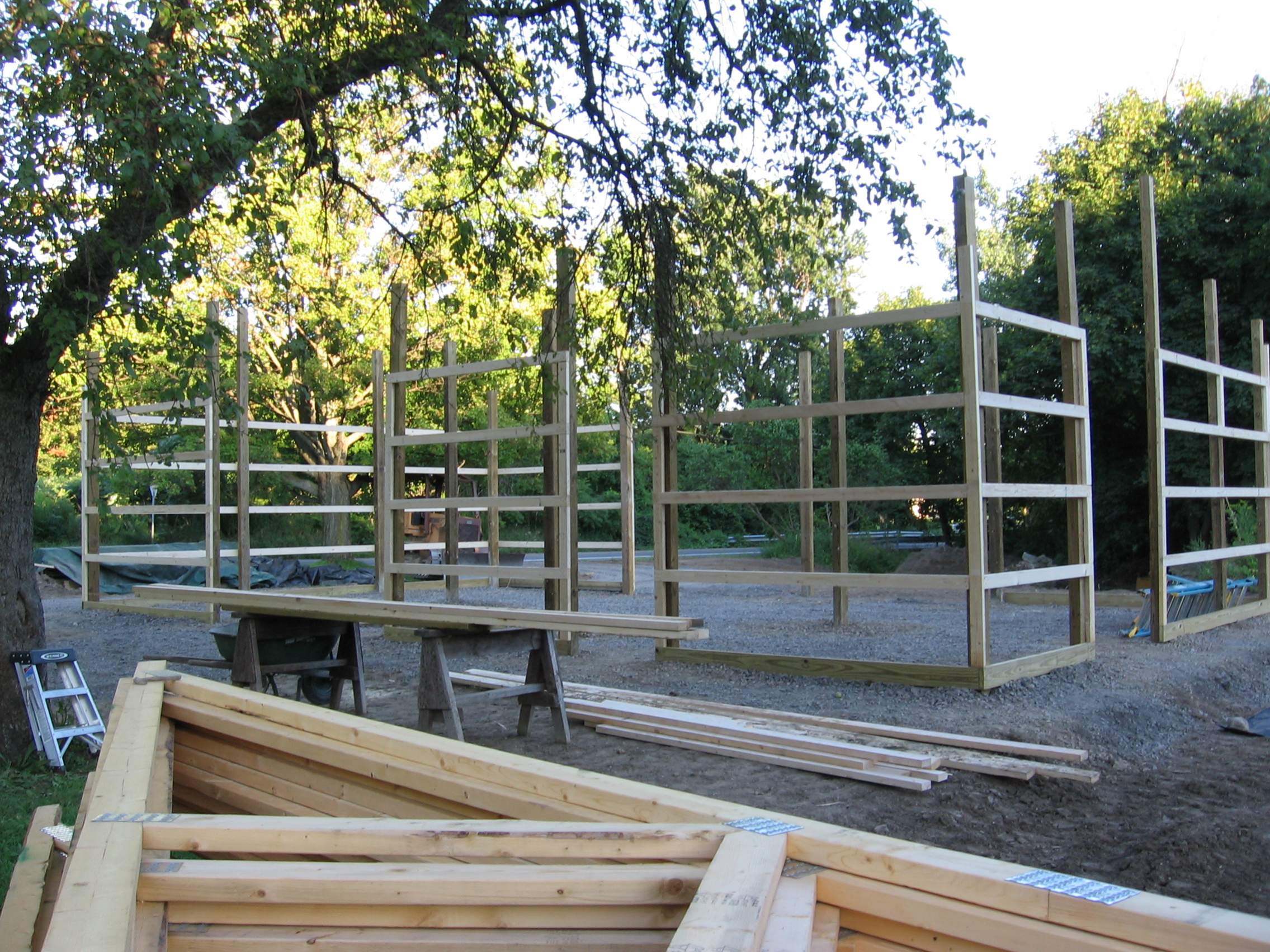

keep in mind a 6x6 is close to 8" from corner to corner, so a 9" hole won't leave you much room for error in placement when digging the holes for that pole barn.
/ PHD Auger #10
True. In my humble opinion, fences and pole barns require wiggle room. What you see is 12 inch auger.
