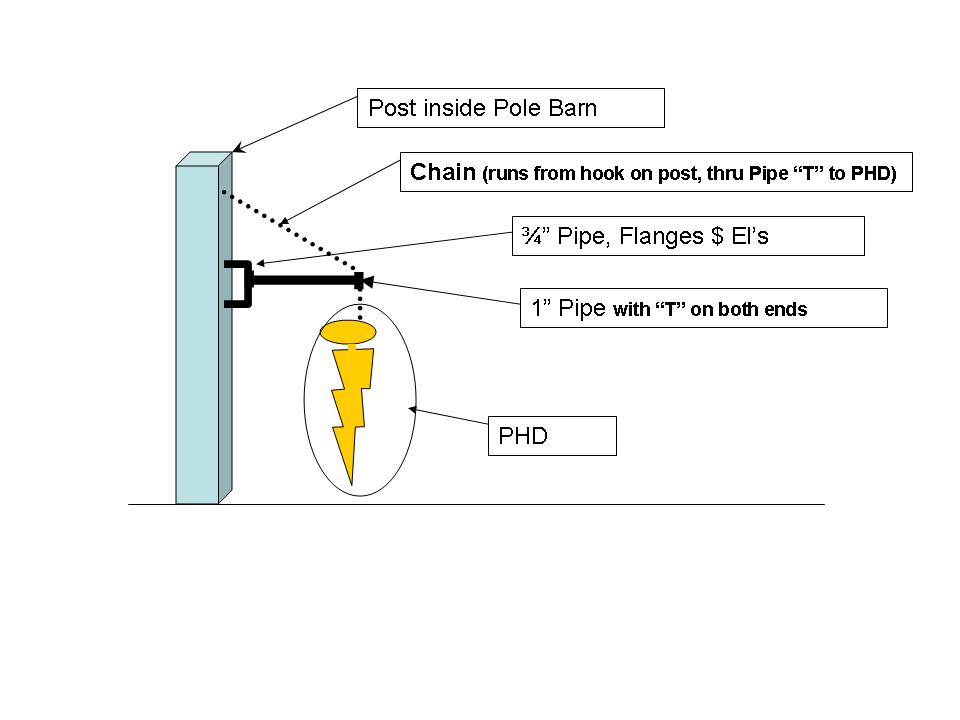

As a newbie with a PHD on my Kubota B6100, I found that getting the thing on and off of the 3Point was the biggest struggle. The darn thing is HEAVY - and TOP heavy at that!
Here's what I rigged up inside my pole barn that now makes it easy. The PHD hangs just off the ground and can swing in any direction. I really only have to get the tractor "close" to the right spot and I can swing the PHD around easily to get it hooked up - without worrying about the thing falling over on me!
I'll try to take some actual pictures tonight when I get home.
Hope this helps.
