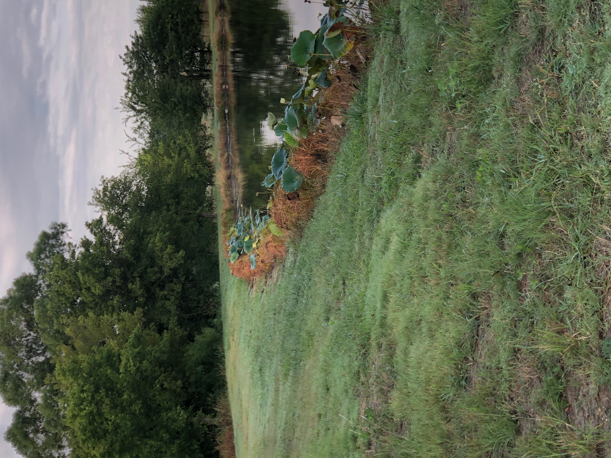

Sounds like it would be a benefit IF it only worked. My main goal is to be able to mow pond banks. I have four ponds, one of which is 5 acres (see picture) and most are treeless and fairly clean around the banks. The two mowers I am looking at are:
Peruzzo Bull Cross Ditch Bank Flail Mowers -- Iowa Farm Equipment
Ventura TRIN Offset Ditch Bank Flail Mowers -- Iowa Farm Equipment
My 12' bat-wing gets me close to the edge of the banks but the last few feet are a bear to keep trimmed. Just tired of using DR Trimmers and other such mowers.

Hello RMRDallas,
If all your mowed acreage is like the pond in the image you provided I see no reason why the Peruzzo mower will not work for you.
Having a tilt meter on the hood of the mule(if you do not already own one) will help keep you safe and remid you to back away from
the edge of the pond with the tractor and keep it at 15 degrees or less of slope at all times to prevent a rollover.
The main issue is having a counterweight on the outboard side to maintain the stability of the tractor you will use for the mowing.
Having suitcase weights for the front and wheel weights for the left rear tire and ballasted rear tires will assure you can maintain
the center of gravity you need to mow the banks of your ponds
If you already have ballast in your tires I would at least invest in the tilt meter and bolt it to the hood of the tractor and after mowing
with it for a week or so to get used to the weight of the mower and how it handles while you move it in and out while mowing before I
tried mowing the slopes of the ponds.
You need to keep the lower links of the three point hitch level at all times while mowing as this helps to keep the boom and mower head
within the proper reach/extension and down angle on the pond banks.
When adjusting the mower after mounting it you need to lock the stop for the draft control at the point where the lower links are level and the mower is fully extended and is resting on the rear roller and use that point of reference when mowing the pond banks as you will be lowering the mower to the pond bank and following the contour of the bank while the tractor is on the stable ground above and to the left side of the pond bank.
The major issue is knowing in advance how much hydraulic power you have in the tractors hydraulic system and flow in the remote to adequately lift the mower from the slope and retract the boom.
It would be worth every penny spent if you could part with the tractor for a few days and let the dealer install it for you to make sure it works properly.

I have a tilt meter ready to put on my new tractor as slopes bother me, especially with something like this that will be hanging off the side. The tractor I will be using is a JD 5100R which is a fairly heavy tractor but still one I would like to add as much weight as I can get. My JD dealership will be delivering the tractor in about a week while this Peruzzo mower is out of stock for 6-8 weeks! I have seen a variety of reviews on Iowa Farm Equipment but so far Andrew has been very helpful – time will tell. I know there are a lot of other mowers out there but based on my tractor’s hp and desire to maximize the reach, I felt the Peruzzo and also the Ventura (have not seen ANY reviews on) were the best choices.
The pond bank in my picture also disguises a variety of drop-offs and ruts caused by erosion, beaver wars, geese, etc. which is another reason I have been hesitant to get my brush-hog wheel too close to the edge. Hopefully, I can get this mower hooked up and working without too many problems. My mega location JD dealership has those service trucks that roam the countryside so maybe they can stop by if I have problems. Thanks for all the help guys.
