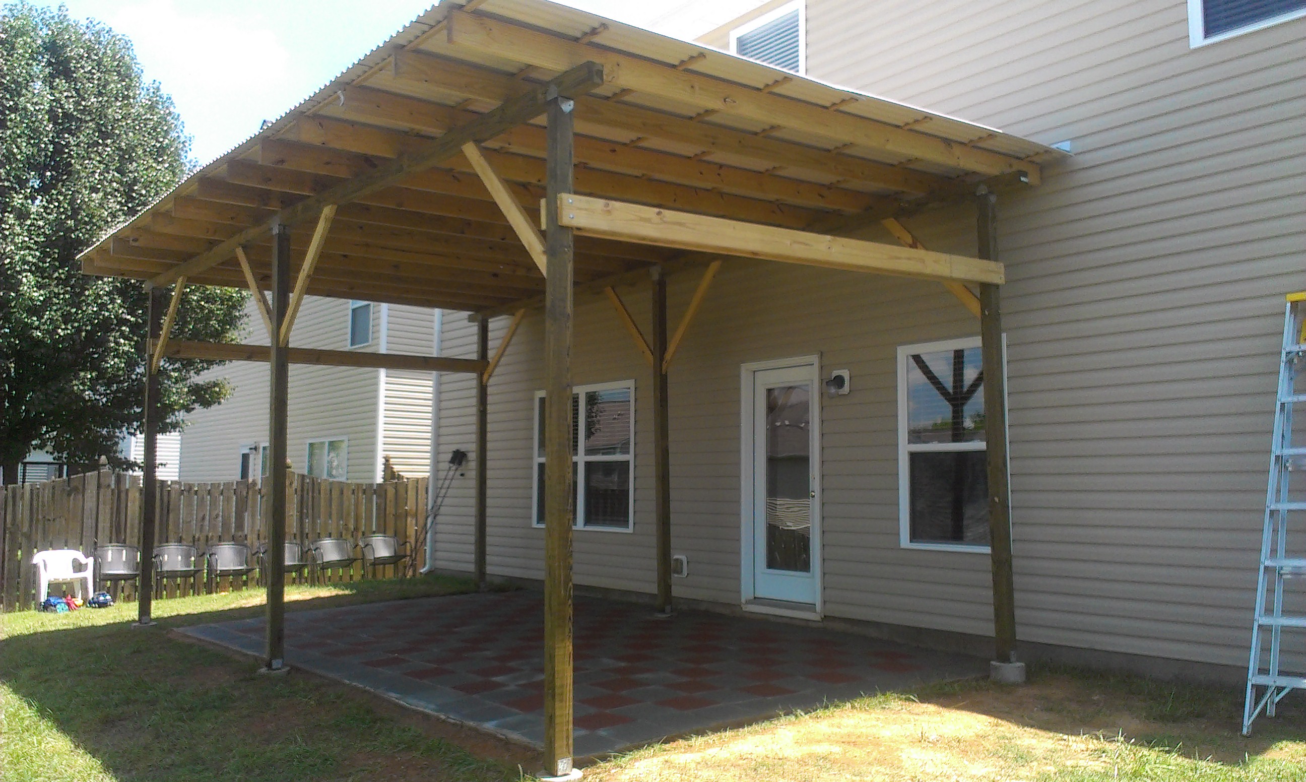

We have just helped a relative build a 23'x13'x10' pergola. It is not attached to the house. It is quite wobbly. We're not sure if it's because of the post bases, or because of the post caps, or because it doesn't have enough support. Everything is put together with screws, except for the lower 2x6s. We are amateurs at this and would appreciate any kind:thumbsup: suggestions.

Poles should have been heavier which would have helped some.
/ Pergola Wobbly #3
When you say "wobbly", could you be more specific. Does it move side to side (i.e. parallel to the house) or is in all directions?
/ Pergola Wobbly #4
Many, many issues there.
Everything.... every single piece of wood appears to be undersized. 4X4 posts are simply not up to the task. You needed 6X6s. Using 4X4's for your beams was another really bad idea. Possibly the worst in the whole thing. Your 2x4 diagonal braces aren't providing any meaningful assistance. It looks like you used furring strips for your purlins.
You're not going to want to hear this, but if I was asked to "fix" that structure, I'd begin by carefully taking it down and starting over.
You tried to do it on the super-cheap.
6X6 Posts. Shorter. No reason for that structure to be so tall.
Triple 2X10 or 2X12s for the beams.
4X6 for the diagonal bracing. Bolted through the posts all the way into the brace on the other side.
The rafters should be 2X8 or 2X10. Some might tell you 2X12. Especially on 24" centers.
The purlins should be 2X4's.
You can reuse the tins.
Do it all in PT or some other resistant wood stock.
This is all my opinion. Others might tell you different. $0.02

Perhaps the height of the structure is to keep the hot air higher. One problem, and a big one, the post brackets are too small to accommodate a 6"x6" post.
/ Pergola Wobbly #6
Cut off the 4X post brackets, then drill holes for new ones. Secure with epoxy.
/ Pergola Wobbly #7
Yes, there are issues.
Supposing the goal is to improve what is there, you could add some rigidity by boxing in the ends above the double 2x6's, tying that to an added pair of purlins running at the top of the posts. You could do the same across the long dimension too. That space isn't really accomplishing much now. If you use pt plywood 4x8 sheathing for strength, then cover it with something that looks good, matches the house siding maybe.
One concern I have is the roof doesn't appear to have much slope. I doubt you worry about snow loads, but a heavy rain needs to run off easily too. The roof as it is, is not providing much in the way of stiffening the structure, due to the furring strips and tin being all there is there. Is there a plan to finish the underside of the roof?
/ Pergola Wobbly #8
one thing to try ....
screw a long 2 x 4 ( 2 screws per rafter ) to the bottom of the roof , run it on the diagonal ( corner to corner ) ... it should help stiffen the "roof box area " and prevent shifting side to side

the other suggestion is to prop up each end ( corner ) , remove the end post and sonotube footing ... pound in a bigger steel pipe and keep 2 feet above ground showing ... slip the end post back ( inside the new tube ) reconnect to structure, then fill the voids with cement to take up any slack space and set the proper height ..... let it cure completely .... then do the same to each of the remaining corners .....
right now , the structure is just a couple of post sitting ON the ground ... by putting a base in the ground and UP the posts, you increase the side load capability ....

Thanks to all that replied.
We're going to strengthen the front and back with additional 2x6s and are considering 2' of addional cement around the footers.
The roof has vinyl corrugated panels. We're going to add a different type of bracket to the 2x6 rafters. We feel that many of the brackets we used were the wrong type, particularly the 4x4 post caps.

Your rafters need bridging straps or blocks - criss crossing between them. That would tie them to each other and make them roof work as a unit. Now each rafter is independent of the other- leads to flex.
Your structure is prone to twist and rock, and fold like a hinge. You need more diagonal bracing - on all 4 sides, especially as your posts are in effect free standing. Think of how trusses work- triangles, one after the other, that work together.
Put some diagonal/triangle/truss like bracing in - use plywood to lock it together, more the better.
- Looking at it more, and the car port plans that are similar, the big difference I see is that you don have any sheathing on the rafters, so they work independently of each other and don't contribute much to the rigidity. I'd target that with bridging-wood or metal. I think that would tie most of it together. On the two ends- some triangle bracing up and down from the rafter to the side beam- to get rid of the hinge effect. If you used timbers -6x6's etc, this would be less of a concern. You have plenty to work with,

The 2x6's on the ends don't offer any strength in preventing movement toward and away from the house. The ends need bracing more like the sides - something forming a triangle. Picture how flimsy a cardboard box is with all the flaps cut off.
/ Pergola Wobbly #12
You'd gain a ton more rigidity by face nailing the diagonal corner braces. The way they are nailed now, they will provide little to no bracing.
That 4x4 header beam is a real waste; a 2x6 or 2x8 combo would have been so much better.
Finally, if you get any storms out there with wind, start thinking about uplift and put in some strapping or ties.

Also, if the roof is as flat as it looks, you need to put a pitch on it.

One solution might be to supplement the diagonal braces with triangular pieces of plywood. If you use plenty of screws all along the three sides it would stiffen it up considerably. You could even fancy up the triangles with siding to match the house.

The previous comments are all good and I'm afraid with those who said you should take it down and try again. It's not going to last very long with the size lumber you used.
But if you want to see if you can salvage it, more diagonal bracing will lock it together. You only braced it in one direction.
With stand alone gazeboes, the bottom railing plays a huge factor in stabilizing the posts. Thousands of them are built with 4x4 posts, which are plenty strong enough to support the weight above them, but they are kind of flimsy for side to side stiffness. By creating a railing going in both directions, you lock the posts into position at the bottom. Even when sinking posts into the ground, they will move a little without a railing.

I have to agree with those who said take it down and start over. I would use 6x6 treated posts set in concrete about 30-36" deep. The beams should be at least two 2x10 or 2x12 (bolted through the posts.) Rafters might be ok, but I can't tell what size they are, should be 2x8's minimum, maybe 2x10. Roof purlins are way undersized, I would use either 2x4s or 1x6 (full dimension) on 16-24" centers for that tin. The design of your bracing is ok, but it should be beefed up as previously suggested. Some diagonal bracing on the two ends wouldn't hurt either, since it's not attached to the house.
