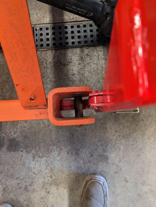

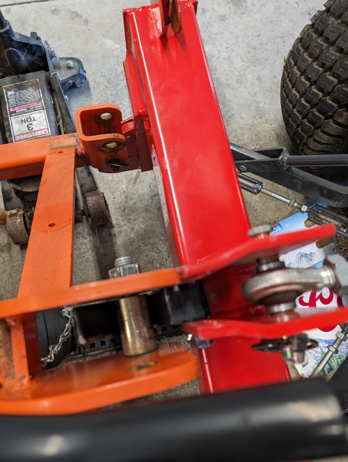

Except it didn't fit my "Quick Hitch" implements... See photos First shows the bottom hook is too thick on the back part... second one show the top link not even close to working. Yes.. it's a Quick Hitch Land Pride snow blower.
Use quick hitch, modify non conforming implements once, be happy forever.....

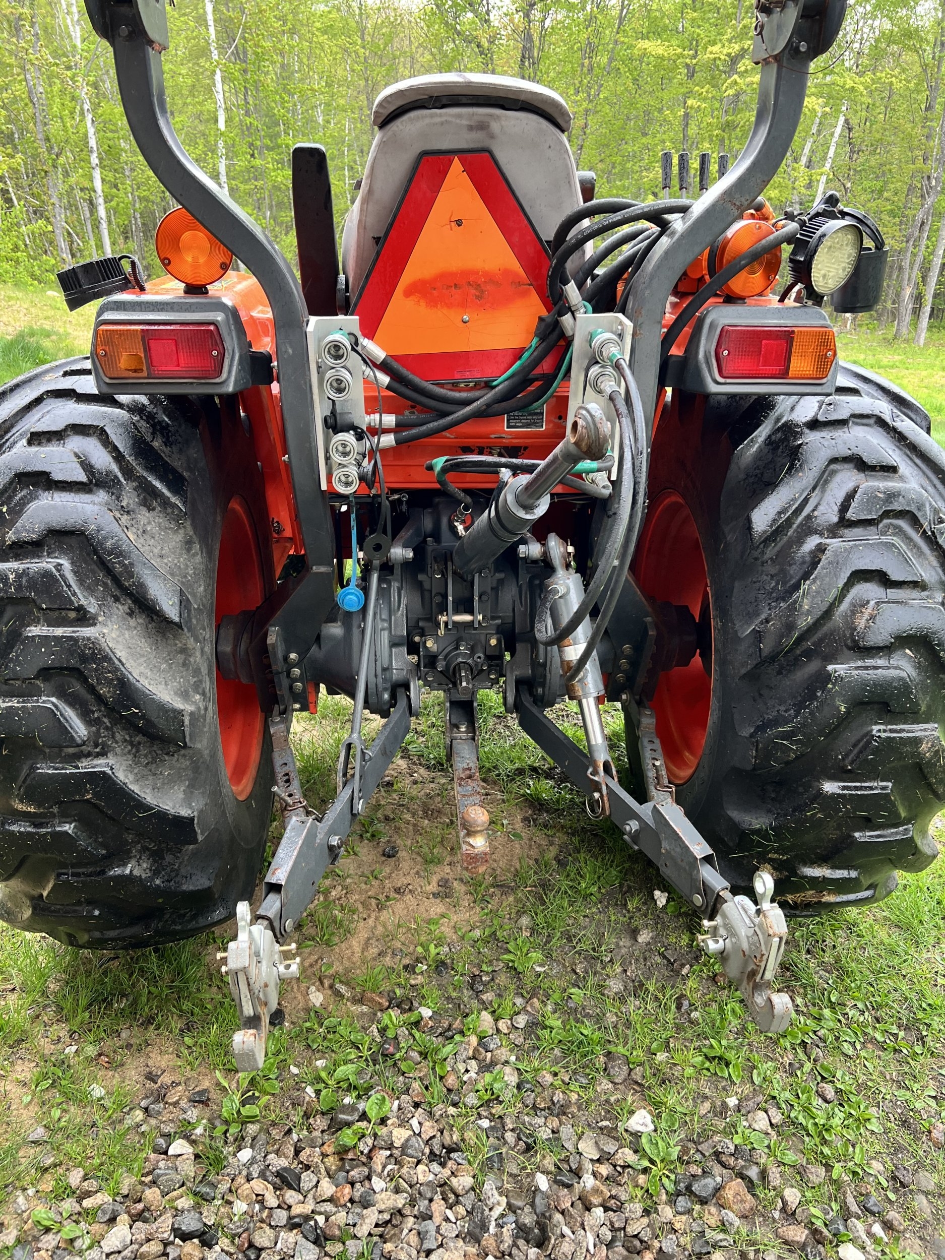

I have a couple of implements that don't fit the quick hitch I've been using for many years, but I've always just taken the quick hitch off in order to use those implements (log grapple, rotary cutter, and formerly box blade, I even bought a new box blade just because it was quick hitch compatible and I use it so often). However, I kept reading about Pat's, so I gave it a try. I bought the cat 1 hitch with the cat 2 size hooks because most all my implements are cat 2.
I found that it was more of a PIA to use the Pat's system than it was worth. I went back to using my old quick hitch and continue to take it off when needed. I will end up modifying my log grapple and rotary cutter so that they work wih the quick hitch like you mentioned.
So, buy a quick hitch to use with "quick hitch" labeled implements, but modify them? lol.. no thanks bro.
From what I have noticed,,,
different attachments are designed to be used with different Quick Hitch's
So, probably you need a JD Quick Hitch,, also a HF Quick Hitch, and at least one other manufacturers QH,,
THEN, you simply install the QH that matches THAT attachment,, (y)
after using that attachment, switch to the next QH to sync to the NEXT attachment,,
:ROFLMAO:
   / Pat's Quick Hitch and arms... slanting when lifting? #30
:ROFLMAO:
Not really.....Many implements of any particular "category" (1-2-3) were manufactured to a loose standard before a more exacting standard of the "quick hitch" evolved... The QH standard tagged implement(s) just means manufacturer is reconfigured the attachment it meet more exact standard....Sad side is many manufacturers choose to not adopt the new standard.....
