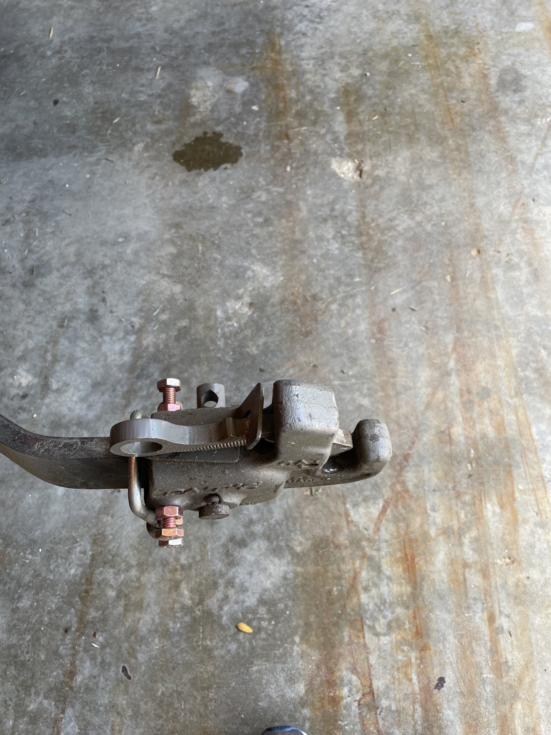

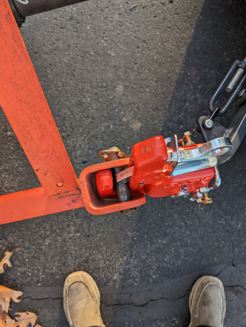

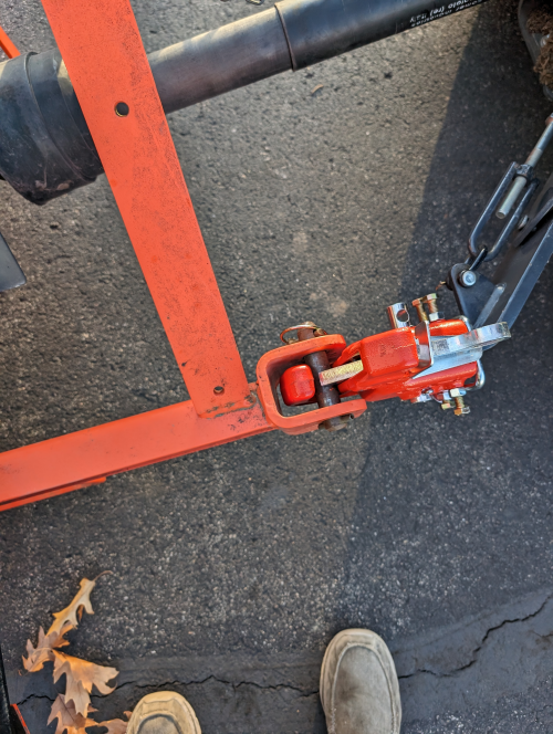

Hey all!
After a terrible experience with a "Quick Hitch" I returned it and got a Pats Quick Hitch.
Installation on my BX2860 went smoothly, but I have a question.
When lifting an implement the arms (and pat's hitch) angle inwards. I guess I never noticed if it did that with just the 3 point and no Pats. See pictures. First is resting, second is lifting:
Is that normal? Or is there something adjusted wrong?

Are the 4 stop bolts (2 on each side) adjusted correctly so they limit this movement?
/ Pat's Quick Hitch and arms... slanting when lifting? #3
Are all the bolts tight? Pats, should not have movement.
You should be able to use a broom stick across both Pat's hitches and have them raise up parallel.
/ Pat's Quick Hitch and arms... slanting when lifting? #4
Old and Tired nailed it. You can adjust the angle of Pat's relative to the ends of your arms. Note that as the spread of the arms changes so does the angle of attachment. The implement pins normally go through a rotating ball allowing proper alignment. The bolts on Pat's allow this alignment. If all your implements are nearly the same width no adjustment after initial setting is necessary. Note that the bolts included with Pat's are pretty soft. I replaced mine with set screws in case the end becomes distorted and they can no longer be backed out. Hardened bolts would be another good choice. Self locking nuts on the big U bolts are also a good idea.

I discovered the exact same thing the OP did. Just the geometry of the lift arms moving will make the ends tilt in. The swivel balls in the lift arms pivot to make up for this. If you bolt the Pats down tight it takes the swivel out. I’m not sure it hurt anything so I went to loosen up the Pats. I discovered the provided bolts had mushroomed out and were hard to remove.
I ended up having to retap the threads, bought some higher grade of bolts and put some nuts on to lock the bolts down. This let me leave the bolts loose so the Pats kind of flop around on the lift arms and allow some pivot.

It's not the pats that are angling... it's the whole 3pt arm. All install was done per the instructions.
I did find a video online and asked if the same thing happened with them and they said yes on their Kubota.
I just think it seems odd.. trying to find where the force is coming from that causes this.

Being that those small tractors are really a category 0/1 3pt that have wide splayed arms, I think it is the nature of the beast. You have arms that have quite a bend at the end which with the Pat's QC, hangs the weight to the side quite a bit. When the pat's are installed, the front bend of the lift arm no longer matches the rear bend.

I am of the belief that the tilt you are seeing in the Pat’s has nothing to do with the Pats it’s just the way the lift arms work. The swivel in the lift arm allows for it and you never notice until you put the Pat‘s on.
