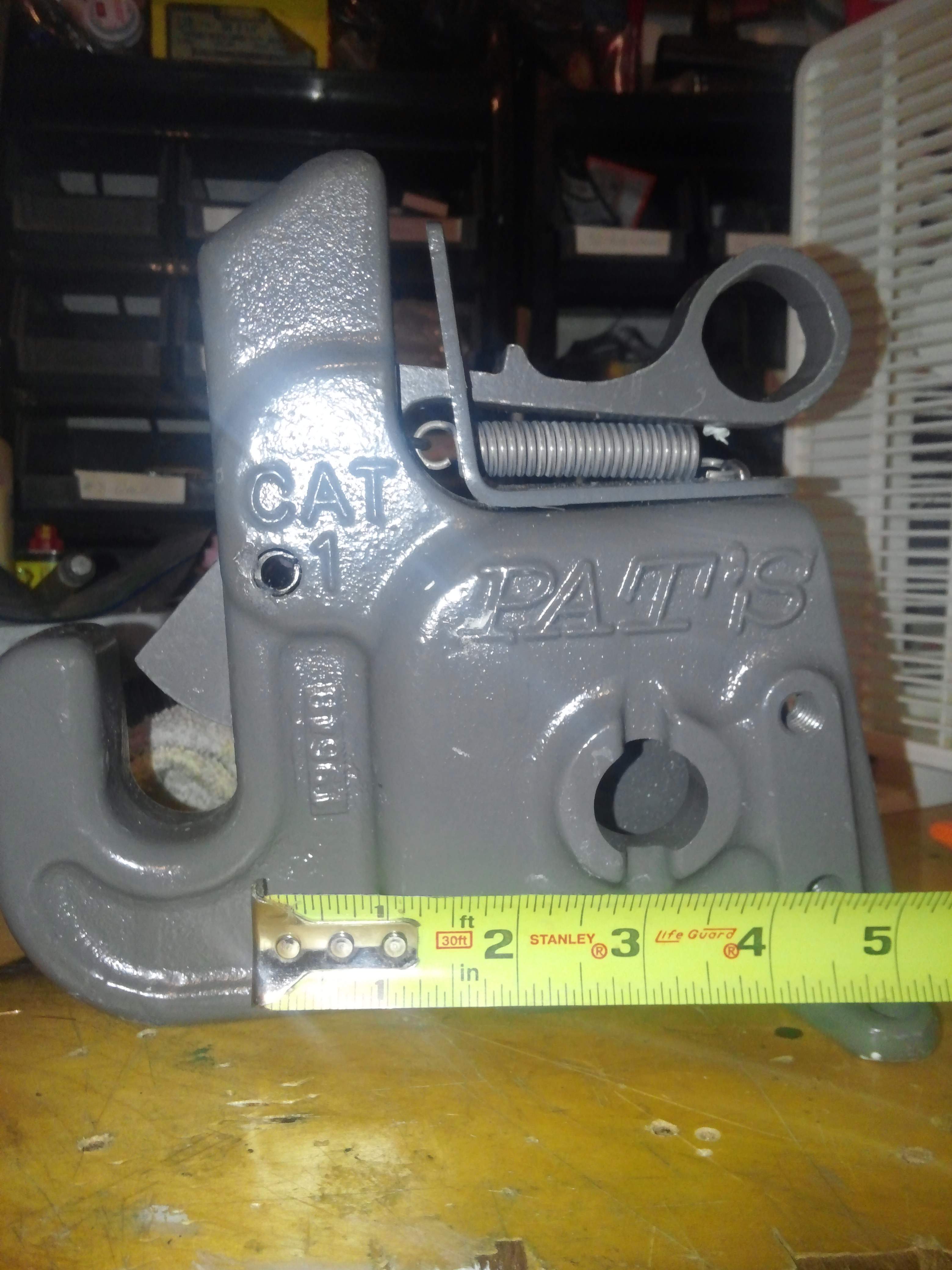

Does anyone know if the Pat's Easy Change for three points works if I have a Mahindra 4035 with the extending attachment on the lift arms?
   / Pat's Easy Change #3
And/or post this question in the Mahindra section so other owners of the same tractor can chime in.
   / Pat's Easy Change #4
Post a picture of your arms with measurement from end to the engaging opening on your arms.
I have a set of PATS in the basement for the 5500 next time I go to MS and I can measure them
   / Pat's Easy Change #5
Is your tractor Cat 1 or Cat II? I have a set of Cat 1 that I originally had on a Kubota L3400 and loved them. Transferred them to my LS but with the extra 4 inches they add to the lower arms, I couldn't tilt my box blade enough to feather gravel so I removed them. They are for sale if they would fit your machine.
   / Pat's Easy Change #6
Thanks Aaron, Bought a set week after I bought the 5500. gerytb may want them for his new tractor.
   / Pat's Easy Change #7
send me an email with price.
   / Pat's Easy Change #8
I measured my new PATS and they extend the lift arms 3.5". the bottom of it requires at least 2.5" clearance from the back of the ball socket to attach, hope this helps.
   / Pat's Easy Change #9
I think his issue would be the shape of the ball end of his 3pt arm. Some extendable arms have cast ends that might not fit into the socket of the Pat's.
