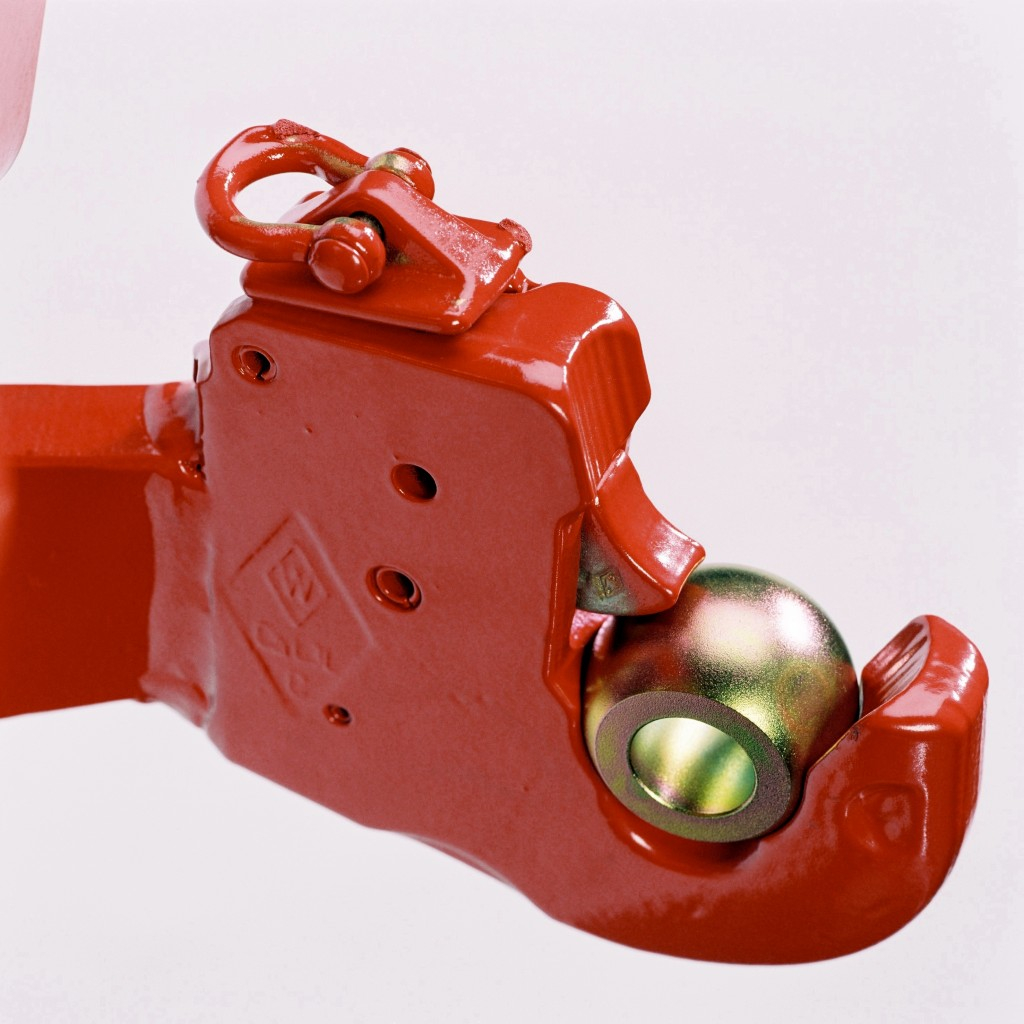

I took a close look at these and passed. I could not see them lasting as I back into my 1300 lb concrete counterweight and then carrying it around.
If you're looking for something that can take some abuse and will most likely outlast the tractor, check the Euro style lower links.
These just work right. Sure, takes a bit more work for the first time as it requires cutting the old ends of the arms and weld the hooks on, but it doesn't extend the arms any further, retains the ball joint and it's very easy to connect. The PATS just restrains all of these movements and then you see people complaining about broken bolts. As far as price, I've seen the kit for $300 or individual parts for a lot less.
Don't know about shipping to Canada but AgristoreUSA sells those and so does @MtnViewRanch from Fit Rite Hydraulics. He is a member here.
