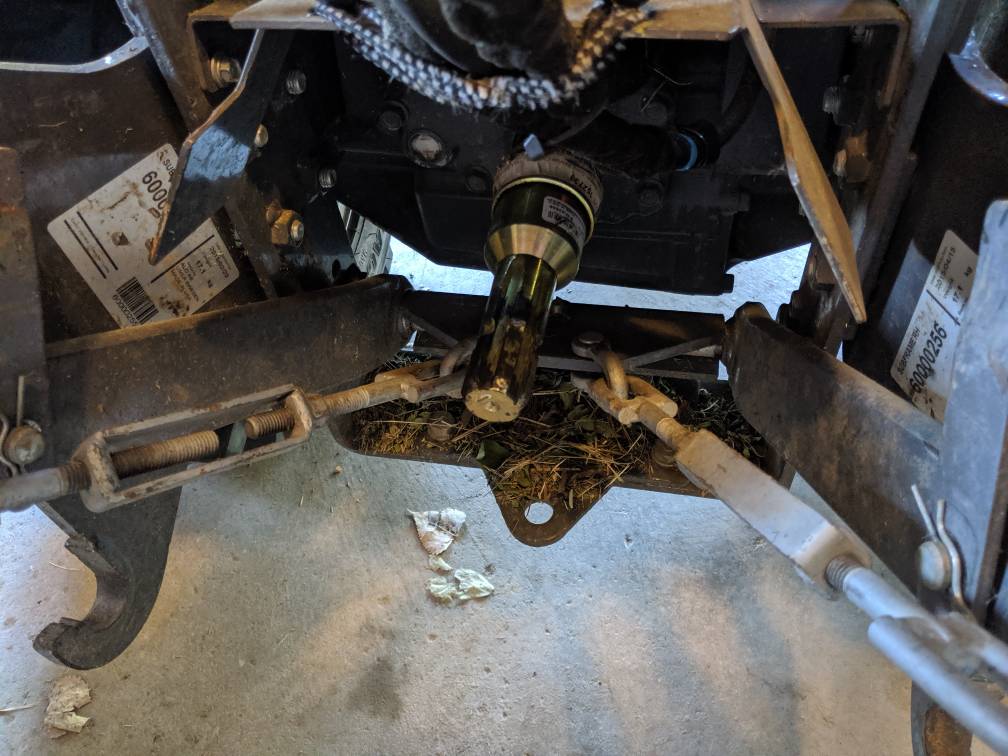

I am considering Pat's easy change. Anyone using it on a GC1700 (GC1720 with CB65 to be exact)? I want a easy system, but I am worried about clearance when the backhoe is on. Having to uninstall it would defeat the purpose since it seems like an involved process (shims, u-bolts) installing it. What are your thoughts? Do you recommend something else for me? As always, I appreciate your input. Thanks in advance!

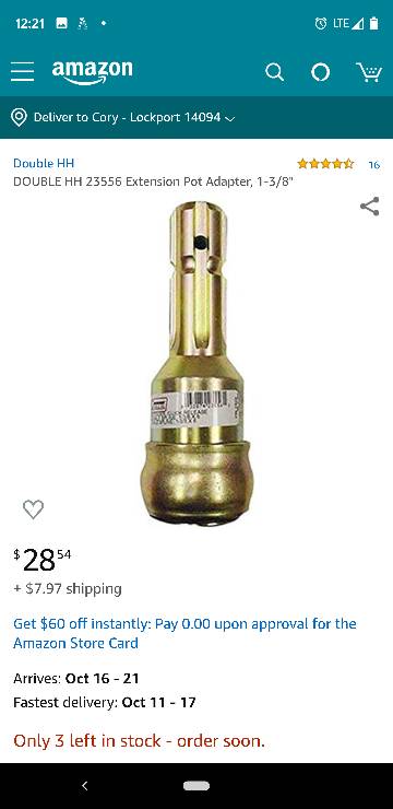

Dang it now I gotta replace my PTO shaft on the tiller as it had been cut. It’s about 2 inches short now.. oh well still loving my Pats.
Don't need a new shaft, just one of these which will add some length for you. Screenshot_20191009-122112.jpg

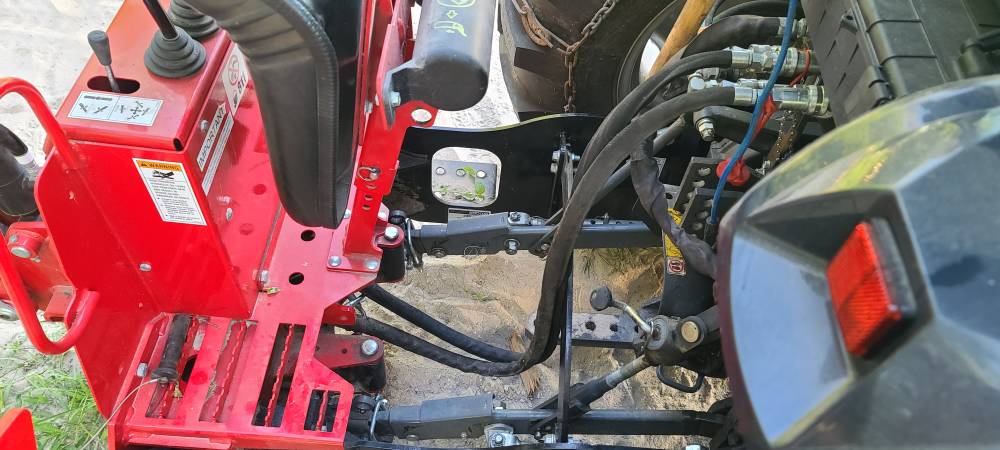

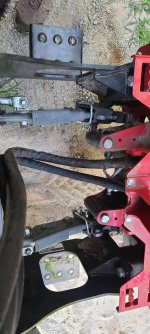

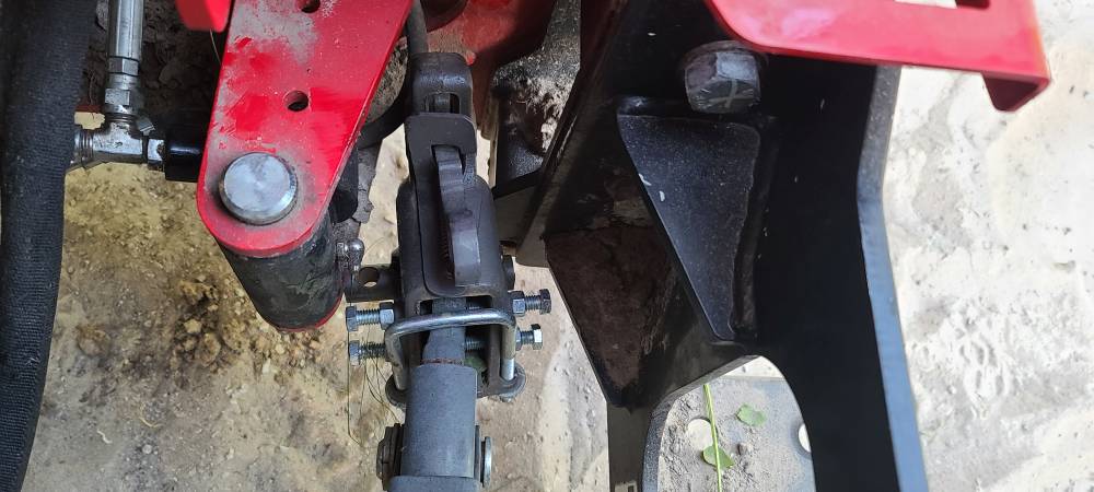

Well I got it on! It was close, I had to adjust the 3point lift links to drop it all the way to the ground to get the BH installed, and then carefully lift them just to the point of conact to the frame and then lock the pto lever locks as not to have it under load trying to lift it, or make it drop on the ground. The pto arms sit just a little lower than they would without the Pats on it but it works and didnt have to remove them, that's all that matters in the end.

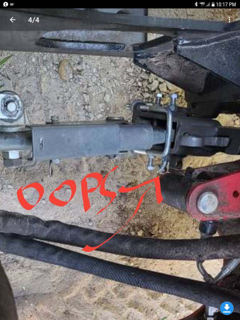

You can see here where I had a little oops lifting the 3 point arms back up after installing the BH, the arm flipped when it should have flopped, haha.
