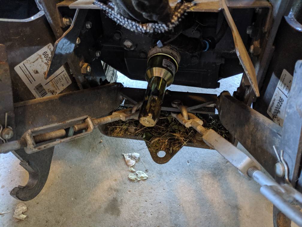

Your machine is so clean....

@MoMower, pictures were before I put it to work. Tires were covered in mud afterwards. Did loader work on it.
@CUtiger95, it adds about 3” so you lose about 5%-7% lifting power. For me, I don’t plan to use any implements near my capacity so it’s an easy decision. The backhoe will stay on more often than not.

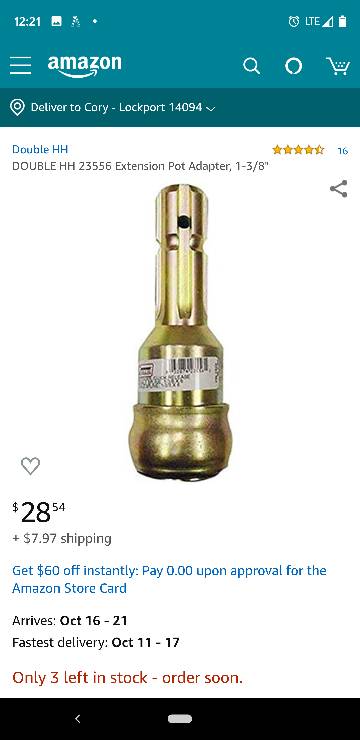

Dang it now I gotta replace my PTO shaft on the tiller as it had been cut. It’s about 2 inches short now.. oh well still loving my Pats.
