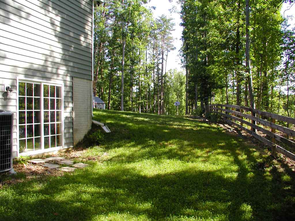

Before I started...

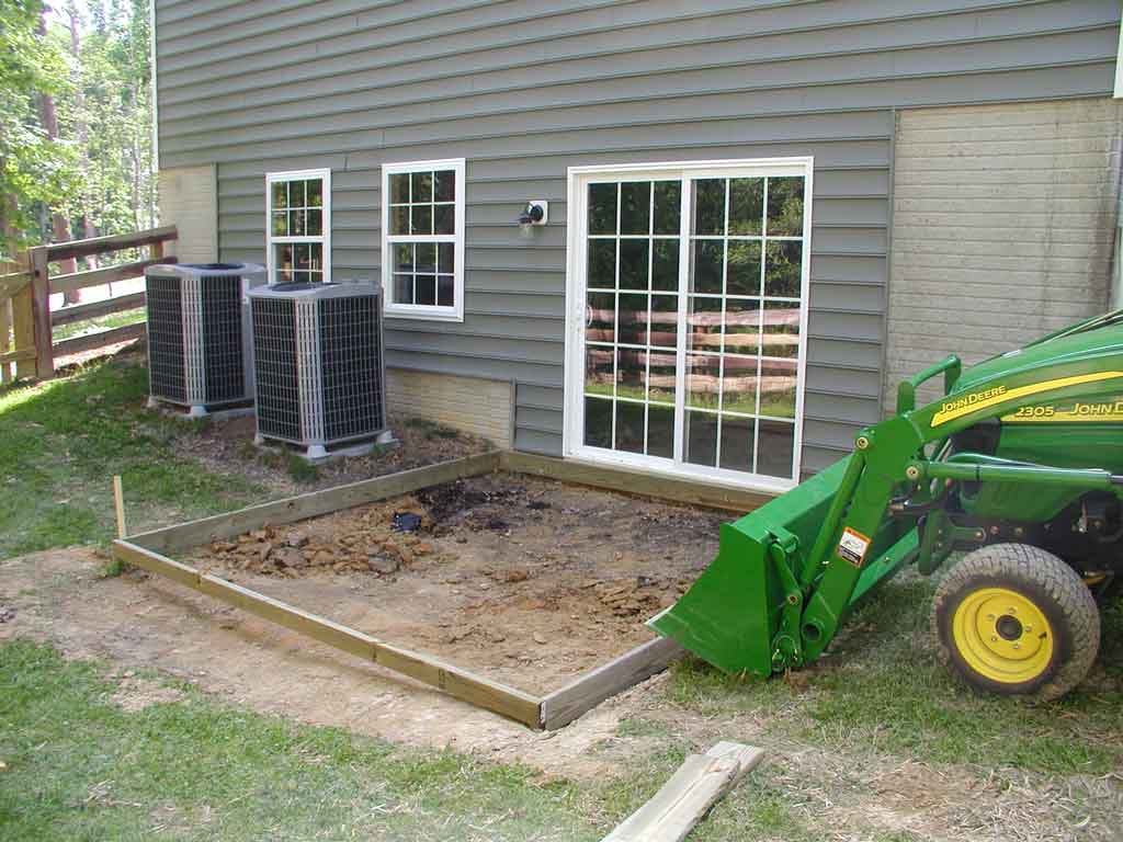

Getting the area leveled and framed so I knew where to put the posts; given the tight area and slopes, most of the leveling was done by hand rather than the loader :(

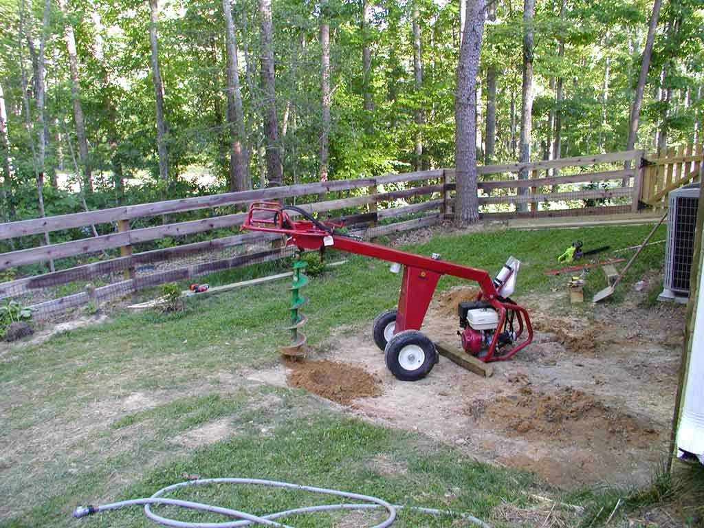

How I dug the post holes - probably a waste of money considering the effort I put into moving this thing around and the time it took to clean up the holes...

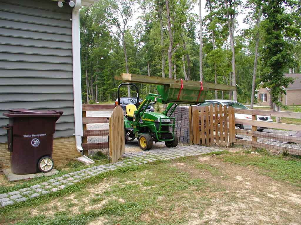

6x6x12' posts, glad I had the loader... Each post is 18-20" deep with 160# of concrete.

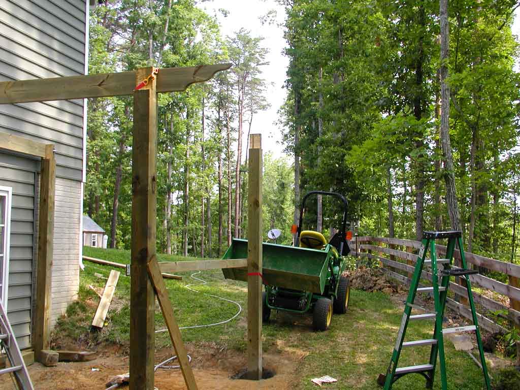

Getting the posts up by myself took some ingenuity. The loader acted as a brace while I leveled and squared them.

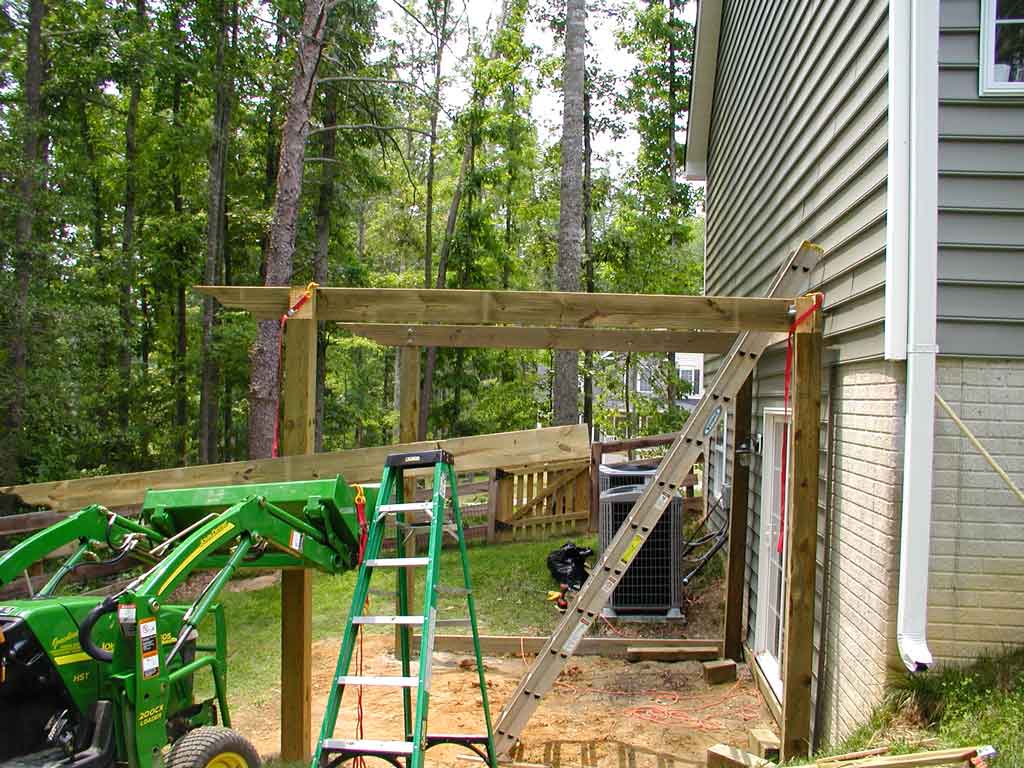

Some ladders, the loader, and straps held the beams in place until I could get holes drilled for the 1/2" carraige bolts. I balanced them on the loader, then climbed the ladder and pulled the beams into place to strap them onto the posts.

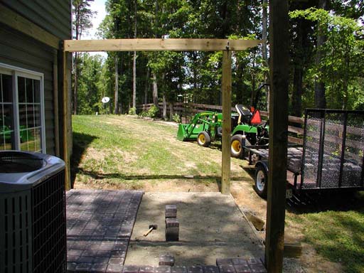

6" of crushed stone base later and it's ready for the 6x6" brick pavers.

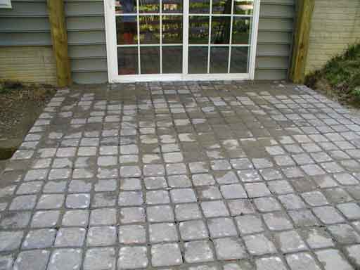

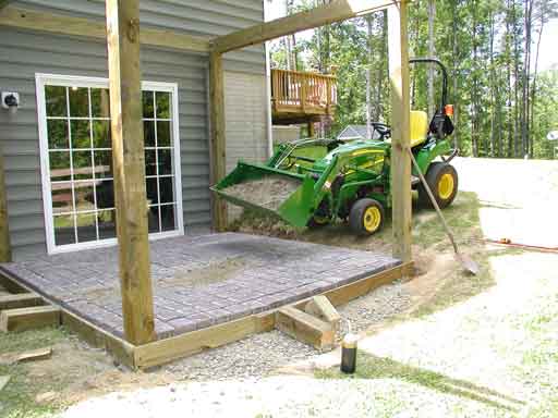

Got some more work done yesterday... Don't think I'll do much today, my vacation is over and I've worked harder than I would have at work! Think I'll rest a little. Or get some other stuff done... Anyway, I got the patio in now...
Laying bricks - two trailer loads of 6"x6"x2" brick pavers (~5# each). Without the 2305, I would have needed about 40 trips with my 18hp Craftsman and dump cart!

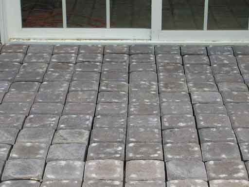

Closeup of what it looks like - its not very level or evenly spaced, but so what? Adds to the charm... (Or so I tell myself!)
Adding some leftover crusher run to lock the bricks in place. Side bonus - the stones make a nice bed for drain tile on the outer edges of the base framing.
Another closeup after filling and hosing it down to help settle the dirt. There's a low spot on the right side that I'll have to repair, about 8 bricks need to be raised a little.

If you decide to put down some pavers again, sand will give you a good level base on top of the rock. Just put down two 3/4 inch PVC pipes and scree off the sand to the height of the pipes. Remove the pipes and fill with sand.
Of course, on a small pad, it's not that noticable. Thanks for the updates, it's coming right along and looking good.

I thought about using sand to lock the bricks but the extra base was easier than running back to the store. I never thought about screeding sand to keep it all level! I did run a 10' 2x4 over the base like a screed, but it was too long to pull from one side and too short to work it back and forth. I didn't bother to attach eyes and rope to pull from the middle... Maybe I was just tired of working on it and needed a break so I took shortcuts? The lessons we know and keep having to relearn!:eek:

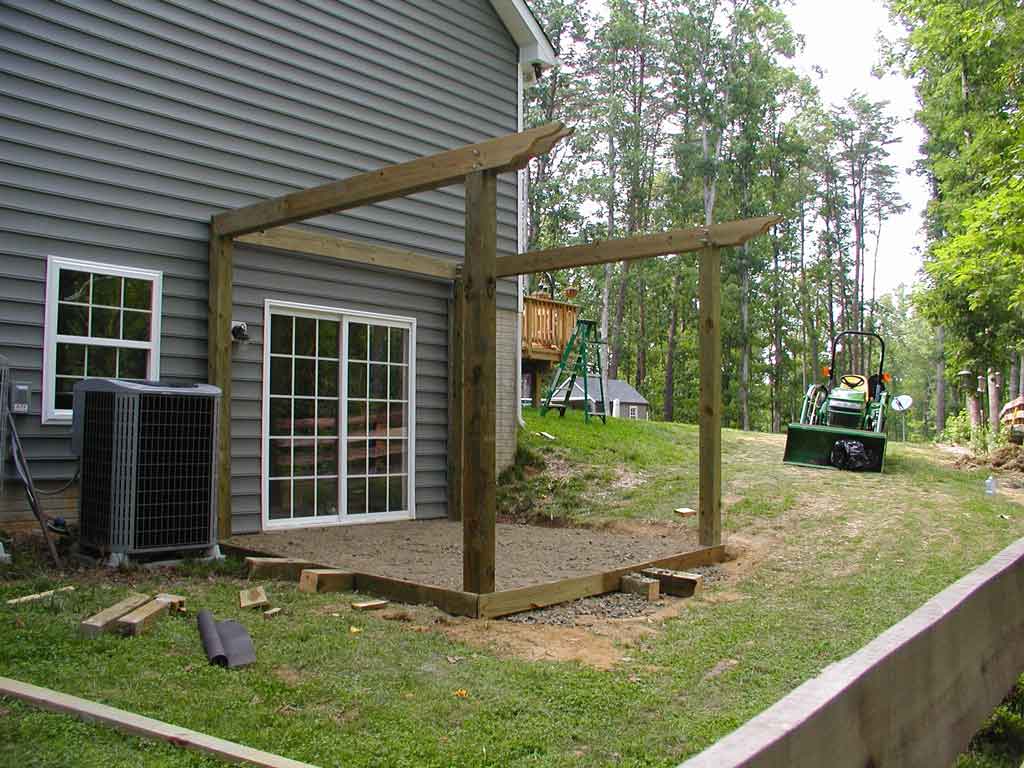

I had planned on getting the drain tile in and covered with dirt this weekend, but decided to get on with the pergola instead. I used seven 2x6x12' to go across the 4 joists, and have five 2x4's to put over the 2x6's. I got the 2x6's shaped this morning, then cut some grass while waiting for the mid-morning sun to leave the pergola area. This let me get the 2x6's notched and placed on the joists. I'll come in next weekend with a framing nailer to permanentize (new word) them. Here's some photo's...
The little 2305 ready for work
Loaded up, secured, and ready for transport - 7 2x6x12'; 5 2x4x12'; and 150# of sand below the lumber in the bucket
Craziness - getting the first board up for marking. Too much work, I need to be smarter and safer!
Notched... I used a circular saw to cut into the board on both sides then chiseled it out
One down, 6 to go...
Finshed up
Another shot
It was too hot to do anything else, so I'll resume next weekend with the framer and 2x4's. Maybe then I'll get to the drain tile? BTW, the other boards were much easier to get in place by putting one end on a joist and climbing the step ladder with the other end. I spaced them at 20" and fit the seven pretty well.

Wow, that looks fantastic! How did you end up fastening the perlins? That's a tricky one. Maybe a long screw, like a Timber-Lock, from the top? (predrilling a must!) I bet pocket-screws from below would work too.
/ Patio and pergola installation
#17
Thanks... I haven't fastened them, yet. I was going to get up there with a framing nailer but have since reconsidered and pretty much decided on the screws from top. I'll need to get something to fill in the holes, though.
/ Patio and pergola installation #18
Nah, you don't need to fill the holes. Just go to a good lumber yard and look at thier ss screws. You should be able to find some 5 inchers with a washer-head, drive 'em flush and your done. Just don't ask how much they cost.

I use Simpson hurricane brackets for that job. Makes it easy. Some folks don't like the look of these brackets. But I figure that the bolts holding the main frame of the pergola are in plain sight, so why not these brackets.
