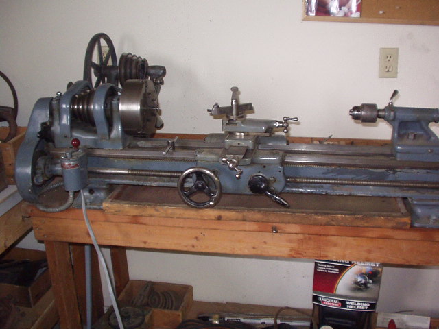

Thats quite a story, like you say there ain't nothing wrong with any of that old iron. I have a 9" southbend lathe I bought used in 1962 for $25 and still have it. I was in High school at the time and the metal shop was replacing it because it was obselete way back then, well it still runs tight and has saved my a... more than a few times. No quick change gears of course, gotta manually select feed gears, but who needs to cut threads anyway. It would be an OSHA nightmare by todays standards, but its a keeper!

syncro, thats a nice lathe you got there, looks about the same size as my logan lathe i bought, i paid 500 for it a few years ago, it was from a guy who used it as a woodlathe to turn bowls and stuff like that, so the ways had virtualy no wear, he had owned it since it was new and had just had a toolrest on it to use with his chisels, it was in mint condition when i got it but unfourtanatly it has gotten some surface rust since our garage can be a bit humid at times of year, but it works great, i am still keeping an eye out tho for a heavy duty old lathe to use for big turning jobs
