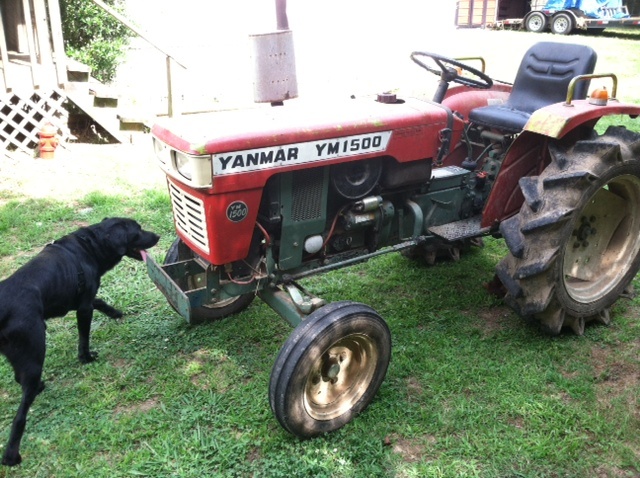

here is a picture of it...

That side air filter is also a sign of a green one.
Not sure that applies to the 1500 model. I have a red one with the same side filter. Also it's the only one Hoye shows. Are you referring to the green side panel?
/ parts question for the 1500 #10
no was referring to the air filter on the side the round thing. You may be right though?
/ parts question for the 1500 #12
i must be thinking of ym2000 like i have. Mine it top filter though.
/ parts question for the 1500 #13
That's cool. It's the little details that make it easier for new owners or possible owners to figure out what they are looking at.
I don't know if this has been discussed before but it does appear the screens on either side of the engine are different between the green and red ones. Mine follows the hood line and goes all the way to the air filter.
/ parts question for the 1500 #14
Evidently there is a difference in the side screens. The side screens on my red YM1500 are as damammel describes and they are Yanmar white.
